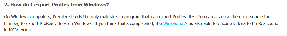

    Speaking of ProRes, where can the encoder be downloaded from or is it propriety to Apple programs?
  17. Originally Posted by Alwyn View Post
    You can try your luck here (I didn't):
    https://www.winxdvd.com/video-transcoder/prores-codec-for-windows.htm
    From there:
    [Attachment 80960 - Click to enlarge]
    or in ffmpeg:
    https://ffmpeg.org/ffmpeg-codecs.html#ProRes
    NLEs based on ffmpeg usually include these codecs

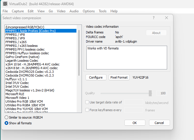

    I have one, but I don't remember where from.
    https://imgur.com/KPw4iFr
    However, I suspect that this is a plugin for VD.
    May 2005
    Australia-PAL Land
    It comes with VDub2, but it doesn't work properly. All I get is a corrupted video.
    Aug 2018
    Wrocław
    I've used it a few times, (yesterday, today), it works flawlessly.
    Do you know that there are new libraries for VD v.44282?
  21. Originally Posted by rgr View Post
    Works nicely here as well.

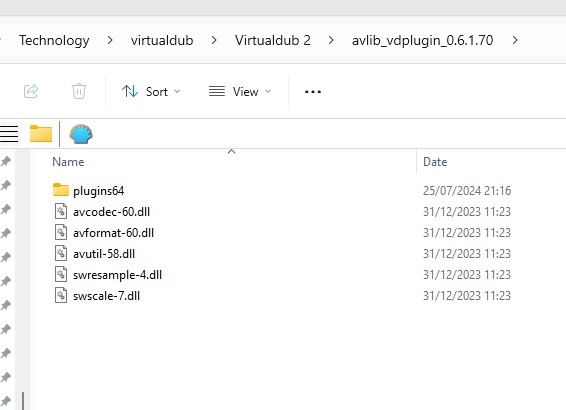

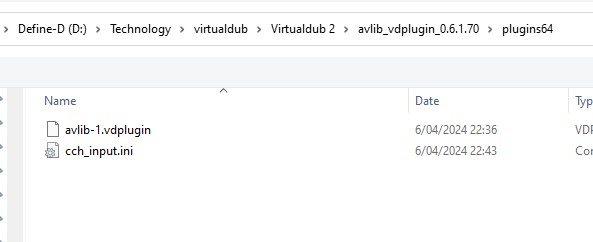

    That went well... not. All the FFMPEG entries disappeared (including the ProRes)) and now there's no ProRes at all. And what's with all the DLLs?
    Pity the people that put this stuff together don't make a quick Readme about what to do with the files in the package.

    Originally Posted by Sharc
    ??? There is a avlib-1_readme.md in the plugins64 folder of the package
    [Attachment 80963 - Click to enlarge]
    [Attachment 80964 - Click to enlarge]
    WHERE?

  28. @Alwyn: Your package seems not to be the latest version (if this should matter).
    Download the avlib_vdplugin_0.7.093.7z only, keeping your current working Vdub2 as is. Unzip the .7z, and in the plugins64 folder there is the readme.md with the instructions:
    # Usage
    Copy 'avlib-1.vdplugin' to 'VirtualDub2\plugins64' folder.
    Copy FFMpeg DLLs to 'VirtualDub2' folder.
    * avcodec-61.dll
    * avformat-61.dll
    * avutil-59.dll
    * swresample-5.dll
    * swscale-8.dll
    FFMpeg 7.0.1 binaries used: https://www.gyan.dev/ffmpeg/builds/packages/ffmpeg-7.0.1-full_build-shared.7z
