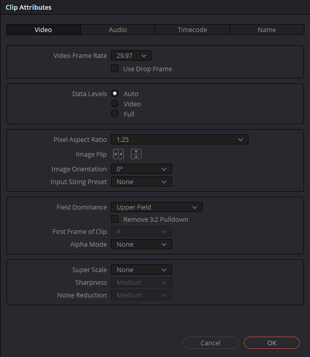

  6. Originally Posted by Alwyn View Post
    Nope, definitely Interlaced, Top Field First. You can verify this by opening it in MediaInfo. Go to the Text view and look in the video section of the report. I double-checked it in Virtual Dub.
    If you tell Davinci that the video is Interlaced TFF, you should get a good render.
    These are the settings I use for the clip when deinterlacing and I still get the same jumpy after product.

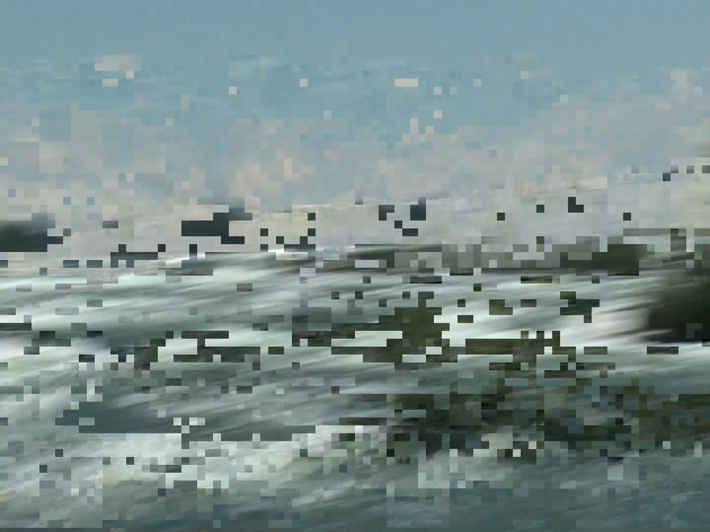

  8. @Alwyn
    Frame 360....363, 390...392, 450...451, 480...483, 570...573, 631...633 of your Magix deint.
    It's not in the source IMO.
