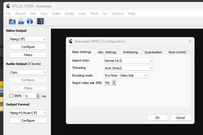

    @Spapakons, AVIDemux has a "set video size" option:
    [Attachment 80876 - Click to enlarge]
    Hybrid, another (more complicated) GUI, also has the "set video size" option.
    I will try downsizing a 720p movie to 576p and set the target size to 4480MB. I am curious if it works. If it produces an MPEG file as close to 4480MB as possible, I will admit that this is a good solution and FFMPEG is not that bad at MPEG2 encoding, if you set the correct parameters. If the size is nowhere near 4480MB, I will post it here to let you know.
    Thanks in advance.
  22. Member
    Oct 2017
    Athens - Greece
    Well I tried to encode in MPEG 2 with fixed size at 4480MB in Avidemux (FFMPEG encoder) and it completely ignored my settings. 2210Kbit/sec bitrate is ridiculously low for MPEG 2. The image quality is crap. At least 3500-4000Kbit/sec is needed to avoid artifacts, let alone be DVD compliant. See MediaInfo data here:

    It is not Avidemux, any GUI I have tried and even command prompt completely ignores my settings with either specific average bitrate or specific file size in MPEG 2 encoding. Only CBR worked by setting minimum, average and maximum bitrates to the same value. This is not very helpful. Thankfully other applications such as AVStoDVD don't rely solely on FFMPEG for MPEG 2 encoding but also support the much more reliable and accurate HC Encoder which ALWAYS respects the set bitrate and the file size becomes as calculated. So not more experiments with FFMPEG for MPEG 2, it's complete useless for this format.
