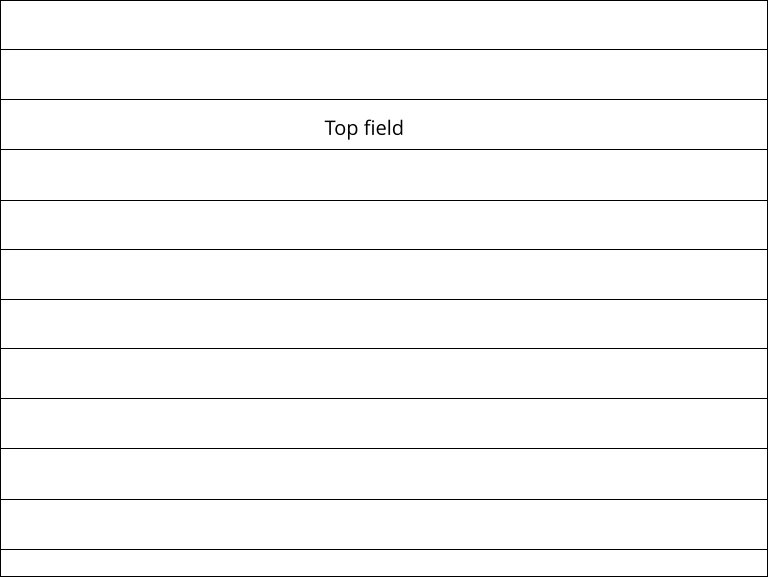

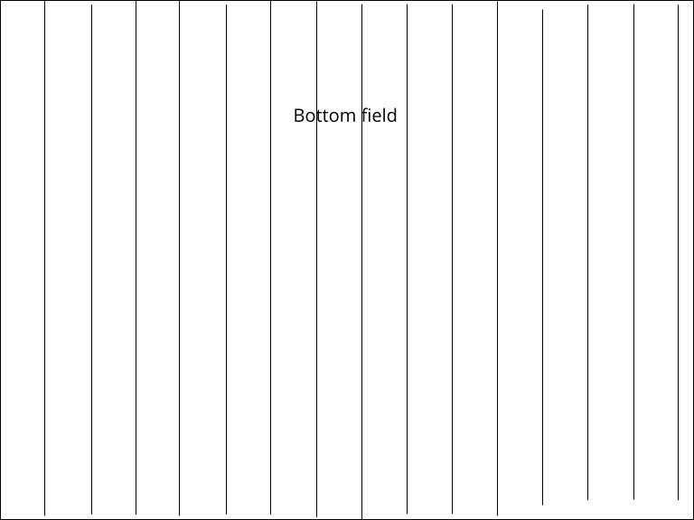

    Hello all, I'd like to do some trials to improve my understanding of fields and how they are converted during the various deinterlacing processes.
    To do this, I thought that a interlaced file, with markedly different fields, for example, one field has horizontal lines and the other field has vertical lines, would allow me to see how each field is processed.
    The problem is, I have no idea about how to create such a interlaced file. I have made up two images, attached, which could be used to create the file.
    I would be grateful if any of the video coding experts could create say a 30 second interlaced file using the two images. I'd prefer having the "top field" image first if possible as that will match the normal analogue interlacing convention.
    Thanks for any help here.

  2. I don't think this is going to help you much. Made with AviSynth:
    BlankClip(width=720, height=31, color=$ffffff, length=30*25).AddBorders(0,0,0,1)
    top = StackVertical(last, last, last, last, last, last, last, last, last)
    BlankClip(width=35, height=288, color=$ffffff, length=30*25).AddBorders(0,0,1,0)
    StackHorizontal(last, last, last, last, last)
    bot = StackHorizontal(last, last, last, last)
    Interleave(top, bot)
    AssumeTFF()
    AssumeFieldBased()
    Weave()
    AssumeFPS(25)
    ConvertToYV12(interlaced=true)
    MPEG 2 elementary stream, encoded with HCGui.
    Last edited by jagabo; 19th Jul 2024 at 23:12. Reason: removed mpg file, added m2v file

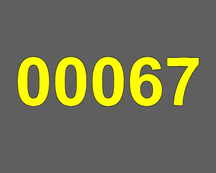

  3. Something like this might be more helpful:
    BlankClip(width=720, height=576, color=$606060, length=60*25)
    ShowFrameNumber(x=50, y=350, size=250)
    AssumeTFF()
    SeparateFields()
    SelectEvery(4,0,3)
    Weave()
    AssumeFPS(25)
    May 2005
    Australia-PAL Land
    Fantastic, Jagabo, thank you very much (again). The numbers file, especially, is brilliant.

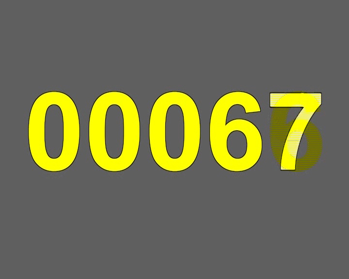

    I am pretty surprised by the bad job VDub Yadif x 2 did:
    [Attachment 80830 - Click to enlarge]
    QTGMC, on the other hand, was pretty clean:
    [Attachment 80832 - Click to enlarge]
  6. Not really surprised, taking into account that:

  12. Originally Posted by Alwyn View Post
    VirtualDub doesn't work properly with interlaced 4:2:0 subsampled chroma. Hence the ghosting and horizontal stripes in the chroma.
