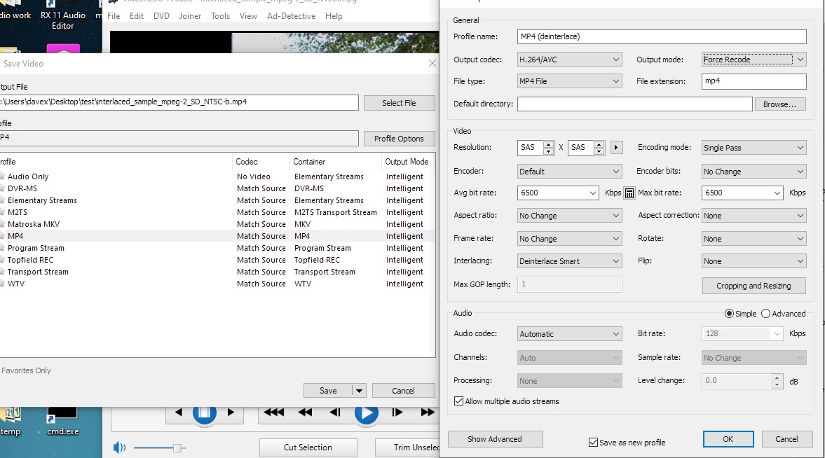

    Best to convert to mp4/h.264 and set deinterlace to smart

  6. That's exactly what I did. I tried Auto/BOB/Weave/Smart, but MediaInfo showed them all as interlaced.
    It was only when I saved them as mpeg4 first, they saved as progressive. I was then able to open this file and save as mp4 h.264, and this worked correctly.
    Mar 2008
    Maybe it's something peculiar to your source type (which you haven't described).
    It worked for me with a typical 720x480 mpeg-2 file converted to mp4 with forced encode
    ("output mode", top right) to h.264
  8. Bingo! I was not selecting Forced Encode. I didn't actually consider that, but I did wrongly assume because I was choosing the particular format/codec in the output profile, that it would be re-encoding to the criteria of that output profile regardless.
    I had wondered why my h.264 output profiles in VideoRedo had worked fine in the past (for videos to be playable on phones), but it was most probably because the source was different enough that VideoRedo was re-encoding anyway I guess?
    Thanks Dave!
