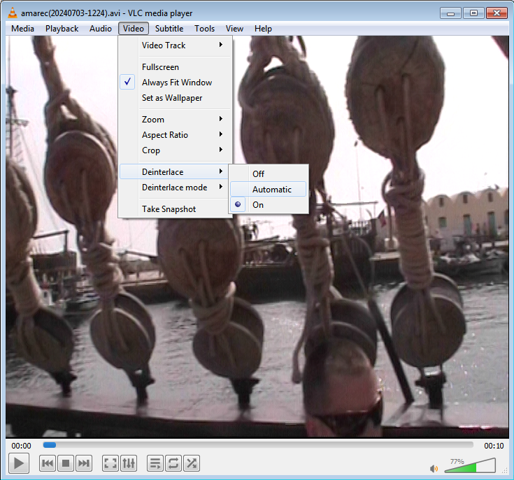

    "shaking", you mean not properly de-interlaced when played?
    Possible using another/better player can solve the problem too so you can keep the original video quality?
    Good mediaplayers should de-interlace automatically with correctly encoded video files.
    But you can force it too.
    [Attachment 80402 - Click to enlarge]
