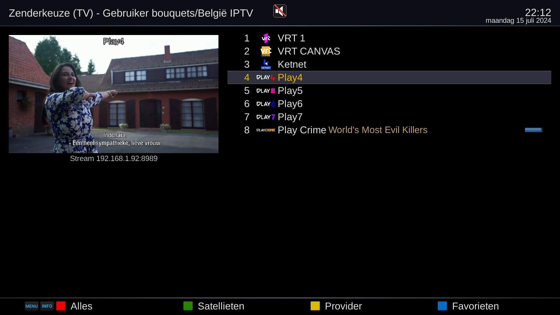

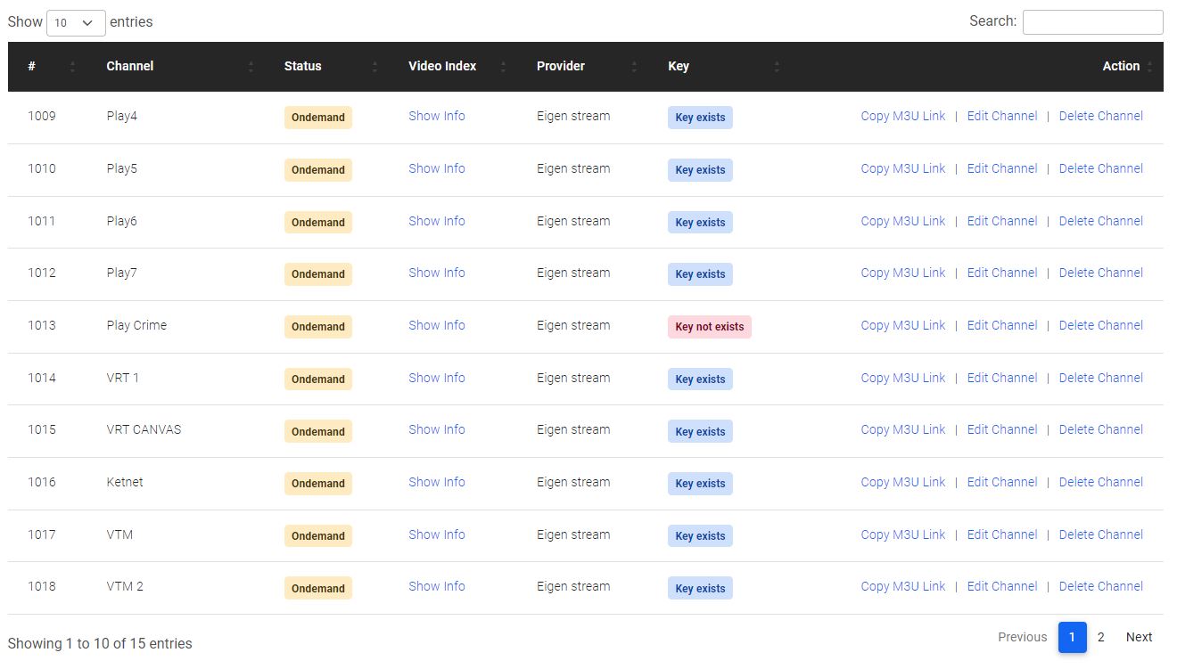

    Yes the MPD's for the livestreams work just fine in my browser, but I want to watch the streams on my TV.
    The script "Share2box" runs on a Raspberry Pi as a server for my sat-receiver.
    What goes in the script: the MPD-url like:
    and the KID:KEY
    What comes out:
    A DRM-free MPEG-TS stream like:
    which can be played on my TV (by means of my Enigma2 sat-receiver).
    Now the good thing: it works, the live channels of VRT MAX and GoPlay can be watched on my TV.
    The bad thing: all live channels of VTM Go can be watched on my TV too, but they have a delay of 2 hours compared with the stream in the browser.

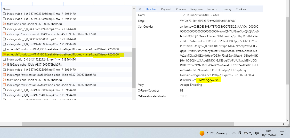

  9. I found something about that 2 hour time interval in a cookie but I don't know how to handle this.
    I was thinking about an extra parameter in the MPD-url but I don't know if something like that will work.
    /index.mpd?aws.sessionId=xxxx&extra_parameter=yyyy
    [Attachment 80754 - Click to enlarge]

  11. Originally Posted by Karoolus View Post
    Very strange, is it a case of "watch from the start" ?
    Yes indeed, it is possible now on the VTM GO website to go back to the beginning of the current live program (max. 2 hours).
    The VTM GO webplayer knows how to handle this, but other players consider the beginning of the stream as "live" while in fact it's the live moment of 2 hours ago.
