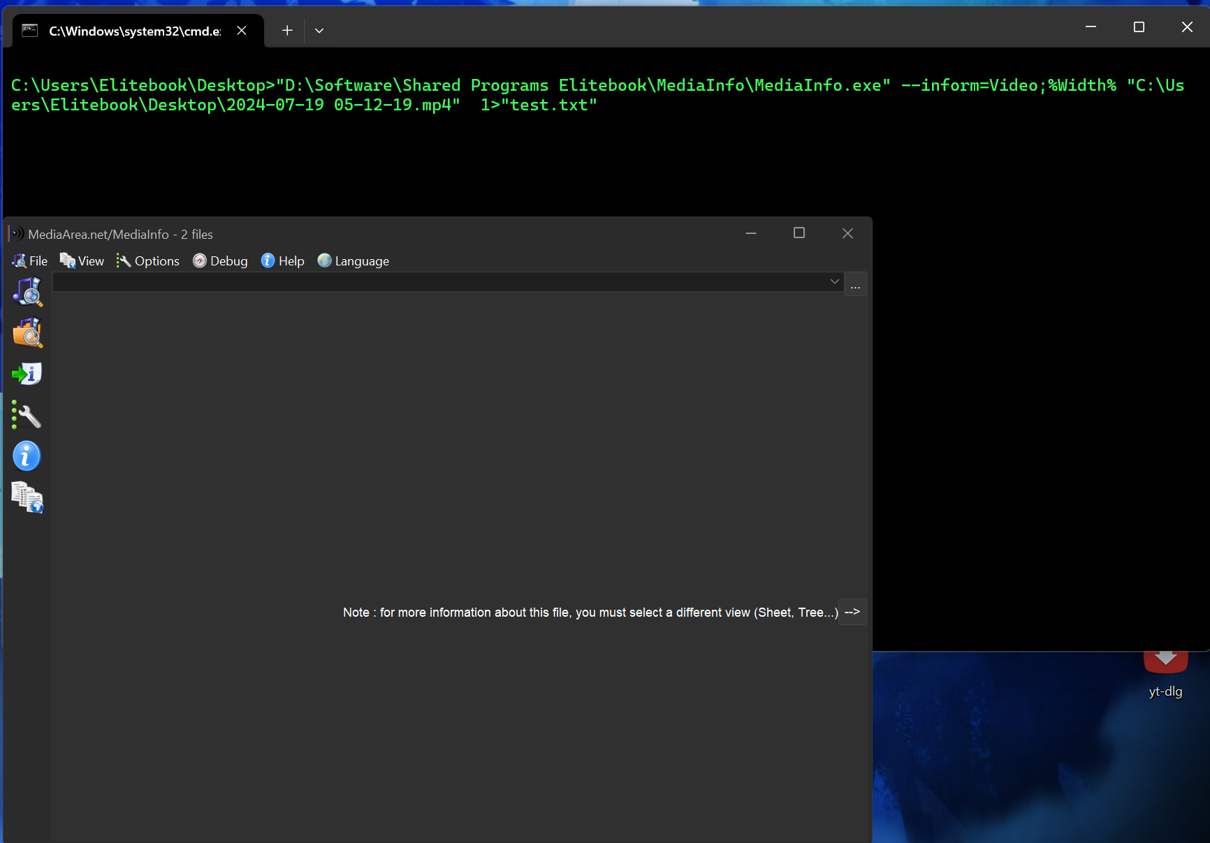

  18. Thanks a lot jagabo,
    I can't wait to test this script. But unfortunately there is something wrong (I guess with mediainfo part) of the script.
    When I drop the video file on the script mediainfo opens and stays open like this:
    [Attachment 80852 - Click to enlarge]
    If I close it, it will do the same again and it will open mediainfo for a second time and remain open the same way. After I close the second one the script will end with error:
    C:\Users\Elitebook\Desktop>set /p height= 0<"test.txt"
    C:\Users\Elitebook\Desktop>del "test.txt"
    C:\Users\Elitebook\Desktop>set /a hwidth=/2
    Missing operand.

    C:\Users\Elitebook\Desktop>"D:\Software\Shared Programs Elitebook\!proxy generator\nvencc\NVEncC64.exe" -i "C:\Users\Elitebook\Desktop\2024-07-19 05-12-19.mp4" -o "C:\Users\Elitebook\Desktop\2024-07-19 05-12-19.proxy.mp4" --crop 0,0,,0 --output-res x -c h264 --preset quality --cqp 23:25:28 --aq-strength 10 --ref 1 --bframes 0 --gop-len 15 --lookahead 15 --qp-max 30 --aq --cabac --mv-precision q-pel --avsync cfr
    Error: Invalid value "0,0,,0" for "--crop"
    it seems that txt files generated by mediainfo are empty!?
  19. You need to use the CLI version of MediaInfo, not the GUI version. I don't remember if comes from a separate download or an option with the GUI version.
  20. Originally Posted by jagabo View Post
    Yes, the CLI version has a separate download
    https://mediaarea.net/en/MediaInfo/Download/Windows
  21. Alternatively you could use ffprobe to get those properties (as in post #15).
  22. This is a very smart solution! It's now working and yes, the problem as you said was that I only had the GUI version of MediaInfo. The CLI is a different download and I got it from this link: https://mediaarea.net/download/binary/mediainfo/24.06/MediaInfo_CLI_24.06_Windows_x64.zip
