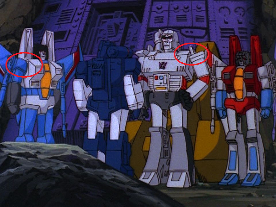

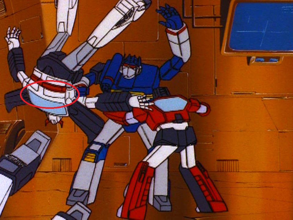

    Yes, I would like to improve the video quality and fix other issues that the episodes should not contain.
  22. Originally Posted by SaurusX View Post
    Of course, Rhino has the sporadic problem of interlaced chroma going over into adjacent frames.
    S02E20 frame 276 (Rhino):
    [Attachment 81888 - Click to enlarge]
    Do you mean something like this?
    In the Rhino release, starting from episode 9, progressive frames with soft pulldown begin to appear. Even for progressive frames, TFM can incorrectly detect combed frames, although setting the mode to 4 fixes that issue. If I'm not mistaken, when the progressive scan changes to an interlaced scan, chroma blending occurs (e.g., S02E20 frame 276). The same frame in the Shout release doesn’t have this problem, probably because all the frames are interlaced.
    The same frame from the Shout! Factory release:
    [Attachment 81889 - Click to enlarge]
    The Shout! Factory release seems better for some interlaced segments, while Rhino appears to be better for progressive segments because it avoids issues with incorrect field matching. I would like to determine at which frame numer the switch from progressive to interlaced occurs. Is there a way to identify which frame is progressive and which is interlaced?

    Correct. Rhino's encoding method seems to have introduced this effect, though it can be undone. See the doom9 thread here.
    DGIndex identifies frames marked as progressive or interlaced as it indexes the video. TFM then uses the "flag" parameter to determine whether field matching and comb detection should be done. "Flag" is already set to "4" by default, which sounds like it should be ideal, but leaves us exactly where we already are.
