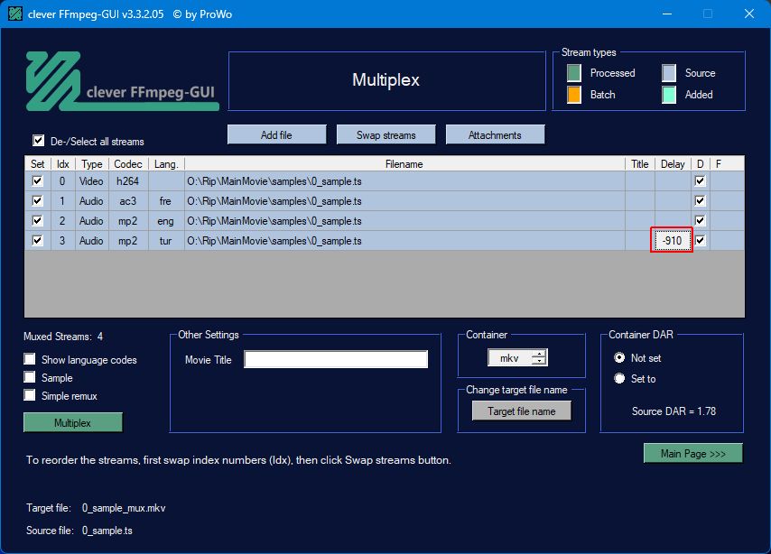

To obtain a negative audio delay, you must (positive) delay the videostream with this value (-itsoffset 0.910).
If other streams with other relative delays are present, things became complicated.
To made it simplier, use clever FFmpeg-GUI.
Load your video, click main page, click multiplex, drag & drop your wav, insert -910 as delay, set ts as container and click multiplex.
Done.
[Attachment 84011 - Click to enlarge] -
