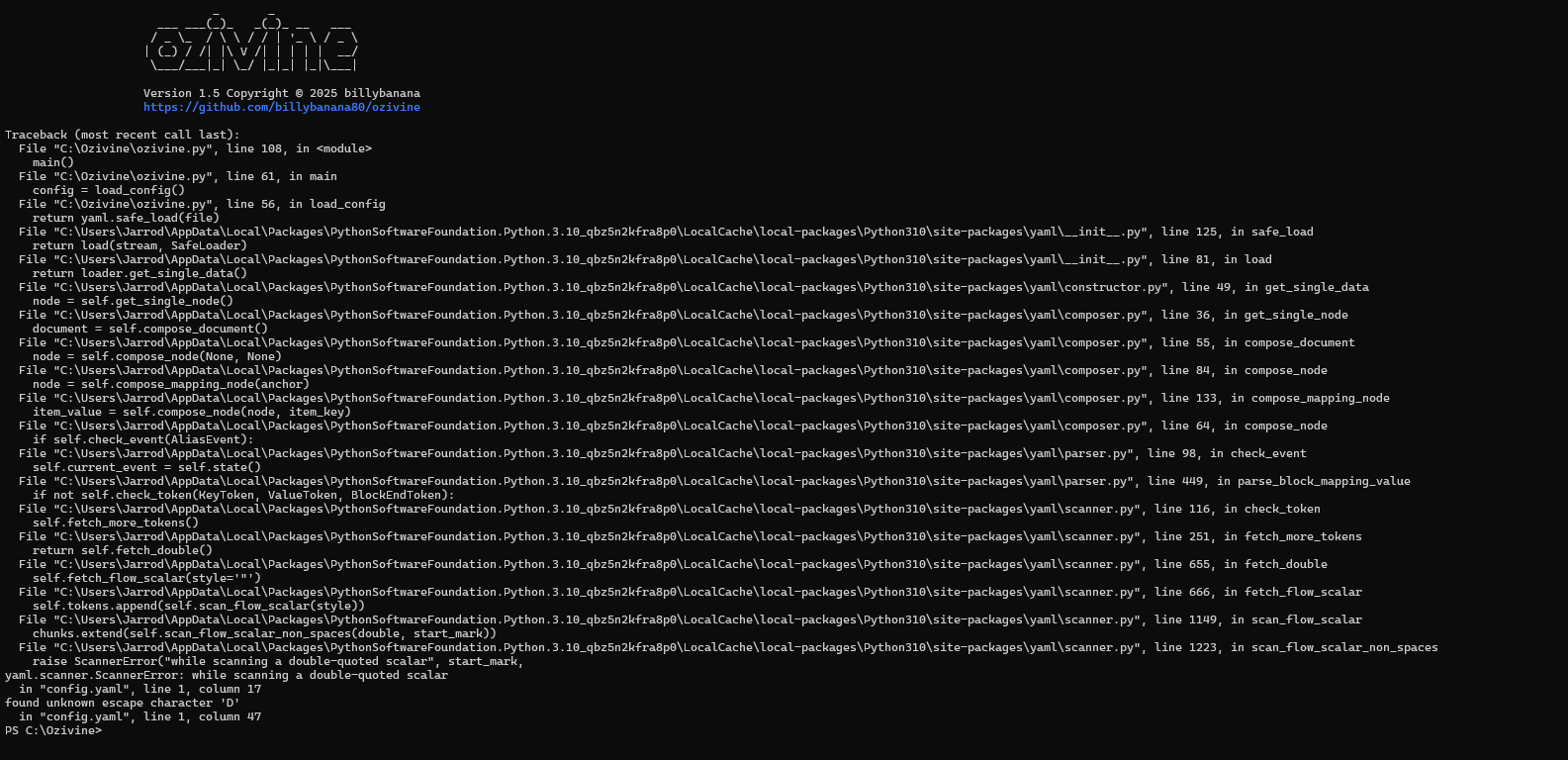

  4. I launched OziVine and the following appeared, any solutions?
    [Attachment 84850 - Click to enlarge]
    Oct 2023
    Afghanistan
    Doesn't like double quotes in your config.yaml file ?
    This is the default for the config file. You could try single quotes or no quotes.
    downloads_path: "C:/YourPath/" # Example paths
    wvd_device_path: "C:/YourPath/wvd/your_device_name.wvd"
    cookies_path: "C:/YourPath/Ozivine/cookies/cookies.txt"
    credentials:
      10play: username:password # Replace with your own credentials
      tvnz: username:password
    Have you specified your paths correctly to downloads, wvd and cookies ?

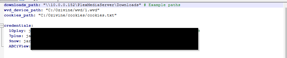

  6. billybanana this is what I have in config.yaml:
    [Attachment 84852 - Click to enlarge]
  7. Got it, it doesnt like network UIDs.

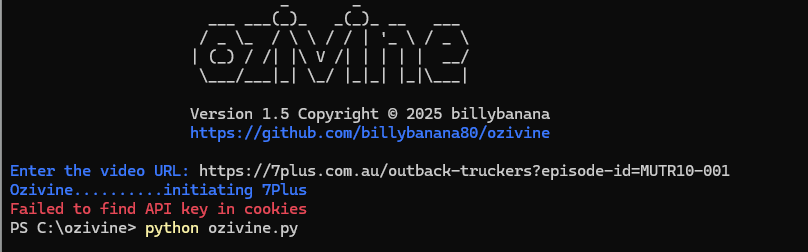

    Oct 2023
    Afghanistan
    I was able to download that episode without issue. The error indicates an issue with your cookies file. I've had the best results using this extension to export cookies previously.
    https://chromewebstore.google.com/detail/open-cookiestxt/gdocmgbfkjnnpapoeobnolbbkoibbcif
  9. I've redownloaded the cookies file, same issue.
