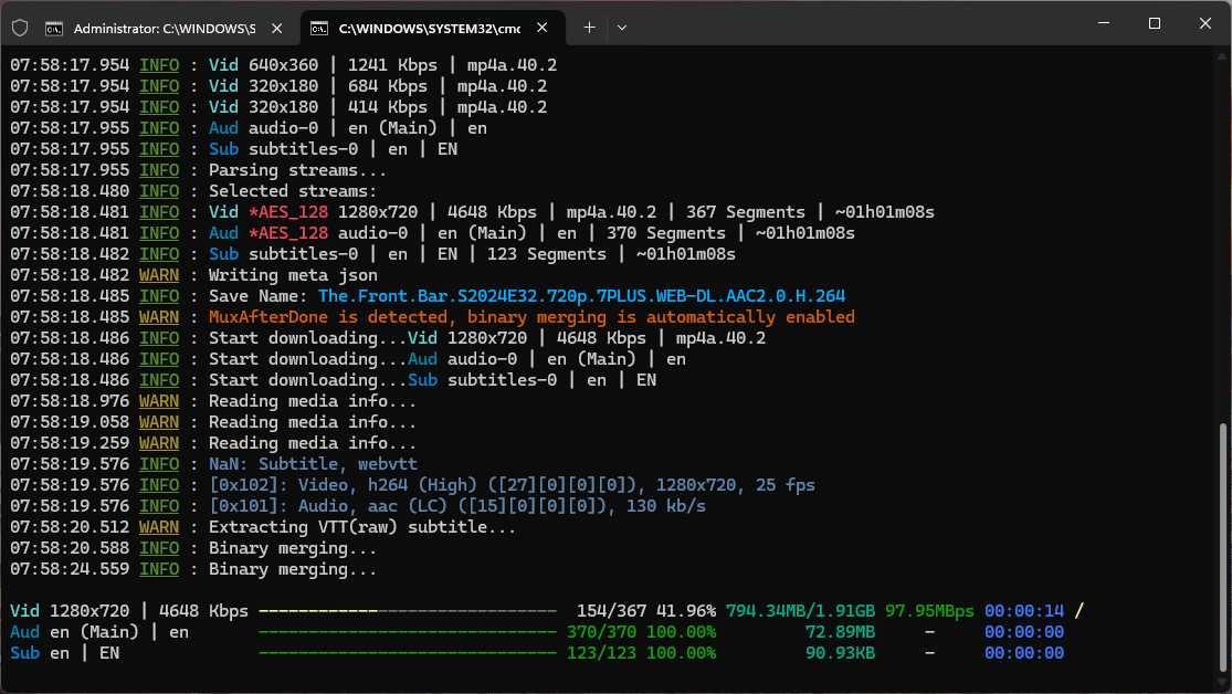

  26. Thanks for this!
    Just wondering if there's any way to speed up the downloads (for 7Plus at least)?
    I've tested via VPN and Smart DNS and while smart DNS is twice as fast, that is still only around 1MBps.
    I can max out my connection within Australia.
    [Attachment 82416 - Click to enlarge]
    Tested with Surfshark & Privado to Sydney and they were both painfully slow.
  28. Originally Posted by smernt View Post
    Yup 7plus, 10play and Iview all max out my gigabit connection. 9now will depend on the server at the time but can hit full speed on occaision and SBS always sucks
