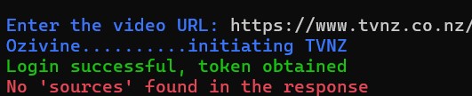

    Add this to the top of the tvnz.py script
    import logging
    # Set up logging to both console and file
    logging.basicConfig(level=logging.DEBUG, handlers=[
        logging.FileHandler("tvnz_debug.log"),
        logging.StreamHandler()
    and then run Ozivine again. It will create a tvnz_debug.log file in the Ozvine directory.
    The only way I have been able to recreate this error is to turn off my NZ smartDNS setting. But I can't play in browser etc either when I do that (as expected).
    It fails at the fetching the manifest using the Brightcove API.
    DEBUG:urllib3.connectionpool:Starting new HTTPS connection (1): login.tvnz.co.nz:443
    DEBUG:urllib3.connectionpool:https://login.tvnz.co.nz:443 "POST /co/authenticate HTTP/1.1" 200 123
    DEBUG:urllib3.connectionpool:https://login.tvnz.co.nz:443 "GET /authorize?client_id=tp5hyPrFuXLJV0jgRWy5l7lEtJlPN98R&response_type=token&redirect_uri=https%3A%2F%2Fwww.tvnz.co.nz%2Flogin&audience=tvnz-apis&state=C0UciskQi9bCepE3ivUK6ZBsugS4Kcs4&response_mode=web_message&login_ticket=YjRK2JRAVD0hIzhGA9lQt0D1tIxR73fu&prompt=none&auth0Client=eyJuYW1lIjoiYXV0aDAuanMiLCJ2ZXJzaW9uIjoiOS4xMC4yIn0%3D HTTP/1.1" 200 None
    DEBUG:urllib3.connectionpool:Starting new HTTPS connection (1): apis-public-prod.tech.tvnz.co.nz:443
    DEBUG:urllib3.connectionpool:https://apis-public-prod.tech.tvnz.co.nz:443 "GET /api/v1/web/play/page/shows/boiling-point/episodes/s1-e1 HTTP/1.1" 200 13954
    DEBUG:urllib3.connectionpool:Starting new HTTPS connection (1): edge.api.brightcove.com:443
    DEBUG:urllib3.connectionpool:https://edge.api.brightcove.com:443 "GET /playback/v1/accounts/963482467001/videos/6345498926112 HTTP/1.1" 403 153

  7. Are there only specific shows on TVNZ that are available in 1080p? Taskmaster NZ comes up as 720p
  8. Hi billybanana, for further feedback...
    I've tried to use a diferent machine to run Ozivine, and I can report I'm getting the same "No 'sources' found in the response" TVNZ issue reported several posts above. My original installation on different system still runs fine, it's using the very same VPN provider (Nord, multi-install etc). I'll carry on trying to compare and contrast as to why it works on my first machine but not second. The yaml looks OK to me, although the files are obviously located in different addresses etc.
    I've tested a 10play show on AU VPN and that's all worked fine.
    I think you are likely right it's a TVNZ "VPN says no" problem, I've played the NZ server switching game and none of them work on new machine, but the first connection on original system just worked no problem, slow, but no problem.
    I'll give it a little rest and try new machine again tomorrow fresh.
    Thanks again for the work.
    Can you try this fix ? I haven't got round to pushing it out yet but will do so tomorrow.
    https://github.com/billybanana80/ozivine/issues/2#issuecomment-2272418116
