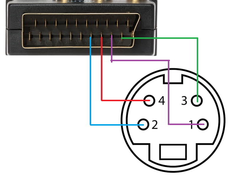

  1. I decided to copy some VHS tapes to my computer. For this purpose, I bought a GV-USB2 grabber. I also received an S-VIDEO cable. I connect as follows: SCART output of the VCR -> SCART to S-VIDEO adapter, S-VIDEO cable, S-VIDEO grabber input, I configure it and I have a black and white image. I switch to Composite (RCA) and I have a color image. Since I want to rip tapes, I want better image quality. Nothing comes out. I connect it to a DVD recorder. Also with S-VIDEO I have a black and white image, and with RCA I have color! I take a multimeter and I get this connection in the SCART-S-VIDEO adapter.
Name:	schemat scart.jpg
  2. What model is your VHS player? I seems to simply not support S-Video. A SCART-to-SVideo adaptor does not help in this case.

    What VCR are you using?
    The S-Video connection on those SCART adapters can only work correctly if there is a S-Video signal available on the SCART, they not convert composite to S-Video.
    Regular VHS players not have S-Video on the SCART connector, only composite video.
    This then will indeed give you a B/W image when using the S-Video connection.
    If it IS a S-VHS VCR you have to specifically configure the SCART for composite or S-Video or use the dedicated S-Video connector when available.

    Sharp VC-MH78
    This is a VHS recorder only. It does not support S-VHS (S-Video).

    ok. Do you know any converter Component RGB to 4 pin s-video?
    Of course there are various signal converters available.
    But if you are thinking about using the SCART RGB output signal for that, that is not going to work with VCR's.
    There is only composite or (with S-VHS) S-Video available on the SCART output of VCR's.
