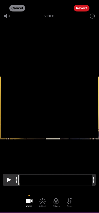

  16. If it is an iPhone - and you have the phone, with the recording on it - you could open the Photos app, click on the suspect video and in the top right click 'Edit'. If there have been changes then you may see a red 'Revert' button in the top right, which will undo any edits to the video.
