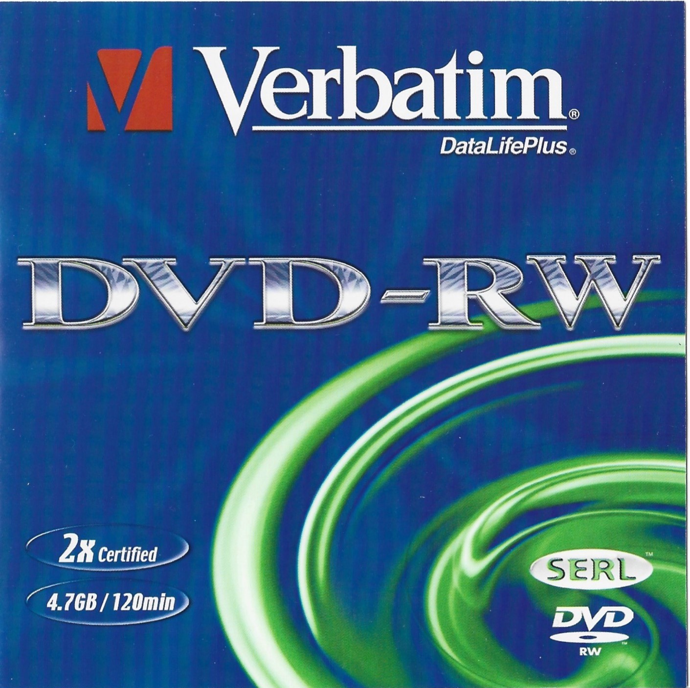

    I have used in the past Verbatim DVD-RW SERL 2x Certified. Over the past few weeks I was busy transferring the contents to HDD and formatting the disks. So I have now a stack of a LOT of disks in their original jewel box that I am not going to use in the future and can offer to sell them.
    Judging by the quality of the transferred content, I can only say they were a good choice at the time.
    I have also Verbatim DVD-R unused packs of 50.
Name:	Verbatim DVD-RW 2x SERL.jpg
