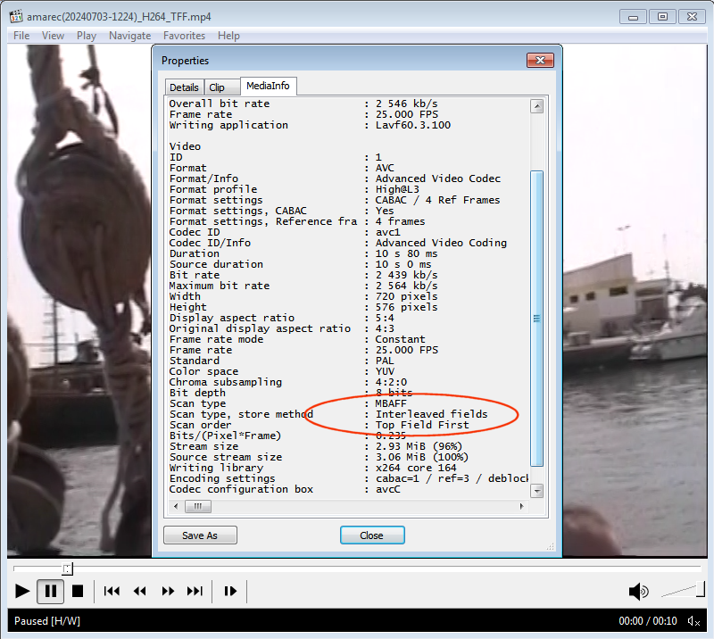

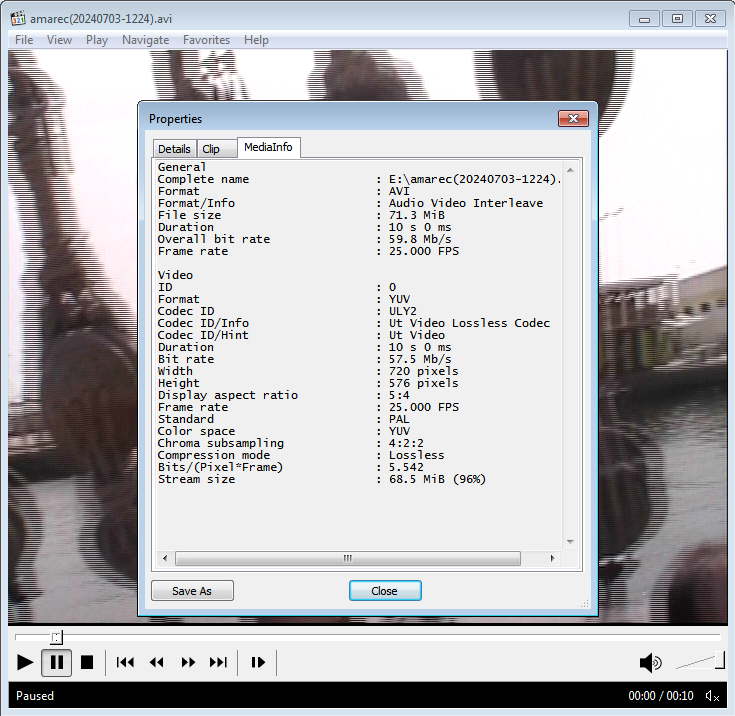

  8. Member The_Doman's Avatar
    Feb 2004
    Netherlands
    Originally Posted by Hamilthon View Post
    Hi, in a previous thread i managed to record interlaced with amarectv, the problem is that i get the 50 fields but the video is still stuttering,
    I don't get the smoothness i have when playing my tapes on my CRT.
    As mentioned, your captures are fine interlaced.
    Just your PC player does not know it is interlaced and plays it as 25P.
    Also not al codecs support proper flagging the files as interlaced so the players can handle it as such.
    If you check the info of your clip, there is no indication of interlacing.
    Media Player Classic Home Cinema (MPC-HC):
    [Attachment 80396 - Click to enlarge]
    If you encode it with correct interlace settings, i used here AviDemux, it should play (more) smoothly on your PC if your player handles interlaced video properly.
    [Attachment 80397 - Click to enlarge]
