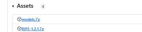

    What steps did you take to do the conversion, so I could repeat this myself on future clips?
    Installation of RIFE:
    - Copy the rife.dll in Avisynth's plugins64+ folder
    - Copy the models in a folder 'models' in Avisynth's pugins64+ folder
    Avisynth script which I used for that video:

  29. Originally Posted by armyofquad View Post
    You reference copying models into a folder called models, and the RIFE documentation references models.
    What are models? Where are models? Where do they get them? How are end users expected to know this without any actual explanation about this? (not asking to be a dick, honestly trying to understand this - is this being poorly documented? Or is there actually something listed on the page that I'm overlooking?)
    From the link which I provided you have to download the models (file models.7z) as well, unzip it and you'll get a pile of folders. Create a new folder 'models' in the plugins64+ folder to copy these folders you got from unzipping models.7z into.
    So
    - download models.7z
    - create an empty new folder 'models' in the plugins64+ folder
    - unzip the content of models.7z into that newly created folder
