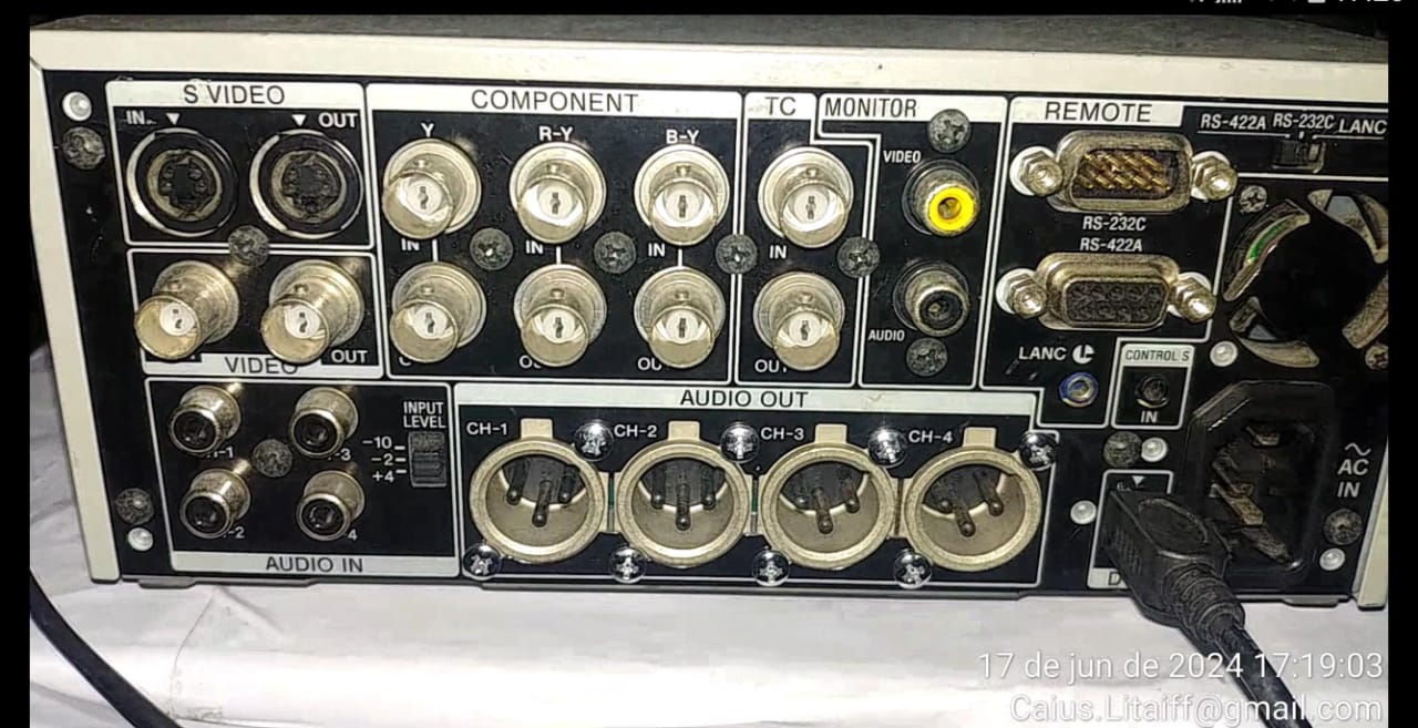

    I have this deck, it has Svideo inputs/outputs and when I connect the VCR to it, the video is shown on the front screen. But I would like this to output via DV cable, is that possible? Or would it only output through Svideo?

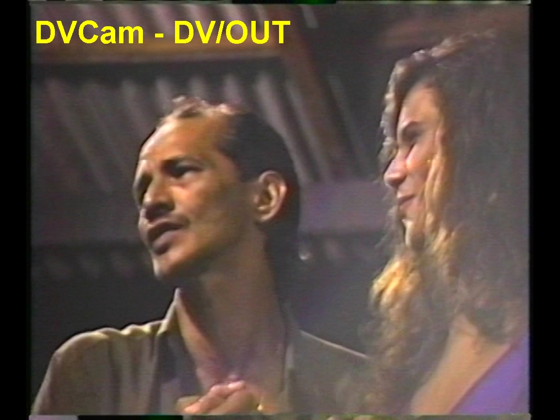

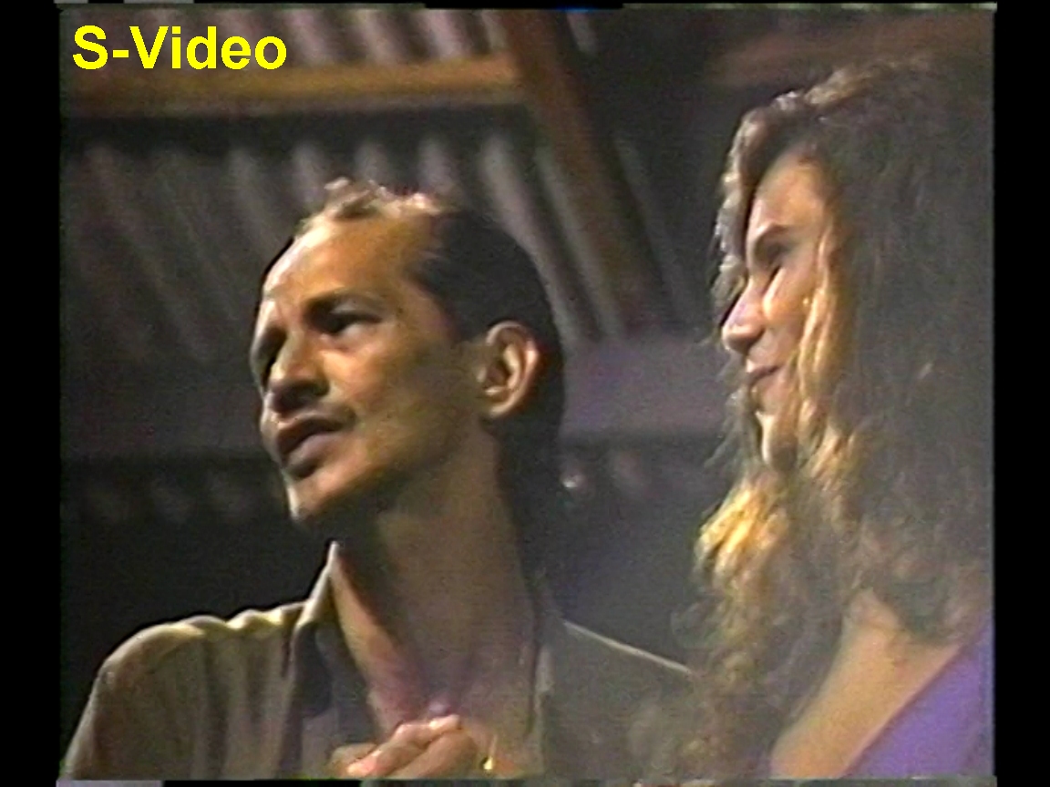

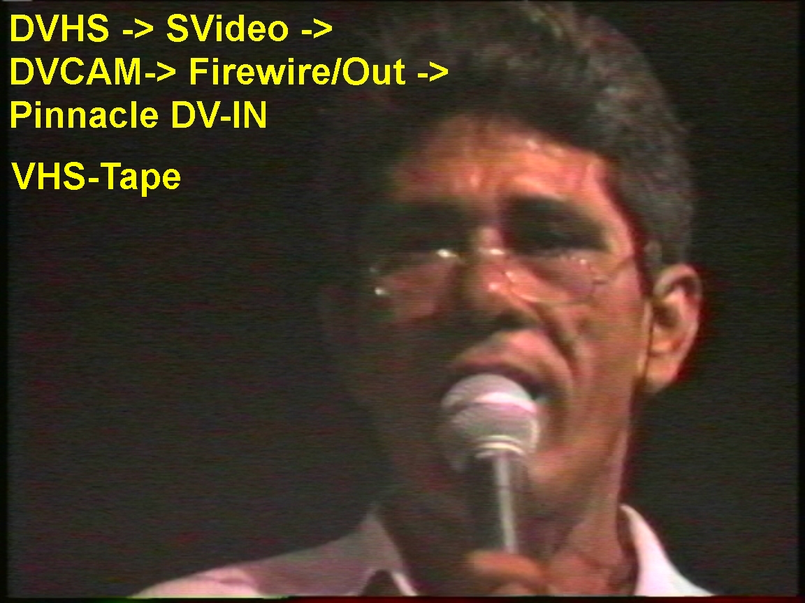

    Hello. I performed the test, D-Vhs Super video to DVcam super video input and firewire output.
    Clearly the super video direct to the Philips DVDR 3355 recorder is better than coming out via the DVcam's firewire as a pass-through.
    [Attachment 80466 - Click to enlarge]
    [Attachment 80467 - Click to enlarge]
    It remains to be seen what it would look like outputting directly through the D-Vhs firewire, which I never managed to do.

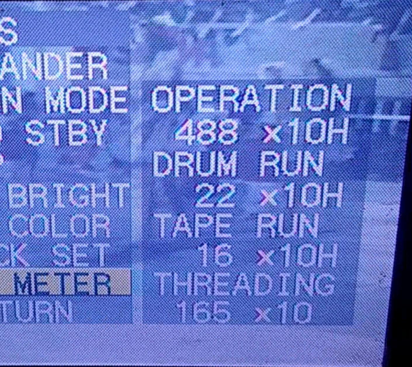

    Can anyone tell me which conditions of the heads is like? Good? Bad?
    [Attachment 80816 - Click to enlarge]
    Another question... I've pressed the reset button on this device a few times, would that imply also resetting this informations?
    It's not better, but it has a different color range. It looks like SVideo just has the lower range cut off.

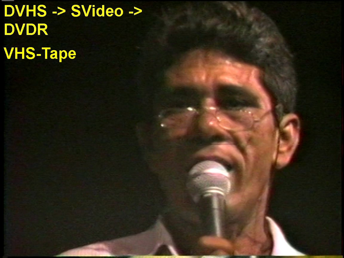

    I believe because there is a little more detail in the video definition, S-video is still better connected directly to the DVDR recorder.
    [Attachment 80836 - Click to enlarge]
    [Attachment 80837 - Click to enlarge]

    Aug 2018
    Wrocław
    This "better" video looks like it's already pre-filtered (probably by DVDR*). But it's missing some hair, so there's something wrong with the color range. That's why it looks sharper by the way.
    https://i.imgur.com/8sEZONp.png
    Edit: *Your DVDR is based on LSI Logic, which is why it filters the image so nicely (the same can be achieved in software). However, this workflow loses some colors in this sequence.
