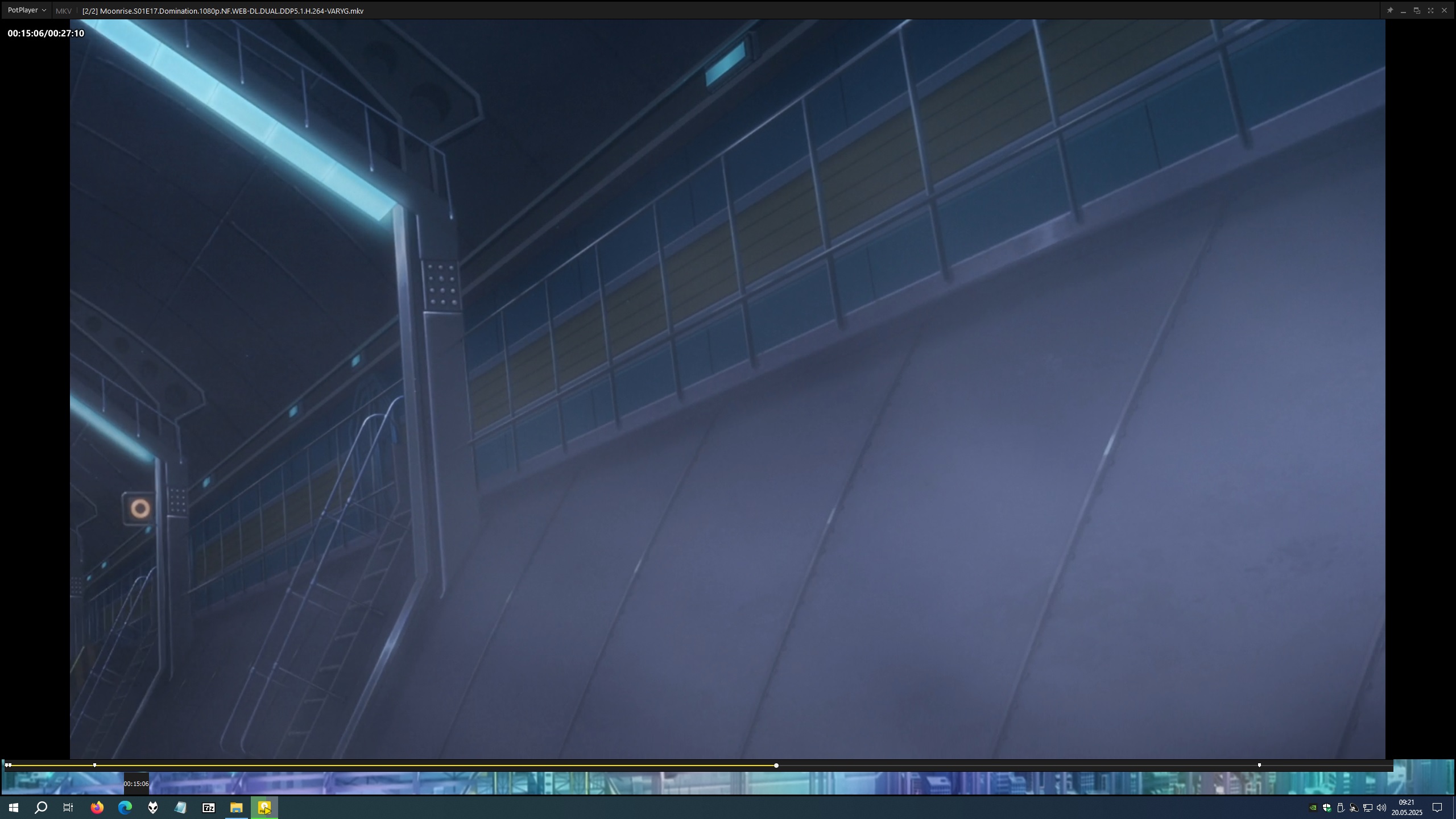

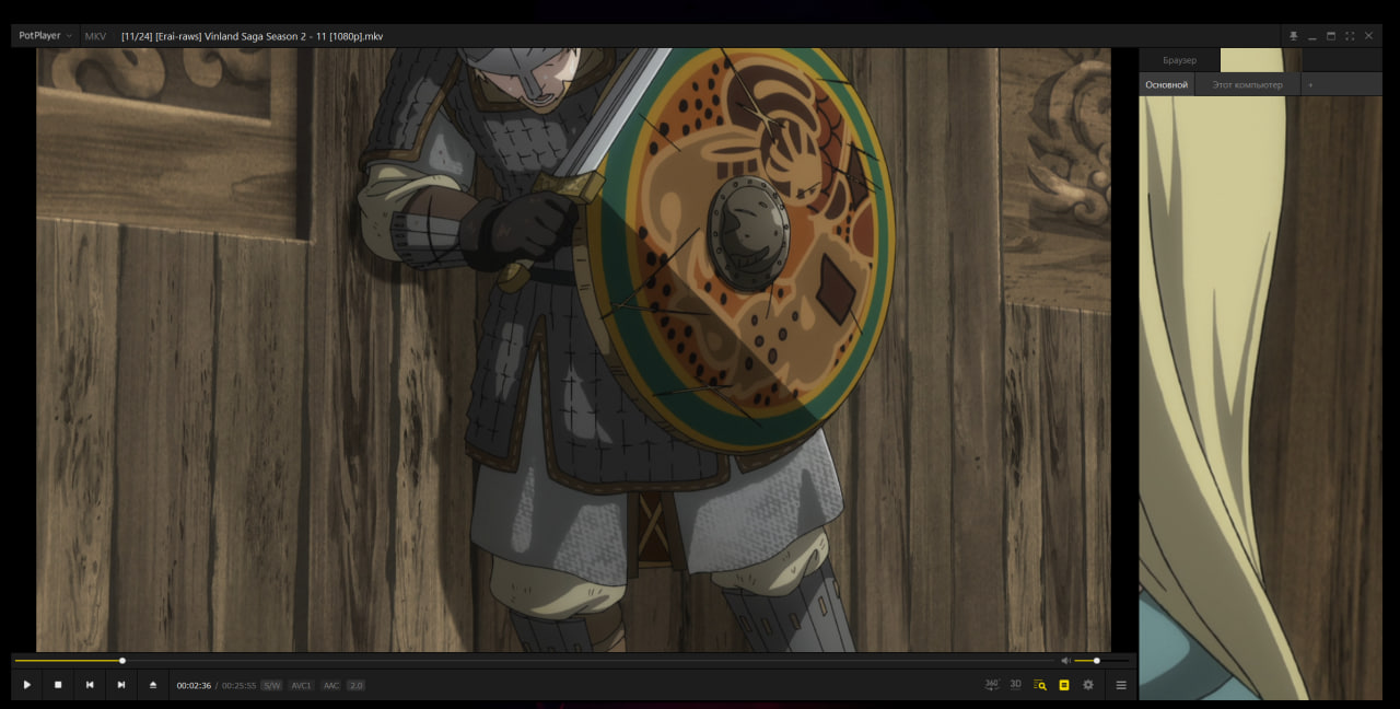

I noticed lately the weird glitch in PotPlayer. Sometimes when I exit the full screen mode parts of video stay at lower part of app interface. Usually its when video display some solid background (same color for couple of seconds, etc.). It started on version 240509(1.7.22232) and continues on 240618(1.7.22261).
Example:
[Attachment 80259 - Click to enlarge]
Anyone else have similar issue?

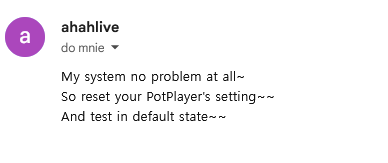

Message from devs, highly doubt it will be fix. Hopefully, maybe by some magic in next updates.

What card exactly You use, and what drivers version? We will verify if we have the same card.
We have different cards and even different drivers so no way it's VGA problem. I'm sending this to devs.

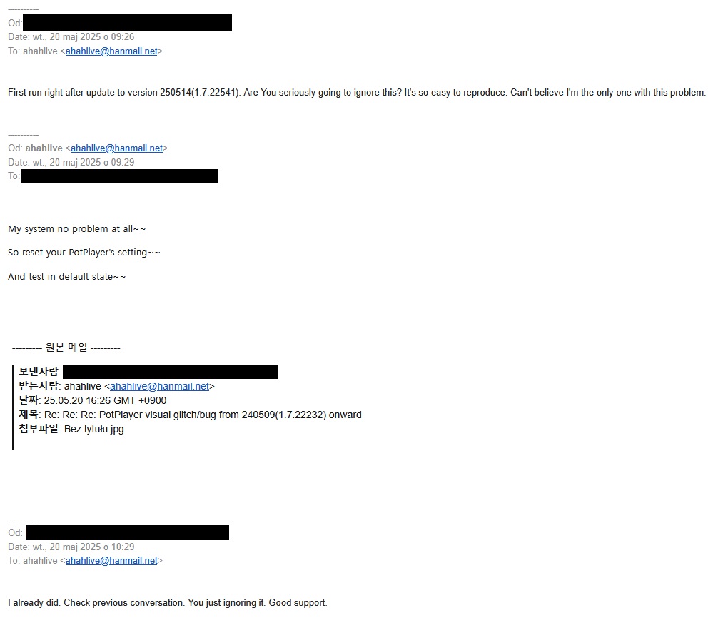

Regarding PotPlayer support... They are absolute joke. I was patiently waiting for them to fix this. Around march they realesed bunch of beta version, so I naively though that they will fix tons of bugs. When they finally realeased stable version 250514(1.7.22541) this happened.
[Attachment 87457 - Click to enlarge]
Then I send them message and I received almost immediate reply.
[Attachment 87459 - Click to enlarge]
3 minutes after my message! They don't even look at screenshot! Joke! They don't care. I also found on forum other people who had similar experience with PotPlayer support.
So, if You have this bug/glitch just downgrade, block update and forget about support and new versions.Last edited by Osin; 17th Jun 2025 at 09:30.

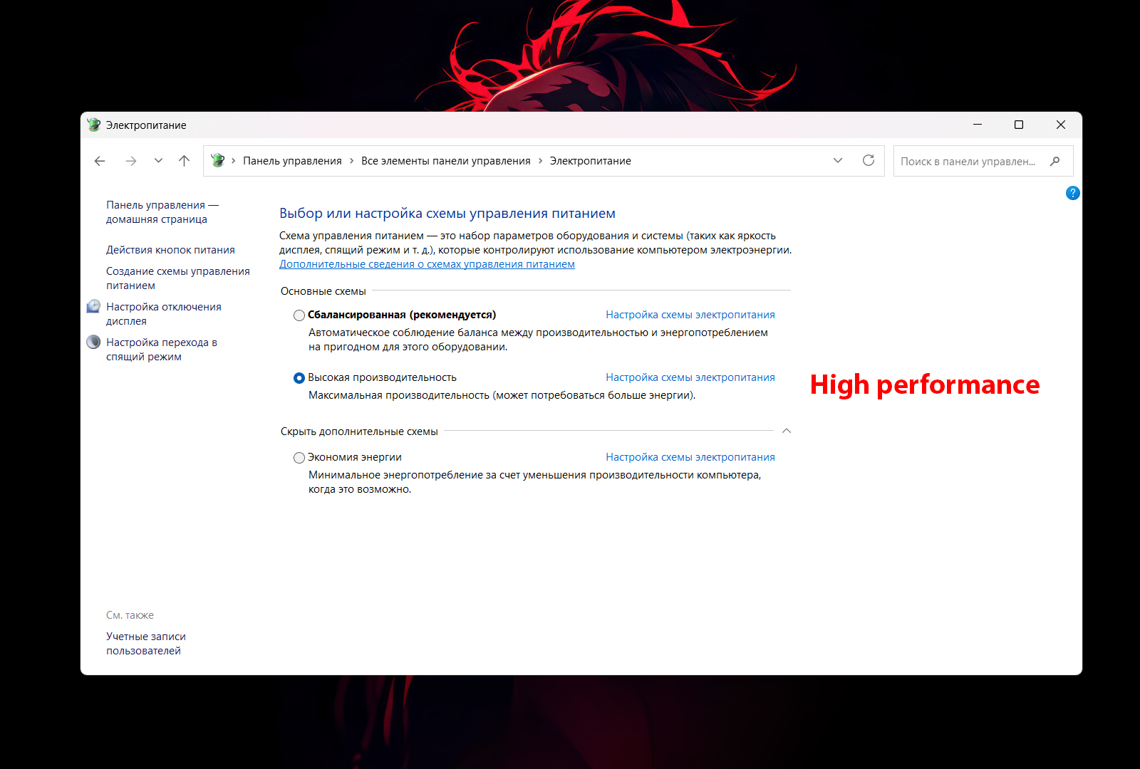

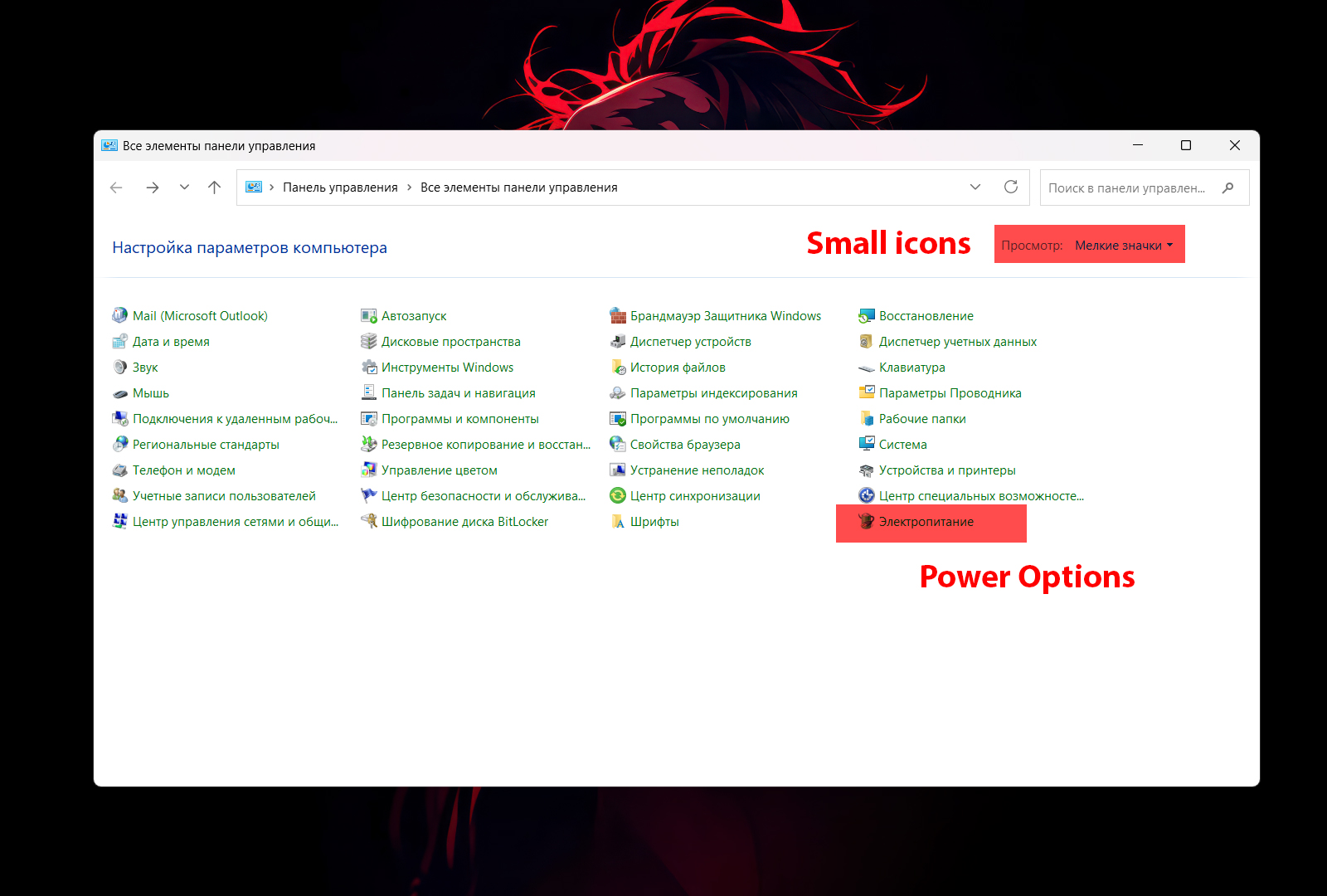

Step 1 – Set Windows to High Performance
Go to:
Start → Control Panel → Power Options
(Switch to "Small icons" view in the top-right if needed)
[Attachment 88677 - Click to enlarge]
Select: High performance power plan

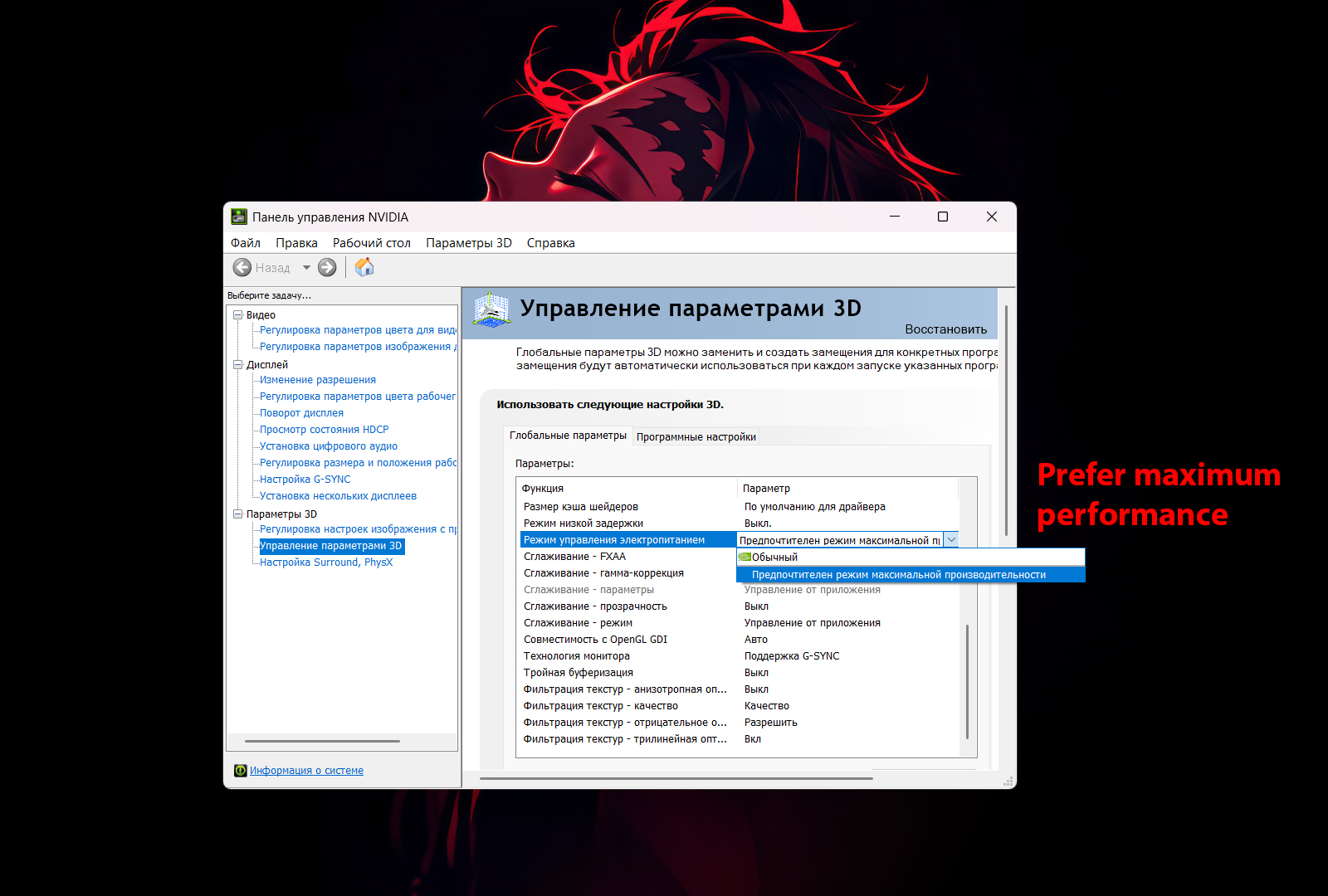

Step 2 – Set NVIDIA to Maximum Performance
Open:
NVIDIA Control Panel → Manage 3D settings → Global Settings
Set:
Power management mode → Prefer maximum performance
[Attachment 88675 - Click to enlarge]

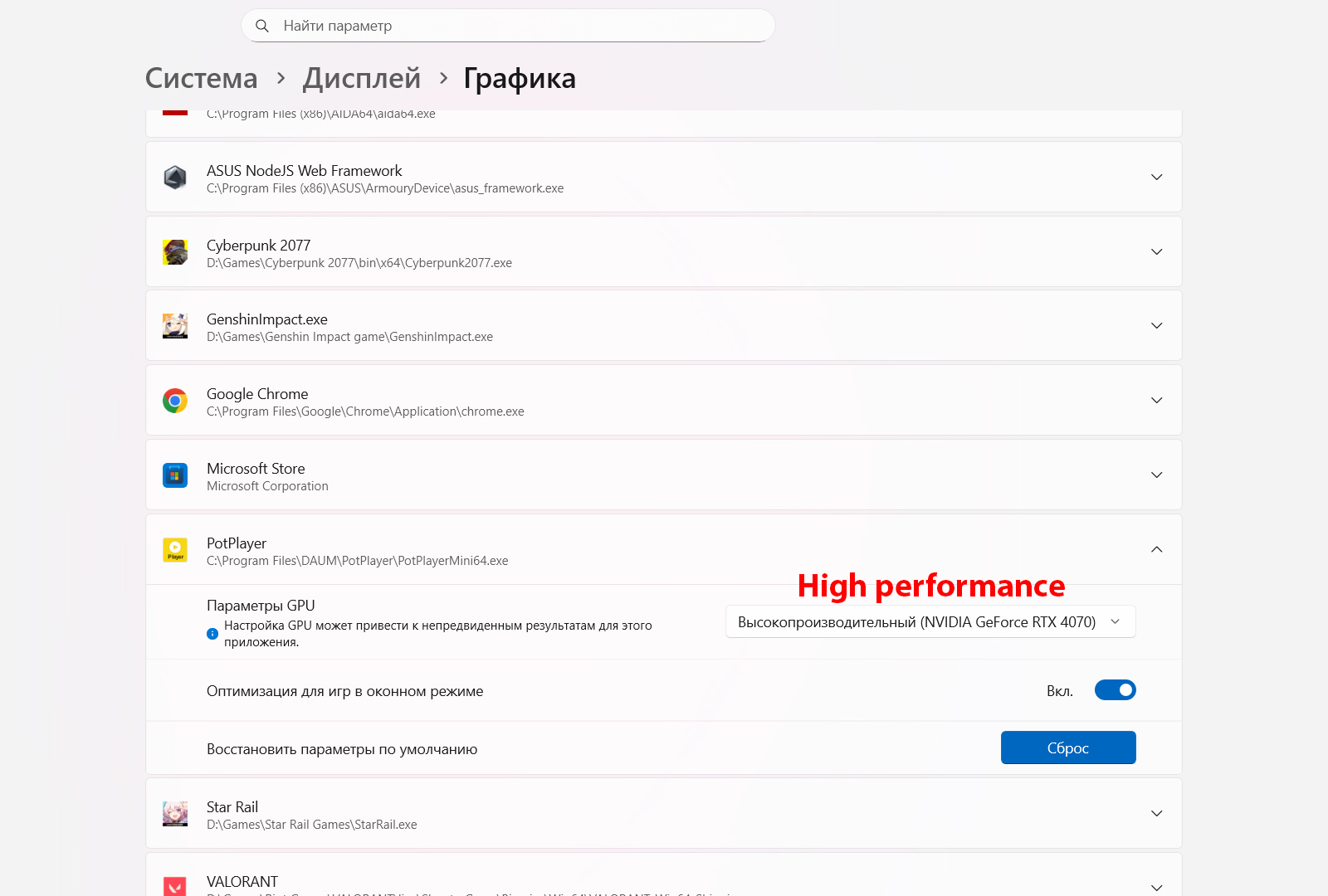

Step 3 – Force High Performance GPU per App (in Windows Settings)
Go to:
Settings → System → Display → Graphics
Find PotPlayer (or add it manually)
Click Options → Set to:
High performance
Repeat this step for any app where you see the issue (browsers, media players, etc.)
[Attachment 88676 - Click to enlarge]

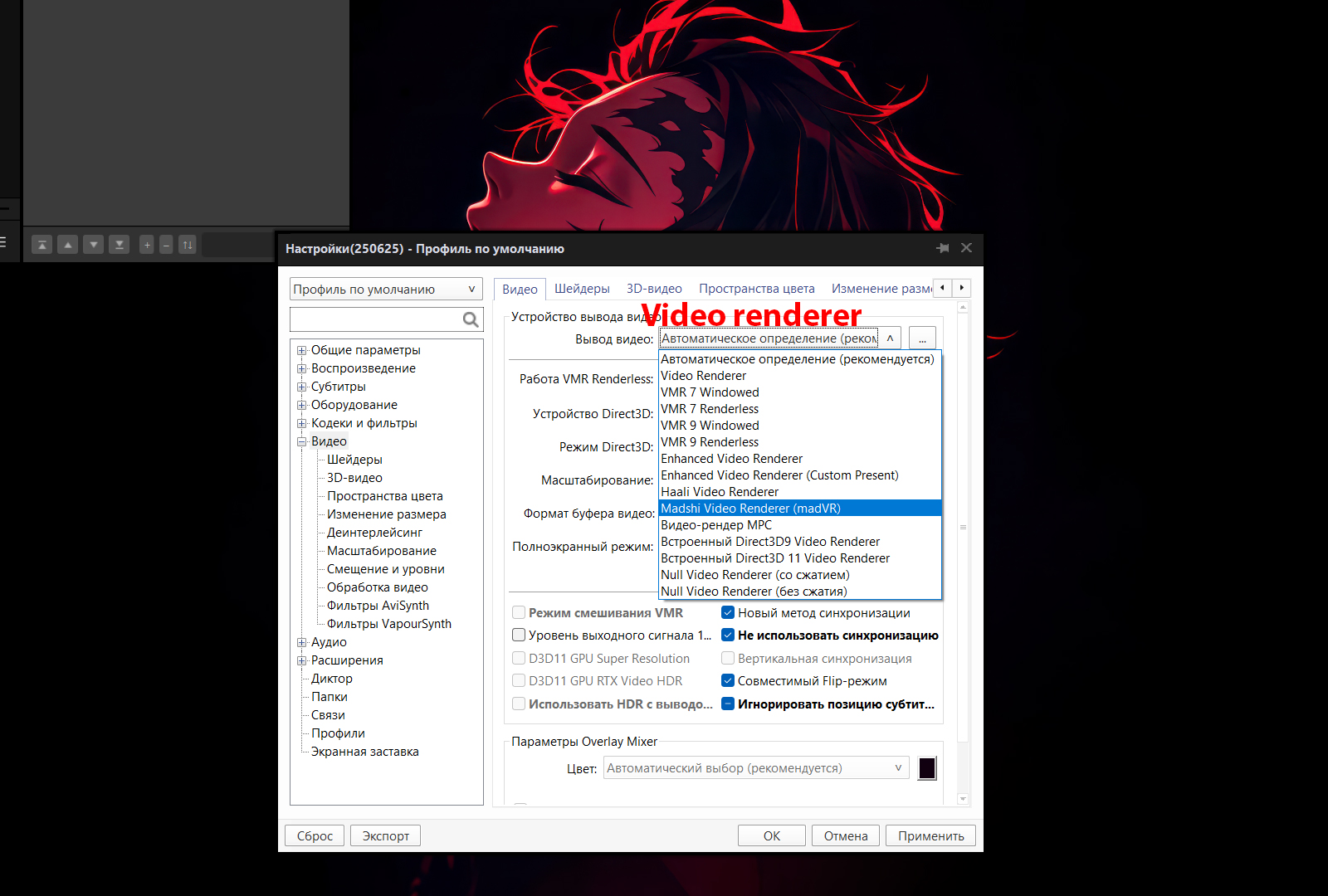

Solution 2 – Media Player Specific Fix (PotPlayer)
If you only experience the issue with video playback (e.g., PotPlayer), this method can help too.
Steps:

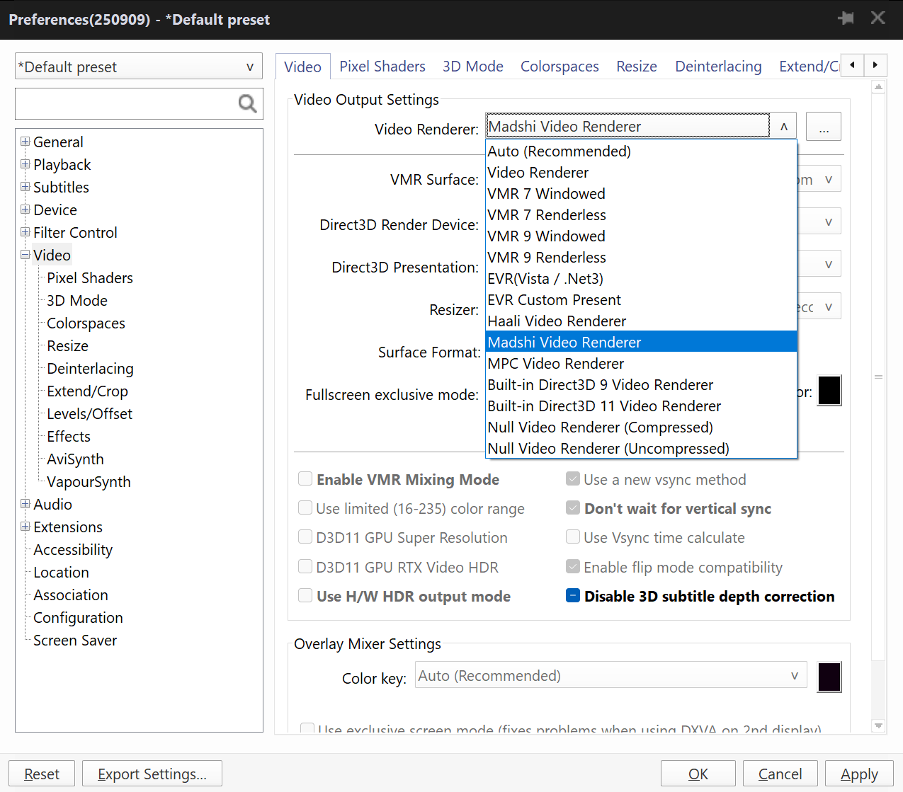

Download and install madVR (a high-quality video renderer)
Open PotPlayer → Press F5 to open settings → Go to Video
Set Video renderer to: madshi Video Renderer (madVR)
[Attachment 88678 - Click to enlarge]
Close and reopen PotPlayer
Now madVR will start with PotPlayer and appear in the system tray. It takes full control over video rendering and bypasses Windows DWM, effectively eliminating this rendering bug.Last edited by Negqtive; 11th Sep 2025 at 14:53.

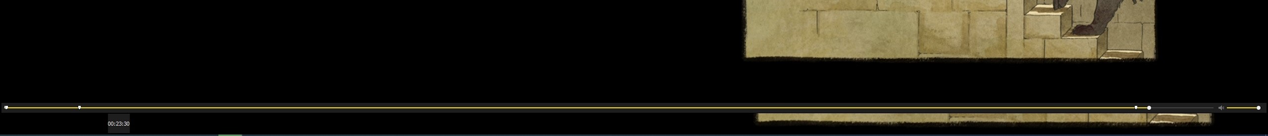

Hi,
I didn’t have any flickering, but I occasionally experienced a similar graphical glitch — just like the one the original poster described. It happened rarely in browsers and quite often in PotPlayer.
The issue looked like this:
[Attachment 88820 - Click to enlarge]
When exiting fullscreen mode, part of the screen would “stick” to the interface and would only disappear when hovering the mouse over the affected area.
After switching both Windows and GPU settings to High Performance mode, the glitch hasn’t returned.
Regarding madVR — yes, I did install it on my system, and while using it, the glitch was completely gone. However, after the performance tweaks fixed the issue, I went back to the default renderer and everything still works fine. -
