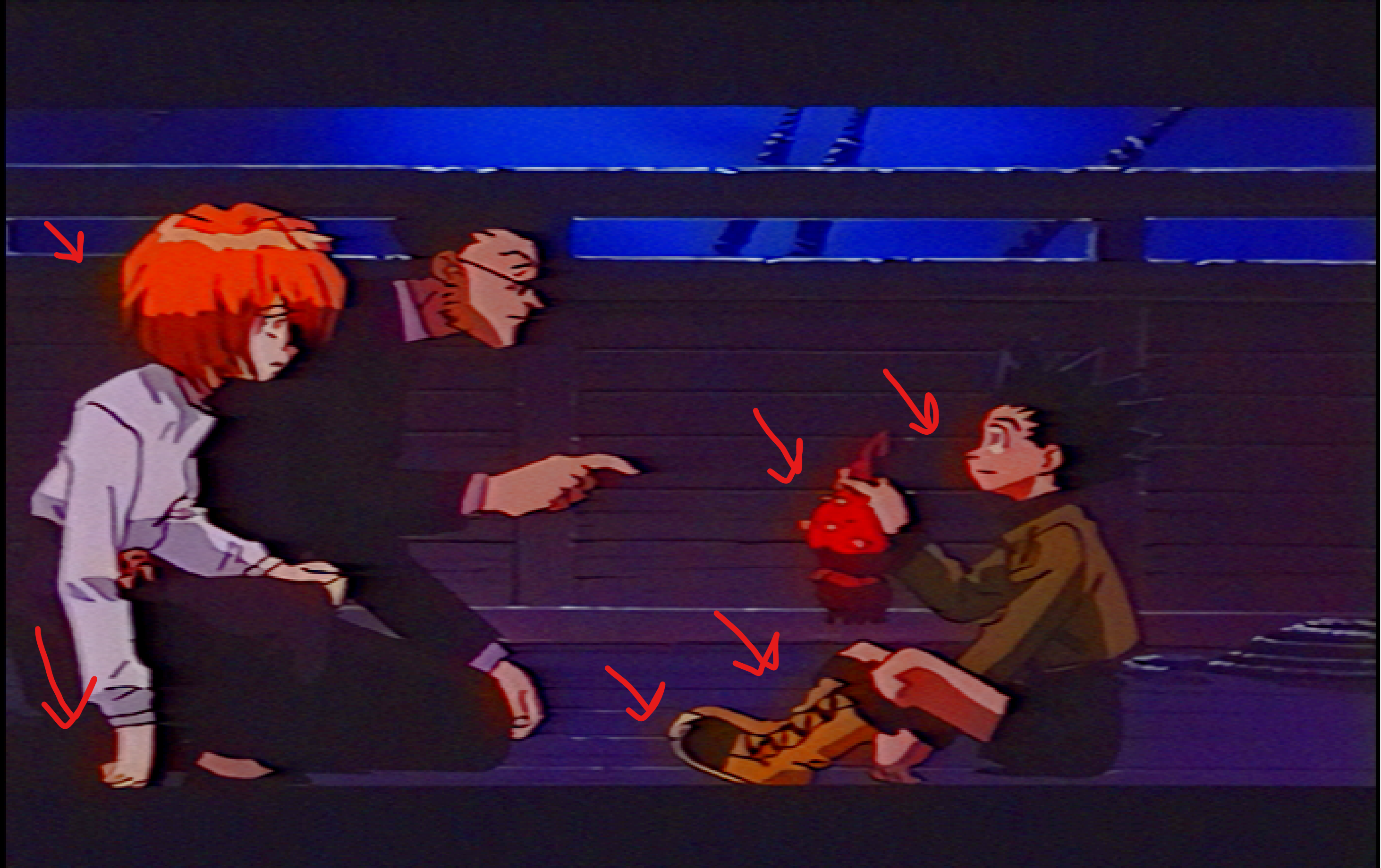

  1. Running into an issue with some red color bleeding that seems to be shifted towards the left-side of the video. I've tried a few different things:
    https://openmodeldb.info/models/1x-BleedOut-Compact - This gets rid of it at the cost of messing up the colors in the video.
    Tried shifting the luma/chroma using Overlay:
    Spline36Resize(400, height)
    # Using one (or both) of these seems to lessen the issue. But it also causes the overall picture to look really bad.
    Overlay(GreyScale(last), last, x=-4, mode="luma")
    Overlay(last, GreyScale(last), x=4, mode="chroma")
    nnedi3_rpow2(2, cshift="Spline36Resize", fwidth=704, fheight=480)
    Tried using Chromashift
    Chromashift(c=4) # This seems to lessen it a bit as well, but not by much, and any more than this messes up the image too much
    I noticed when messing with the saturation that there seems to be a general shift towards the left side with a lot of bleeding in general that I'm having trouble fixing via Overlay. Was wondering if anyone might have any suggestions?
    [Attachment 80126 - Click to enlarge]
    Thanks for any help!

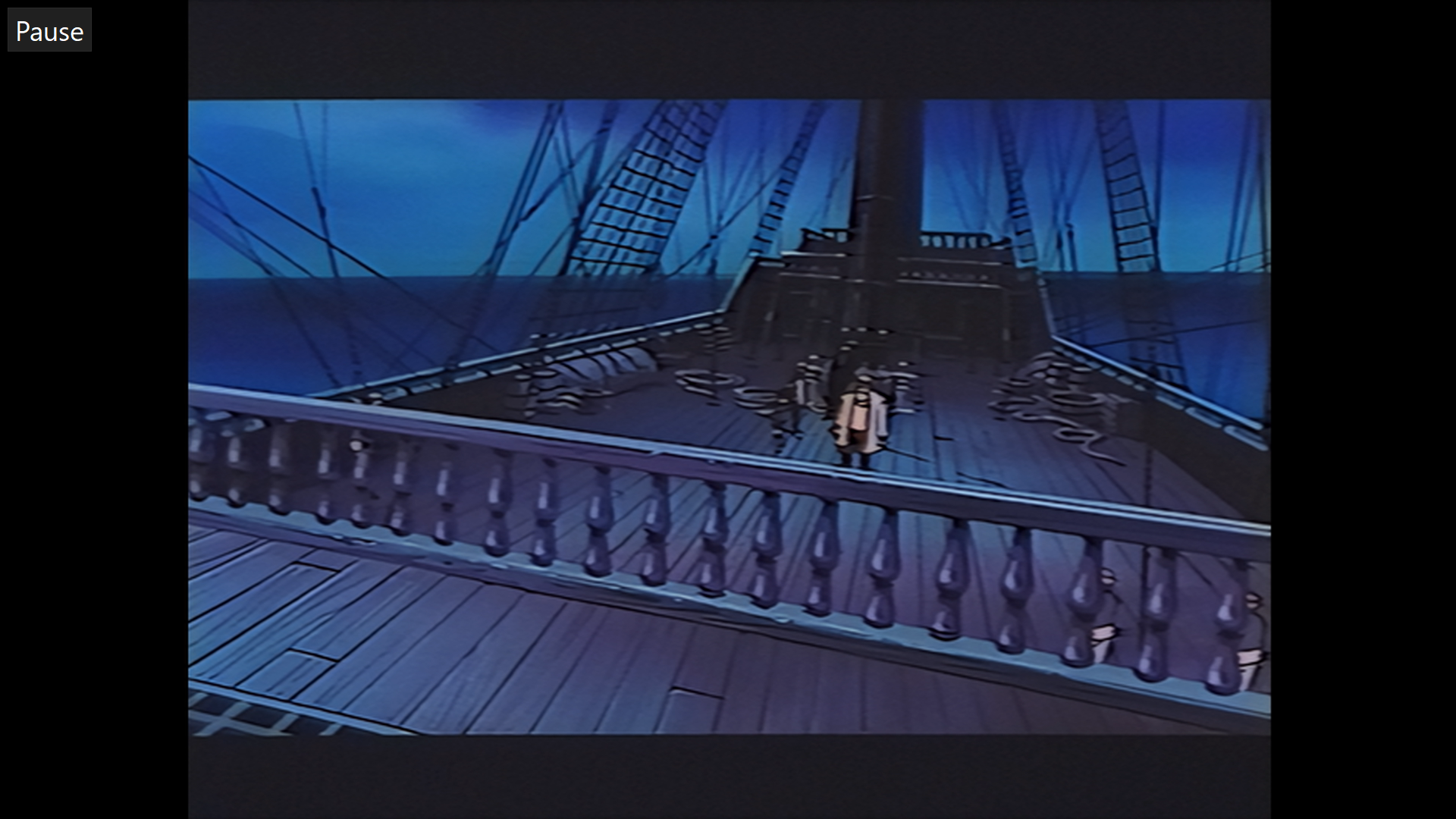

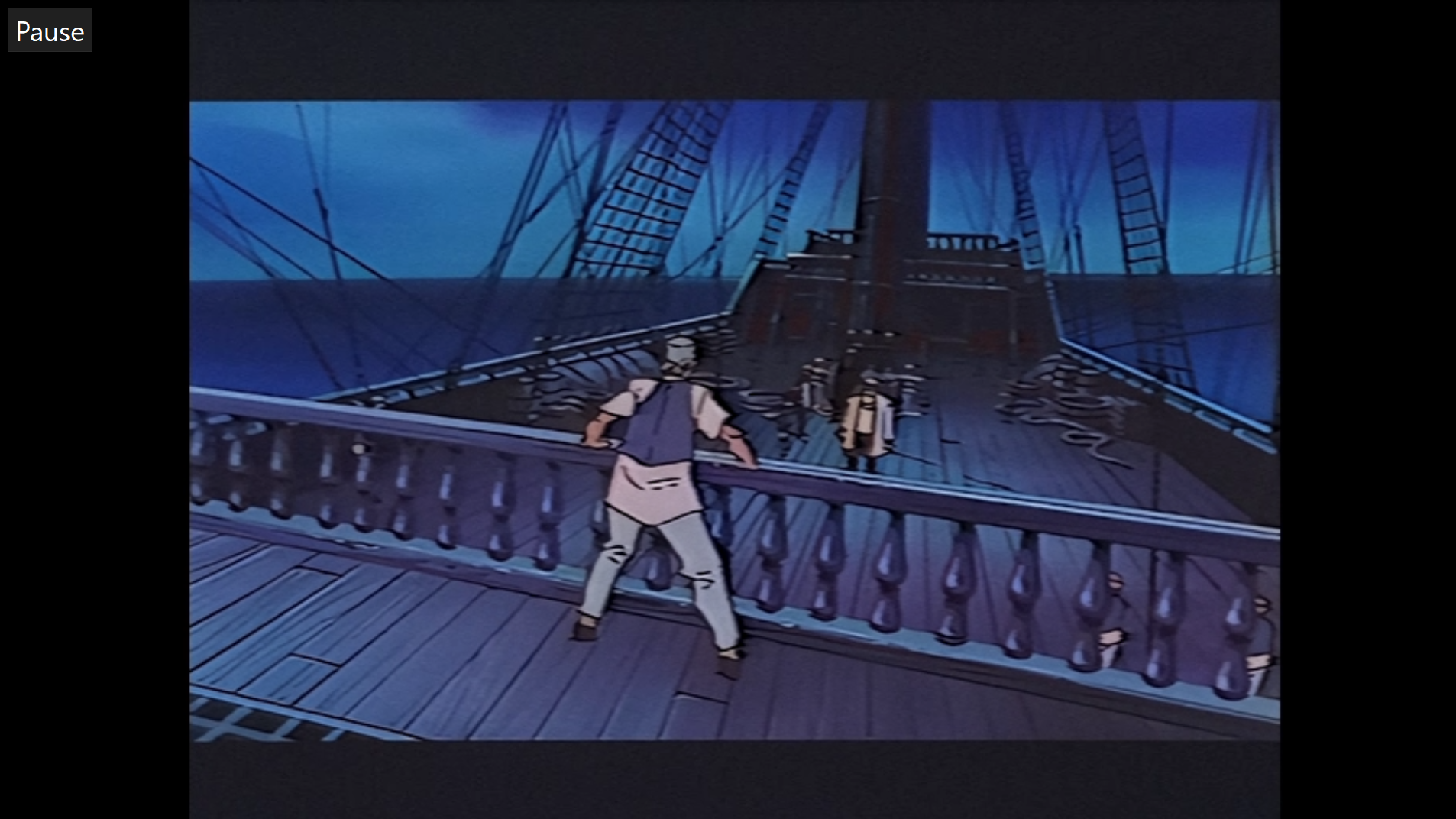

    Gotcha! Thanks a ton, I got it working and I really like the results. Thanks for the alternative as well, personally I think your first solution with BasicVSR++ worked great. There was one issue though, where it ended up messing with the chroma in other scenes pretty badly:
    [Attachment 80160 - Click to enlarge]
    If you look in the background you can see some bleeding (this bleeding wasn't there before the chroma merge in Hybrid). However, one of my other filters uses the following:
    MergeChroma(SMDegrain(thsad=200, tr=3, PreFilter=4), SMDegrain(thsad=2000, tr=5, PreFilter=4))
    And the SMDegrain on the chroma fixes the issue:
    [Attachment 80161 - Click to enlarge]
    So using both your BasicVSR++ solution and the SMDegrain on the chroma provides some really great results that takes care of 90% of the issue.
