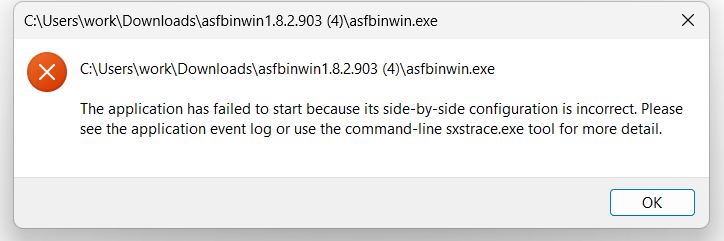

    1. I wasn't able to get ASFbin to work. I'm using Windows 11, I get the attached output when I try to run the .exe. I also tried the version for the cmd line, it goes into the background and doesn't prompt me to do anything. What have I gotten wrong?

    Thanks again.Image
    [Attachment 80159 - Click to enlarge]

    Mar 2008
    Right click the executable (or shortcut) and select Troubeshoot Compatibilty
  6. Originally Posted by MK1977 View Post
    Use this version
    https://www.videohelp.com/download/asfbinwin1.8.2.903.zip
    If you get the error message above, then download and install vcredist_x64.exe from here:
    https://www.microsoft.com/en-us/download/details.aspx?id=26368
    if the error still occurs afterwards, then download and install vcredist_x86.exe too from same location.
    Then it should work as aspected.
