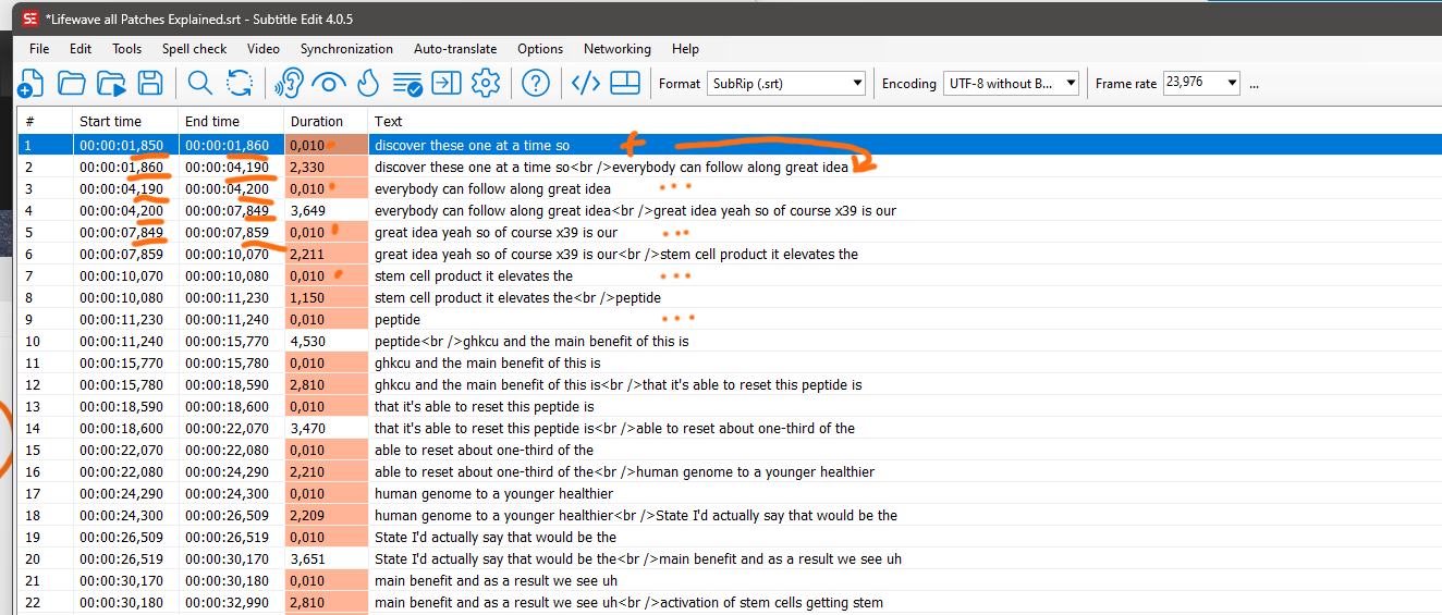

    Please advise me how to combine, if it can be done automatically, short subtitles lasting 0,01sec with the following line. See sshot.
    I can't discover anywhere if this is possible.

  3. Subtitle Edit has quite a few options for merging lines.
    Under the Tools menu "merge lines with same text" might be an option, otherwise under Options/Settings/Shortcuts there's quite a few merging choices. You need to create a shortcut key for the ones you want to use. There's also a right click menu option when you high-light a bunch of subtitles "merge selected lines" . One of those options will hopefully do it. I haven't used them much myself.

    I've tried every possibility of joining, editing, or correcting in this case. Nothing worked. I refuse to do it by hand, otherwise I'll give up.
