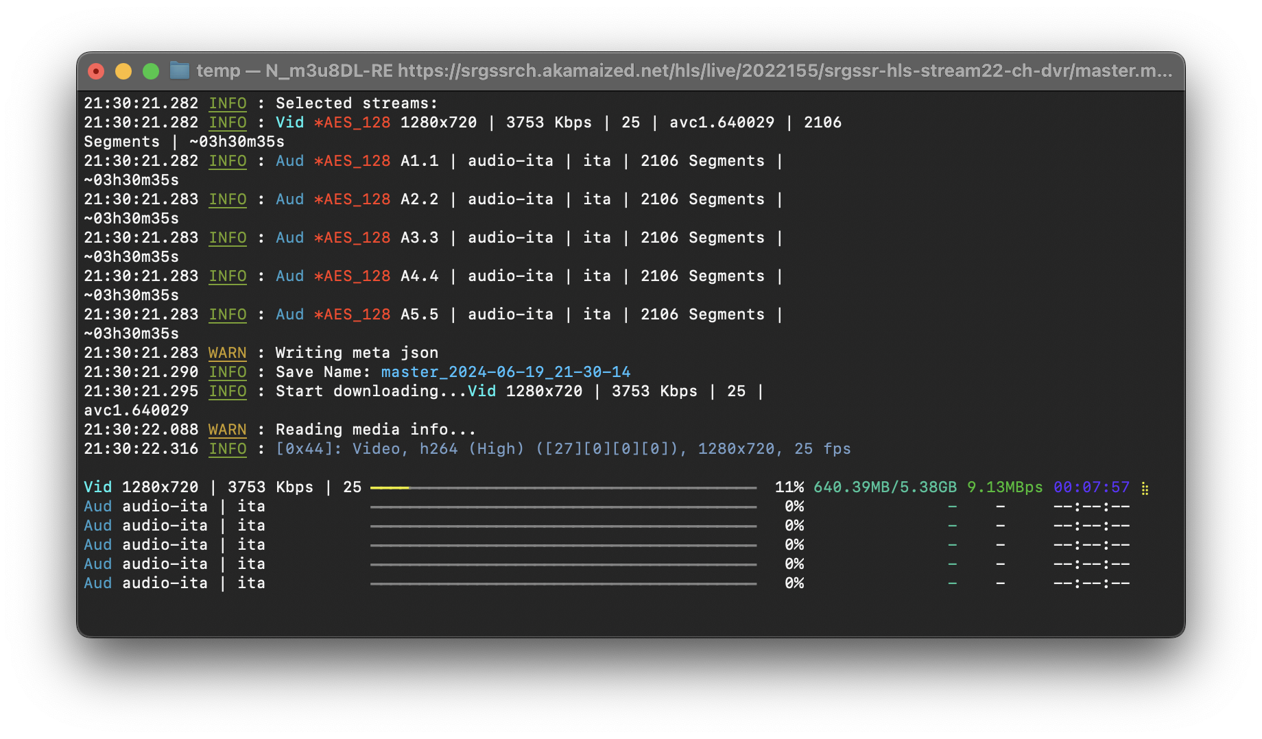

    Make sure to grab the all m3u8 url. I had no issue downloading :
    [Attachment 80035 - Click to enlarge]
