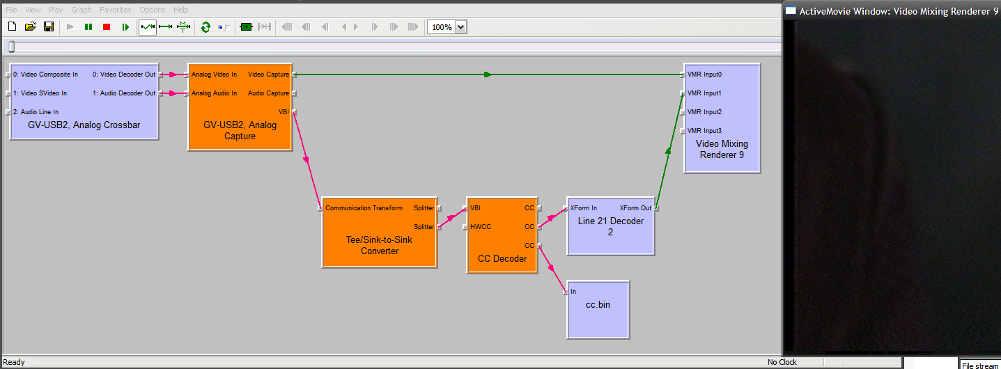

  1. I've followed McPoodle's directions as best I can, and end up with a very similar graph to the guide. And my graph looks like a few other screenshots on this site. But I never get anything besides a zero kB file. I tried this with both a produced movie and some OTA recordings that I know have the Line 21 CC.Image
    [Attachment 79966 - Click to enlarge]
    What might I be doing wrong? Maybe it's just the capture device?

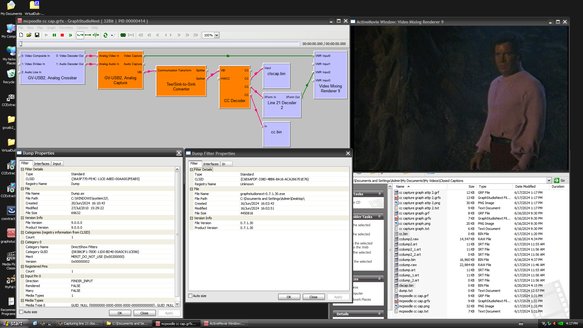

    So, I've repeated the above filter graph using both forms of the dump filter, "cc.bin" as the built in one and "clscap.bin" as the dump.ax filter. Details for the respective filters can be seen in the property dialogs. I've also shown and highlighted my output files, and both were empty, even after running the graph for at least 30 seconds.
    As far as I know, this part of the graph should be what works universally for closed captions:
    [CapDev], Analog Crossbar --> [CapDev], Analog Capture (VBI) --> Tee/Sink-to-Sink Converter (Splitter) --> CC Decoder --> Dump
    The rest depends on whether you want a preview or additional file captures.

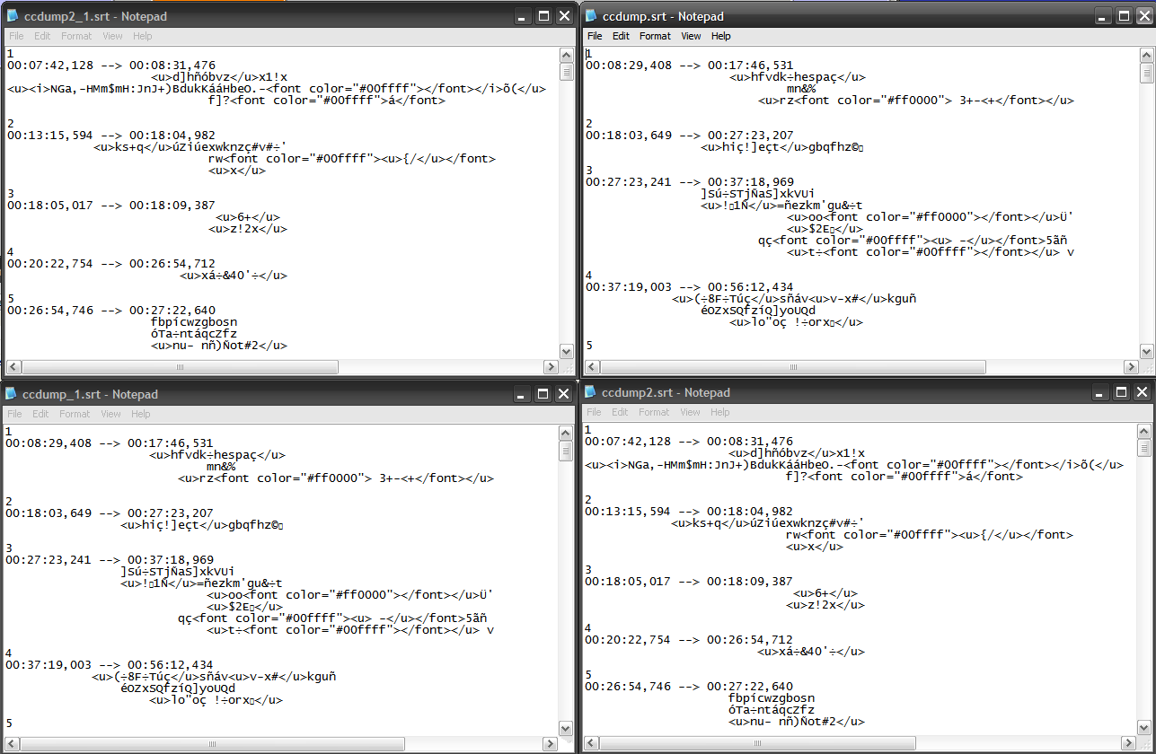

    A note about the other files you might notice in that directory. It may look like I found a way to make it work, but I have not. Many of the SRT files are empty, and others contain garbled/invalid text. See attachment.

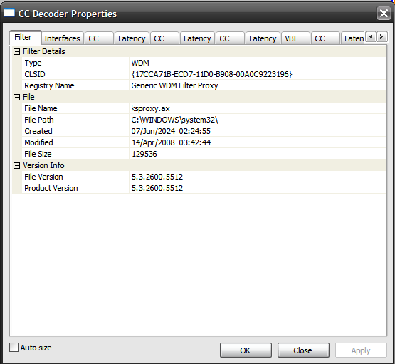

    Maybe it has to do with the version of CC Decoder? I included a screenshot of its property window if that helps.
Name:	mcpoodle cc cap two filters.PNG
Name:	srt files.PNG
Name:	cc decoder.PNG
