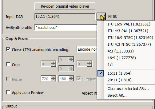

  5. For 4:3 DVDs you should generally select an appropriate ITU aspect ratio.
    Or better still, create a custom aspect ratio of 15:11, which is the display aspect ratio you get when using the mpeg4 pixel aspect ratios for both PAL and NTSC.
    https://forum.doom9.org/showthread.php?p=1058927
    4:3 DVDs generally have an ITU or mpeg4 DAR (they're virtually the same) rather than an exact 4:3 DAR.
    If you select an ITU DAR in MeGUI, it uses the "almost exact ITU" PARs from the list in the link above to arrive at the DAR it uses.
    [Attachment 79853 - Click to enlarge]

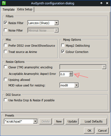

    PS. By default, MeGUI can fudge the DAR a little to make it easier to crop to an exact DAR such as 4:3. If you want to prevent MeGUI fudging the DAR (it only applies to anamorphic encoding) click on the Avisynth Profile Config button in the Script Creator and change the "acceptable anamorphic aspect error" value to zero. You can also change the mod value from mod8 to mod4, as mod8 is unnecessary.
    [Attachment 79854 - Click to enlarge]

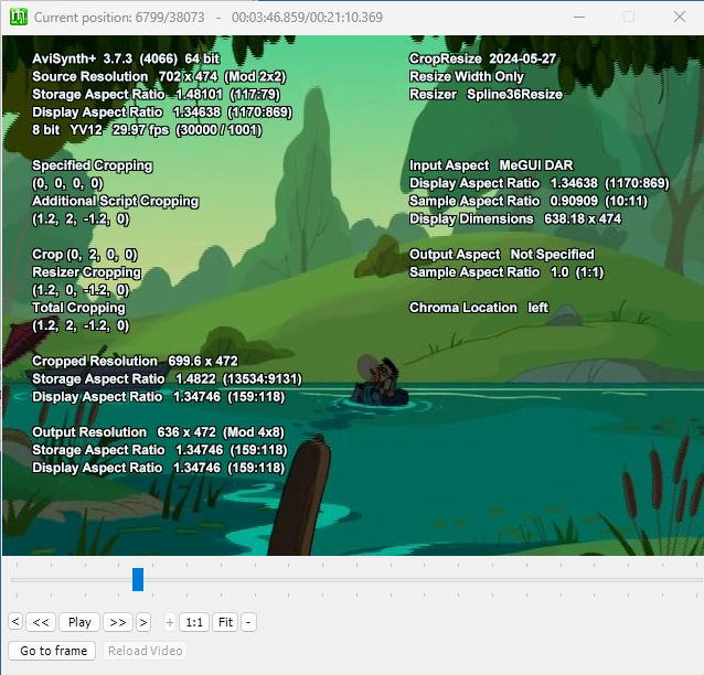

    If you want to resize you could try my CropResize function. There's a link in my signature. It supports MeGUI's global DARs in a script, so you can select your preferred DAR for the source in MeGUI, enable MeGUI's anamorphic encoding, apply whatever cropping the video needs with MeGUI and CropResize will use the MeGUI DAR to calculate it's resizing. It has a mode that ensures only the width is resized, and it'll ensure there's no aspect error. For example, after using a 15:11 DAR for the source in MeGUI and then cropping:
    global MeGUI_darx = 1170
    global MeGUI_dary = 869
    DGDecode_mpeg2source("M:\NVME2\VTS_10_1.vob.d2v")
    crop(8, 2, -10, -4)
    CropResize(ResizeWO=true, Info=true)
    [Attachment 79861 - Click to enlarge]

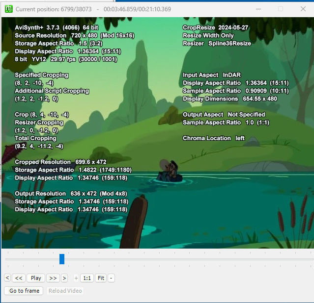

    You'd get the same result by not enabling anamorphic encoding and using CropResize to apply the cropping while specifying the appropriate input DAR.
    CropResize(0,0, 8,2,-10,-4, ResizeWO=true, InDAR=15.0/11.0, Info=true)
    or if MeGUI does the cropping you need to specify the approprate pixel/sample aspect ratio instead (because cropping changes the DAR but not the sample aspect ratio).
    crop(8, 2, -10, -4)
    CropResize(ResizeWO=true, InSAR=10.0/11.0, Info=true)
    [Attachment 79863 - Click to enlarge]

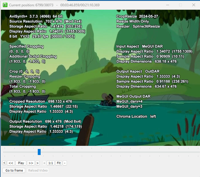

    Or if your cropping gets you close to the exact anamorphic output DAR you'd prefer and you don't mind a little width resizing, you can choose the OutDAR and CropResize will crop to that DAR. The result's similar to using MeGUI's anamorphic encoding with resizing enabled, but you can control the output DAR more easily. Whatever you use, CropResize either updates or deletes MeGUI's global variables after it's resized. You can't see it in the script, but they're updated, so MeGUI will use the correct DAR for encoding.
    global MeGUI_darx = 1755
    global MeGUI_dary = 1309
    crop(8, 2, -10, -2)
    CropResize(696,0, ResizeWO=true, OutDAR=4.0/3.0, Info=true)
    [Attachment 79862 - Click to enlarge]
