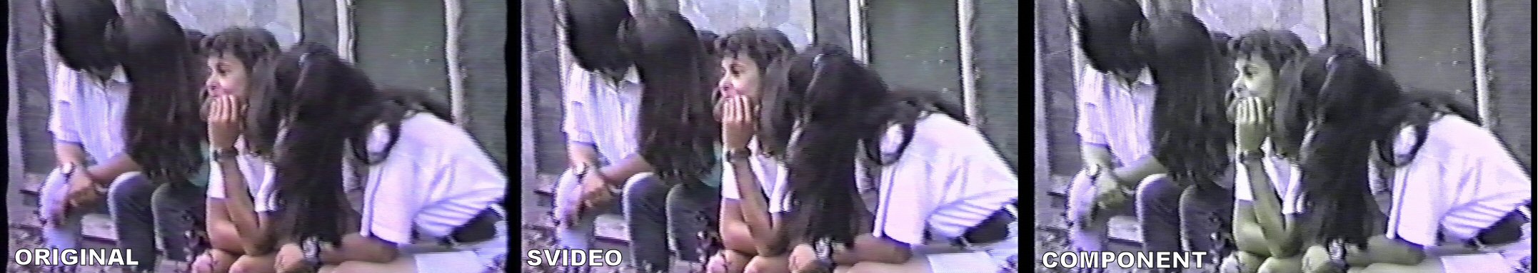

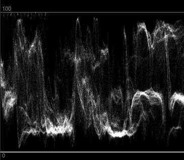

  1. I tried to use DMR panasonic as a passthru to reduce lateral skewing of old VHS tapes... this is done prefectly, but the brightness level is changed
    i use as input a composite signal (from various VCRs) and as output , composite, or S-video.. or component (this has completely wrong colors)
    i'm acquiring with 3 different cards (2 blackmagic and 1 osprey)with the same results... the input is taken too bright (or the output is too bright).. well one of them is incorrect
    this is an image about, on the left, original-signal , on center the composite (svideo is same) on right the component.
    i was thinking to reduce brightness of output on svideo adding a resistor... but before doing this i will wait for someone that maybe can help on this situation.
    [Attachment 79838 - Click to enlarge]
    so.. 2 different DRM, how is possible that panasonic has not spotted that issue? (tried also using SCART adapter.. without any success)
    tried also unsing an S-video input from a panasonic AG7350 ... but same

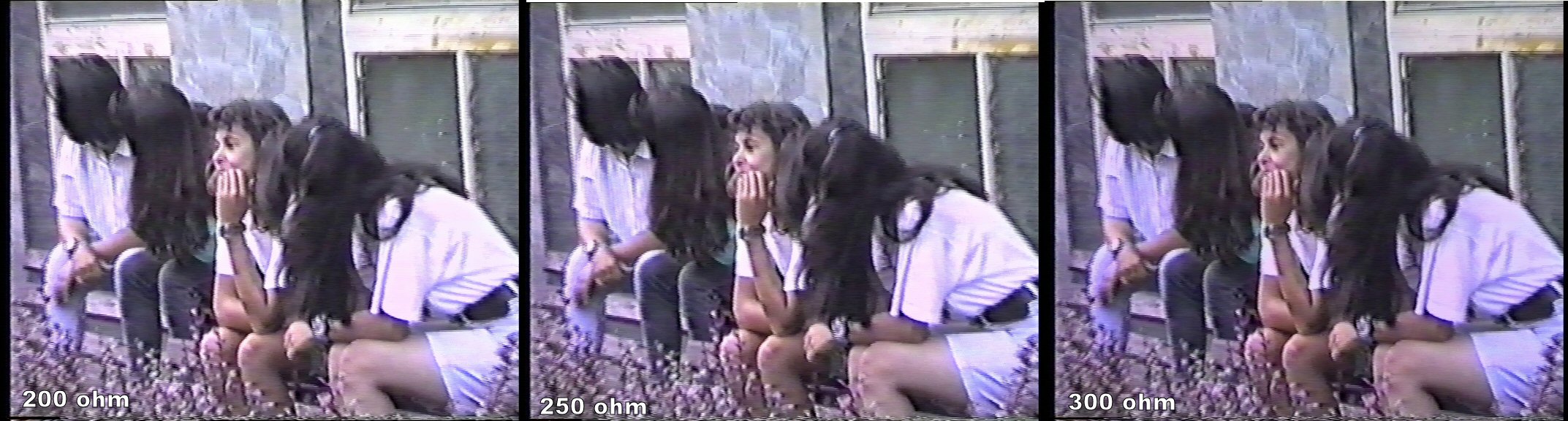

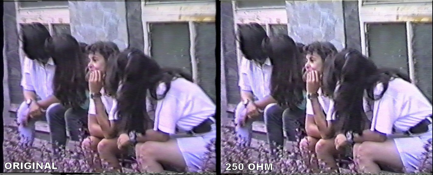

  2. meanwhile i tried adding resistance on luminance out signal...
    [Attachment 79846 - Click to enlarge]
    looks like that the brightness details are lost directly on input....
    on attachments 200 ohms 250 ohms and 300 ohms
    300ohm on right is reddish... the 250 ohm looks better..but still to bright.
    [Attachment 79849 - Click to enlarge]

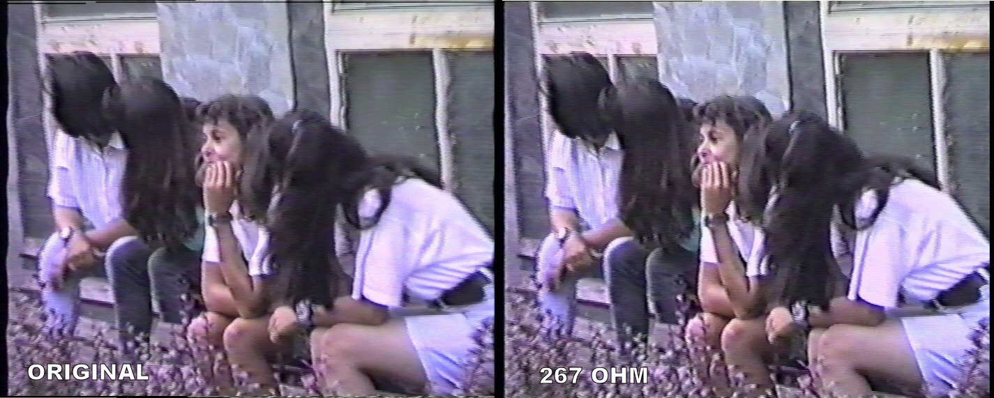

    here 267 ohms seems a little bit too much brighter

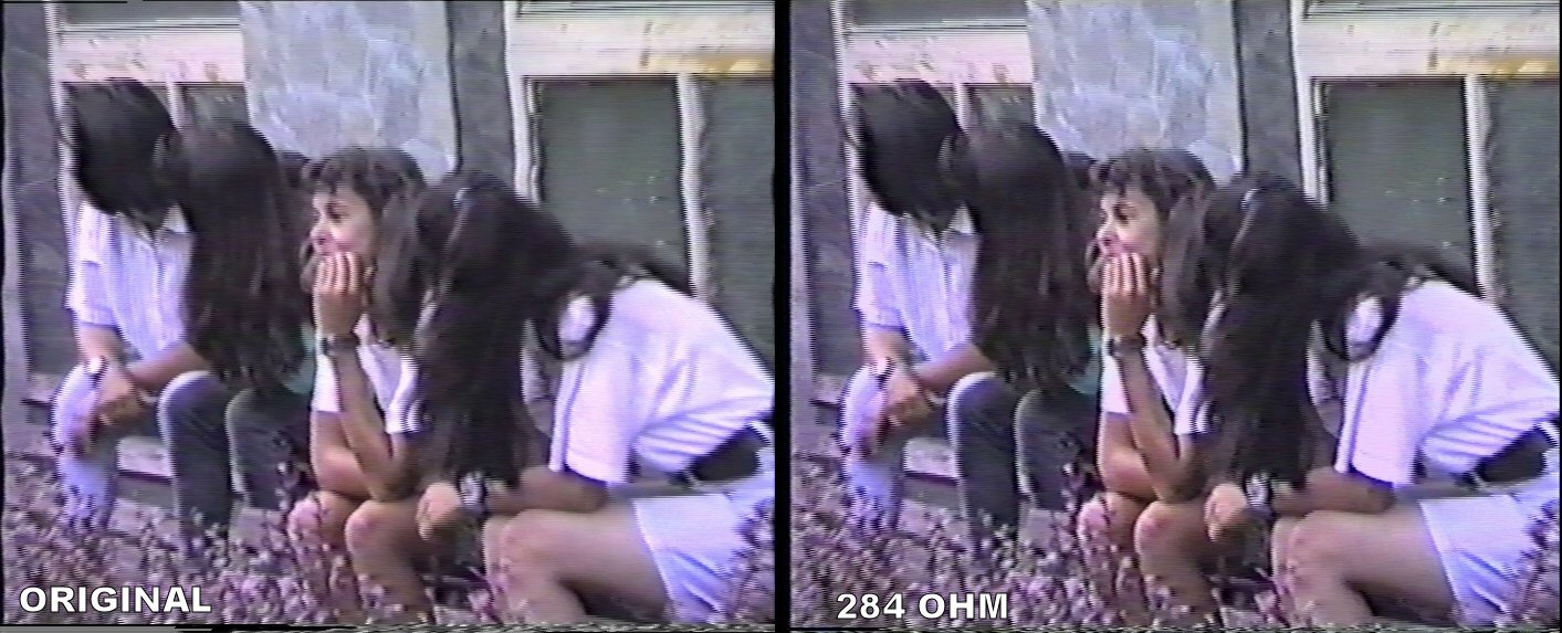

    [Attachment 79848 - Click to enlarge]
    on this one.. 284 ohm seems a little bit highter, image is again redish and maybe a little bit darker.. maybe with 278/280 ohms...
    probably i need to reduce a bit the source signal and a bit the output signal... (both)

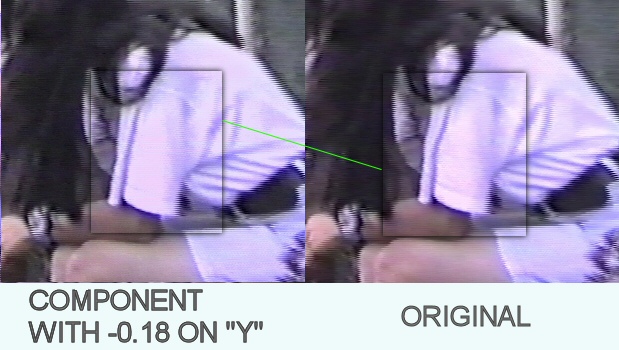

  4. (fixed the issue on component output.. one of the connector was oxided)
    tried with software arrangments (lowering Y by 0.18 / 0.20 ) on the Blackmagic cards (just to have same brightness)
    but some details are completely vanished( on high brightness spots )
    [Attachment 79865 - Click to enlarge]
    look at the t-shirt....
    using a fully recapped AVE5 from panasonic these detailes are grabbed correctly by the card... (but i hate the AVE5 because it cut edges of the signal making some sort of unwanted zoom)

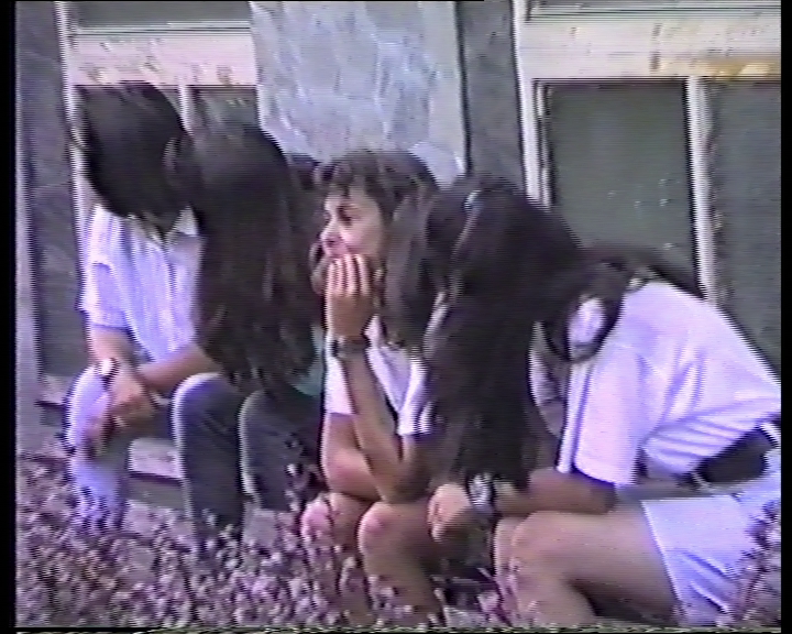

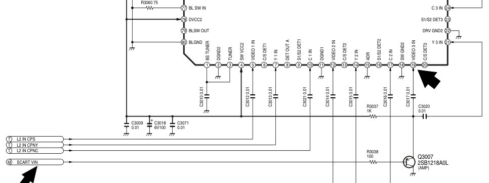

  6. going crazy with these EUROPEAN DMR units....
    just bought another DMR .. and still the same, connecting a VCR (any kind) to all the inputs of DMR , is making an output (passthrough) with a change on contrast (white spots become bigger... loosing some light-grey details around white)
    searched for service manual.... but it's showing
    just a 100 ohms resistor (R3038) and a transistor 2SB1218A0L (Q3007) before the VIN on the main C1AB00001918 ( also a cap C3017 0.01 )
    basically the video signal is entering immediately on the IC3001 (C1AB00001918 ) and there is nothing to set on EUROPEAN firmwares to change the "amplification/contrast/brightness" of the video input.
    [Attachment 80439 - Click to enlarge]
    Sep 2022
    Bavaria
    you have to reduce the brightness before the signal goes into the Panasonic DMR.
    Here in german language:
    https://gleitz.info/forum/index.php?thread/47744-tipp-digitalisieren-%C3%BCbersteuerte...eer#post464769
  8. Originally Posted by Bogilein View Post
    Just made the "attenuation" filter, the signal become darker (and a little bit reddish).. the details are now grabbed correctly, but also using the Blackmagic acquisition Luma change ( +0.39 ) i can restore the brightness , but due to the "hardware filter" there is also a missing contrast... the final result is lacking contrast.

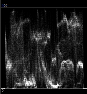

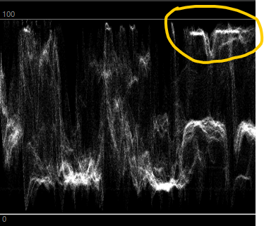

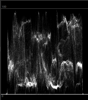

  13. The brights get crushed somewhere. EH55 input overload?
    Original picture
    [Attachment 83329 - Click to enlarge]
    S-Video picture
    [Attachment 83330 - Click to enlarge]

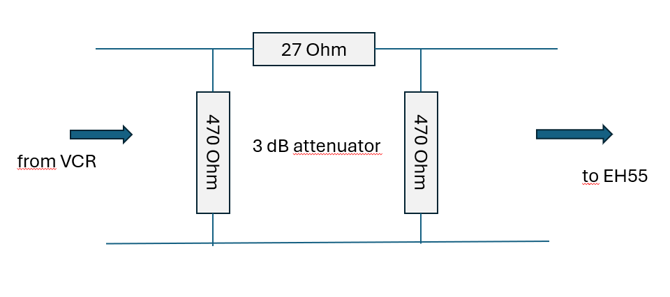

    You may want to try with this attenuator between the VCR and the DMR-EH55:
    [Attachment 83331 - Click to enlarge]

    @Sharc, in your attenuator, assuming an SVideo connection, is the top path (with the 27ohm resistor) the luma, and the bottom path the Chroma?
    And for a Composite connection, would the top path would be the centre pin of the cinch cable?
  17. Originally Posted by Alwyn View Post
    TOP: Luma (pin 3 of the 4-pole S-Video mini-DIN aka Hosiden connector, or pin 19 of the VCR SCART out)
    BOTTOM: Luma return, aka "Ground/shield/screen", (pin 1 of the 4-pole S-Video mini-DIN aka Hosiden connector, or pin 17 of the VCR SCART out)
    Yes. For composite the value of the attenuation is more critical as luma and chroma are attenuated. One might have to increase it experimentally to say 6dB to "disable" the AGC of the DMR.

  19. Main design aspects:
    - It should be purely resisitve in the MHz S-video range
    - It should be highly linear (to avoid nonlinear signal distortions)
    - It should preferably present a 75 Ohms terminating impedance to avoid signal reflections
    Added:
    A "high impedance" termination at the VCR side may worst case drive the output of the VCR into the clipping (6dB voltage step-up, voltage doubling) which cannot be recovered by subsequent attenuation. Depends on the VCR design.

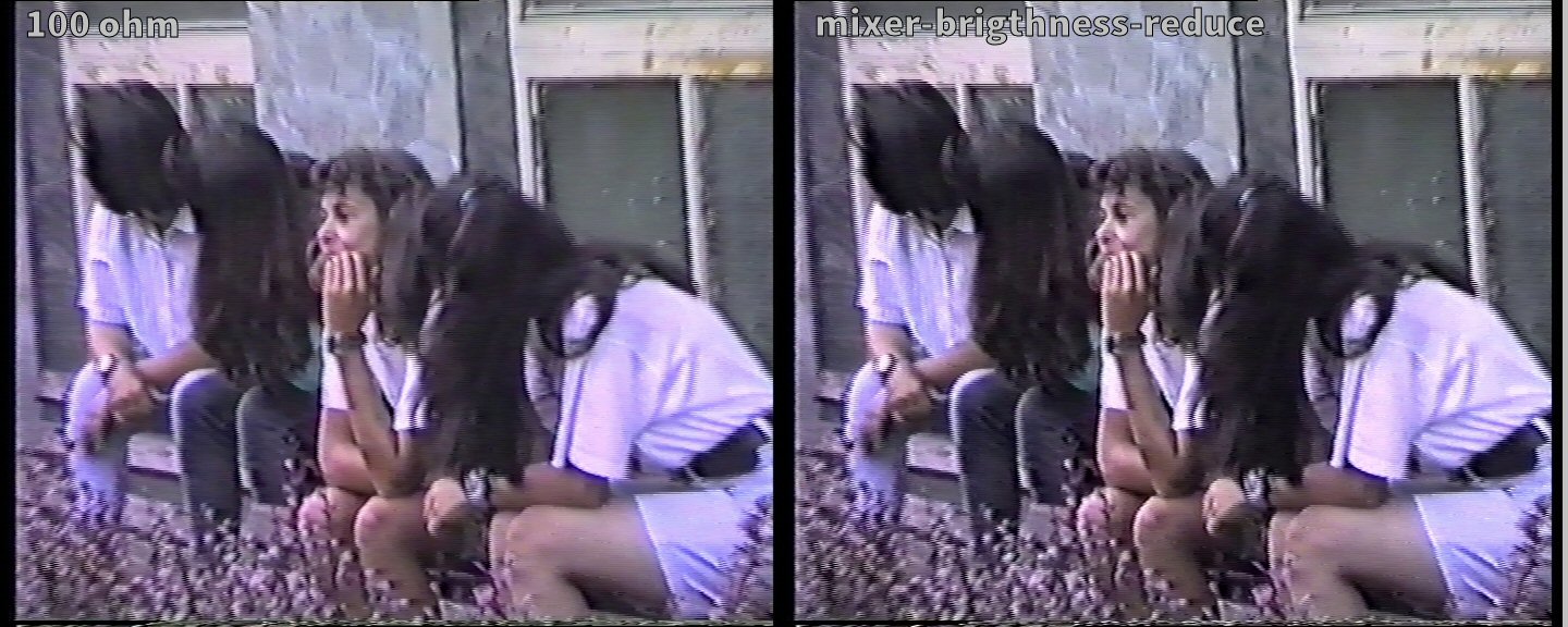

  20. tried with a "vivanco" video mixer VCR3046 (a small mixer for hobbyist ) to reduce brightness of the original source (this is what i do often in software post-processing)
    on the results the details are present.. but i'm very worried about a quality loss... these units can change colors/contrast/sharpness/etc.,.etc.. and the signal is processed a lot.
    here 2 images.. both from ES10... but on the second one the vivanco i present to reduce brightness.
    can be possible to see the exact issue on BLACK SPOTS.

  21. It looks about correct to me now. The bright details are preserved now, no clipping. Maybe you want to increase the gamma slightly to expand the darks a little.
    [Attachment 83665 - Click to enlarge]
  22. this is a medium brightness

  24. Originally Posted by Bartoloni View Post
    Looks ok to me as well, no clipping, no loss of details. It's all within personal preference.

  25. is just me or everything is going to purple/pink using a resistive attenuator?
    using a pulldown reisstor of 100 ohm details are appearing... but there is a way to have a spectral analysis of the image to udnersatand if the red is increasing?
    the single second image is usign just a resistor from signal (composite) to GND
