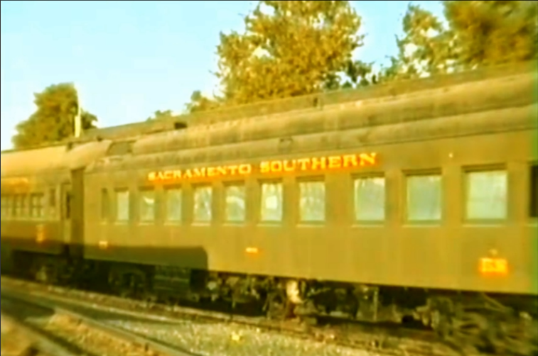

    Sorry, I couldn't attached those problem sections of video here. I only attach their screenshots/screencaptures here.
    1) The screen is not clear. It only happens occasionally, not throughout the whole video.
    2) Rail cars are yellow in color. There is a vertical blue margin on the right of screenshot. The aforesaid margin always happens throughout the whole video
    Regards

  6. @satimis
    Railway color: Are you sure it should be "yellow"?
    Quickly using color wheels: Is this any better? I doubt.....

  8. Originally Posted by satimis View Post
    Please advise how to apply it to a section of the video?
    I think it is similar for all NLEs/editors: Split the video in sections using the timeline. Every section can be individually edited.
    Or set keyframes/markers and apply transitions.
    Study the help documentation of your editor(s).
