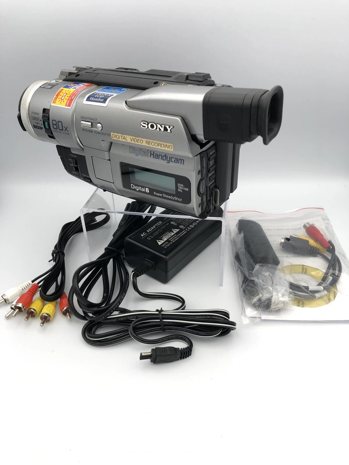

    Just found on eBay;
    Sony PAL Handycam Camcorder Standard8/Hi8/Digital8 Video Transfer (DCR-TRV110E)
    https://i.ebayimg.com/images/g/xqsAAOSwJsxlgAjE/s-l1600.webp
    from UK.
    Please advise can it work for my purpose, ripping V8 tapes to PC as .mp4 files? I'll contact the seller later after having received your advice.
    Thanks in advance.
    Regards
  6. Originally Posted by satimis View Post
    Hi Sharc again,
    Just found on eBay;
    from UK.
    Thanks in advance.
    Regards
    Here's the manual
    https://www.sony.co.uk/electronics/support/camcorders-tape-camcorders/dcr-trv110e/manuals
    on page 10:
    Your camcorder records and plays back pictures
    in Digital8 system. Also, your camcorder plays
    back tapes recorded in the Hi8 /standard 8 (analog) system.
    Image Attached Thumbnails TRV110E english.pdf
