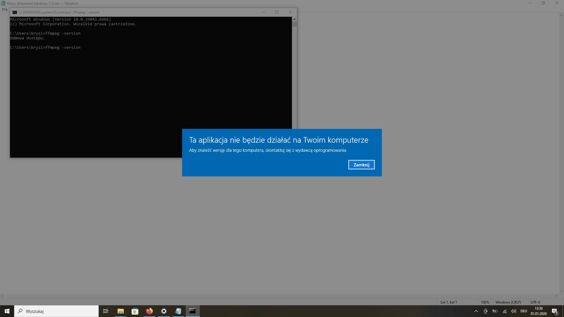

  3. ffmpeg not working with Windows 10 Home installation problem
    [Attachment 90564 - Click to enlarge]

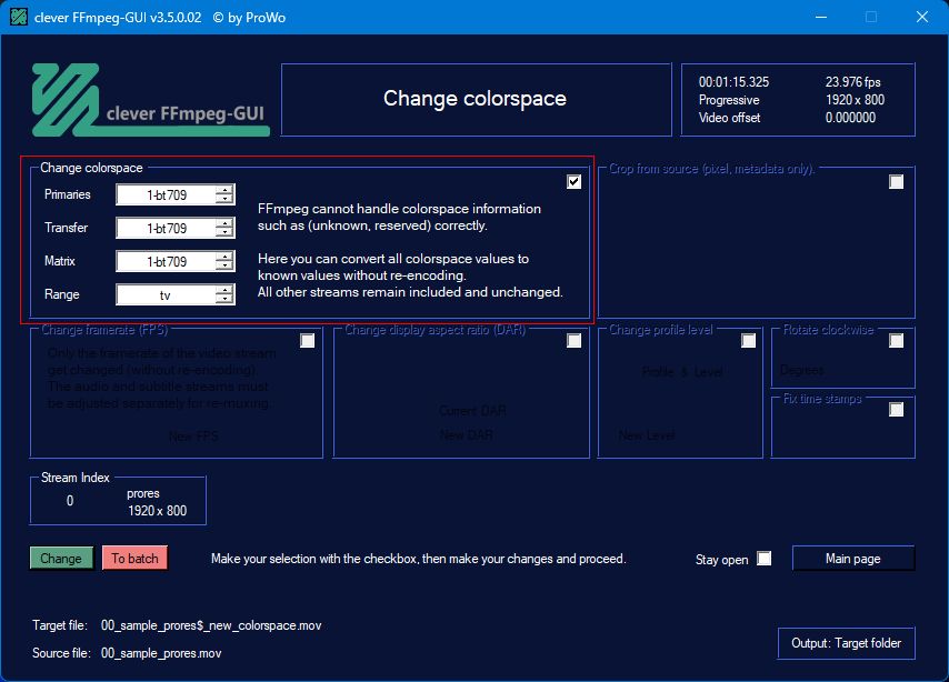

  4. Originally Posted by DanMalik View Post
    I'm trying to convert the video to mp4, but it seems that ffmpeg is not able to infer colorspace value (could be something else too), which seems to be "unknown". I've attached the file containing frame details. I'm not an expert, but I've tried explicitly setting the color values (color_space, color_primaries, color_transfer), but still faced the same issue. Faced similar issue with some other videos too. I'll be grateful if someone can help me with this
    You can use clever FFmpeg-GUI to change the colorspace lossless, without reencoding.
    Load your mov, click lossless changes, check change colorspace.
    Make your settings and click change.
    Done.
    [Attachment 90566 - Click to enlarge]

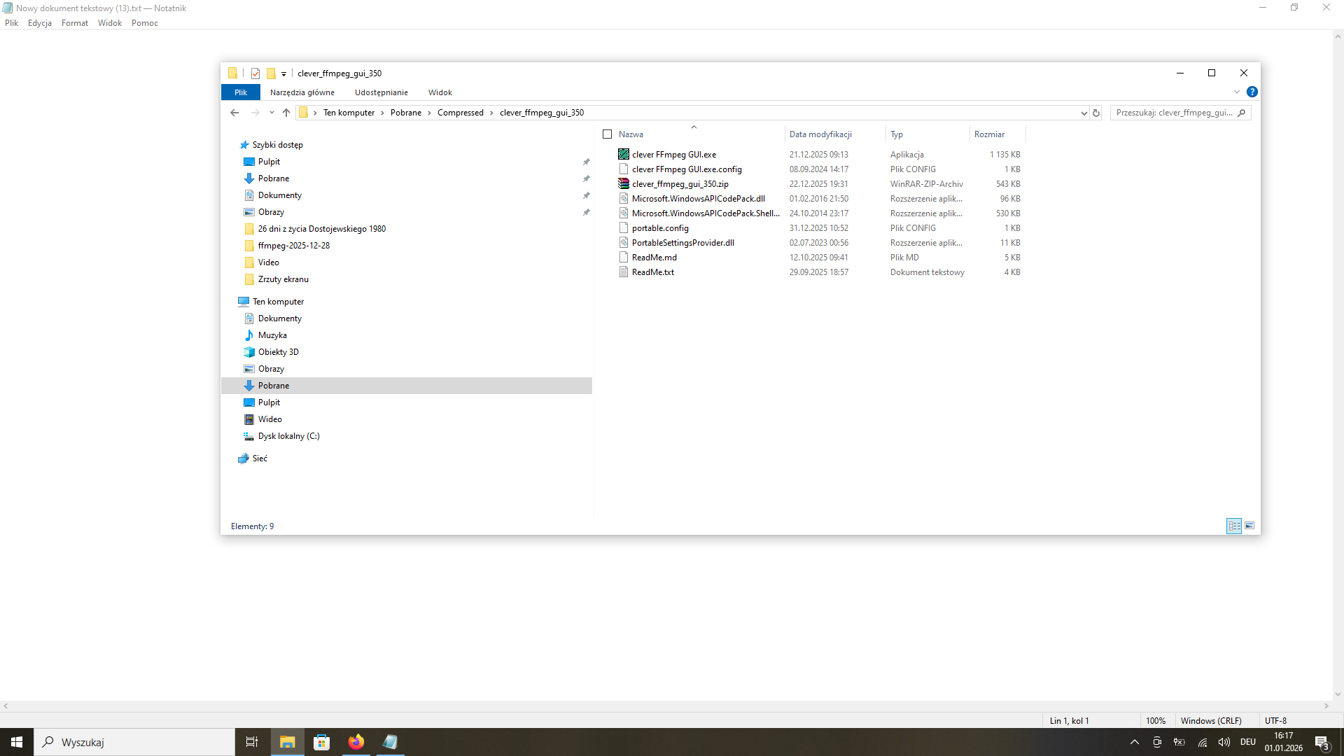

  5. I'm already familiar with this program because I was extracting audio from my movie and combining it using Video to Video, but the audio wouldn't sync. At the beginning of the movie, the audio was synchronized fine, but after 20 minutes, the video was faster and the audio slower.
    But the clever FFmpeg-GUI works with my FFmpeg – it opens in the FFmpeg-bin directory.
    [Attachment 90568 - Click to enlarge]
  6. Originally Posted by Henryk69 View Post
    You should not unzip the clever.zip into the ffmpeg folder. Extract it somewhere else.
  7. Originally Posted by Henryk69 View Post
    You have to ckeck, if your windows is 32bit or 64bit.
    On a 32 bit system you must use a 32bit ffmpeg release.

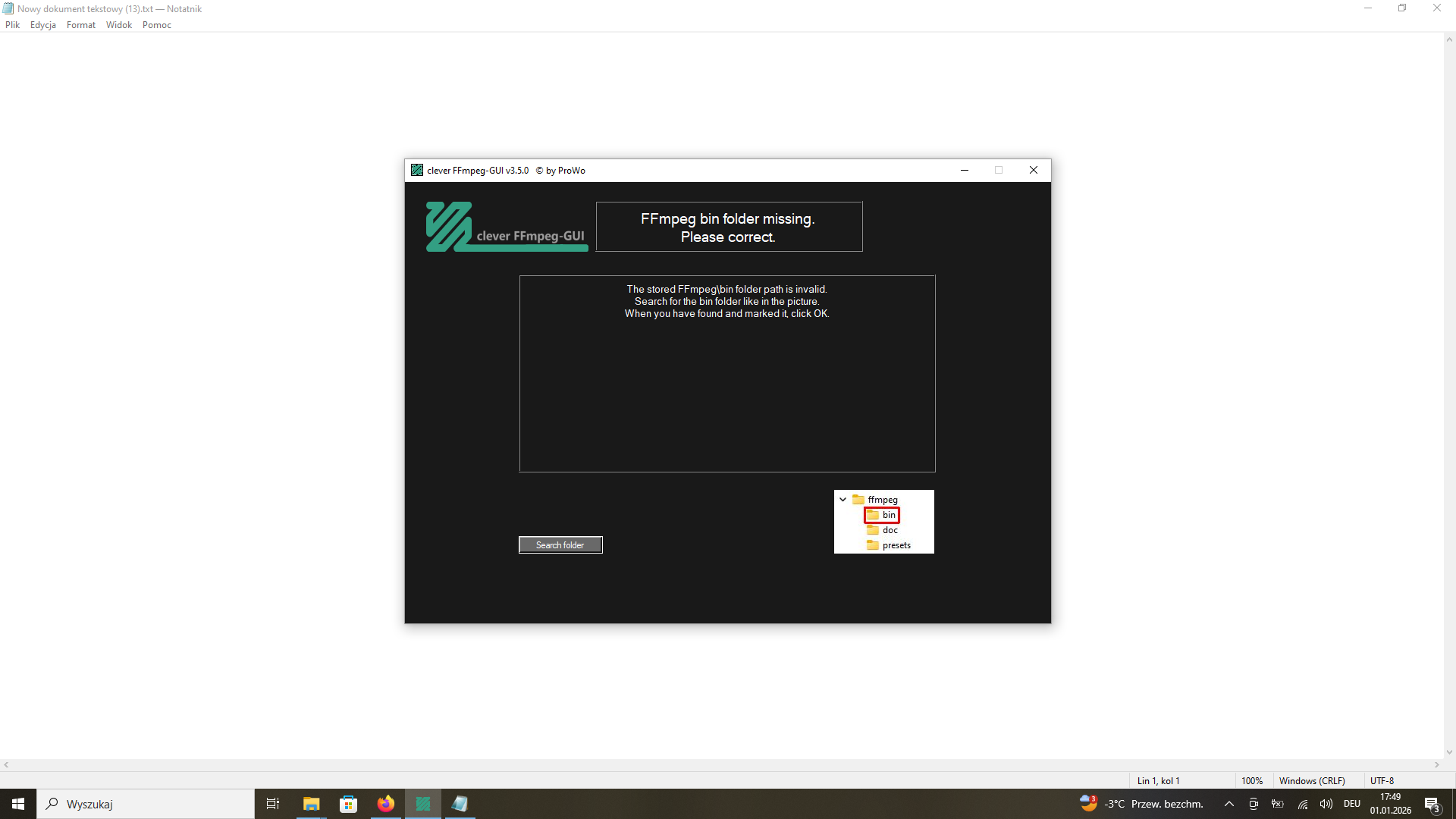

  8. But after unpacking clever FFmpeg-GUI and running it asks me for the bin folder
    [Attachment 90571 - Click to enlarge]
  9. Originally Posted by Henryk69 View Post
    Yes, click search folder, locate the ffmpeg bin folder and click ok.

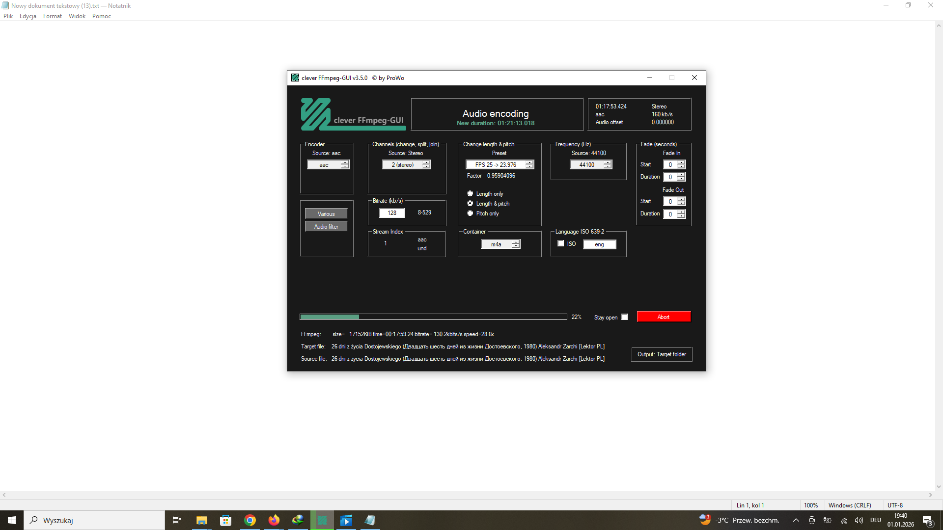

  12. How do I change from 30 FPS to 24 FPS? As shown in the image.
    [Attachment 90881 - Click to enlarge]
    [Attachment 90882 - Click to enlarge]

    You should first describe exactly what you want to do.
  14. I have two identical videos: the first is 30 fps at 01:26:23, poor image quality, and the second is 24 fps at 01:31:12. I want to extract the audio from the first one, which has 30 frames, and insert it into the better quality one, which has 24 frames.
    [Attachment 90883 - Click to enlarge]
    [Attachment 90884 - Click to enlarge]
  15. Originally Posted by Henryk69 View Post
    The prerequisite is that the two videos are exactly the same.
    Load your 30 fps video (poor image quality), click encode audiostream.
    Select the encoder and the bitrate, at change length & pitch select the custom preset, check calculate with time, insert 01:31:12 in the time field, click OK and click encode.
    [Attachment 90885 - Click to enlarge]
    If finished, click multiplex.
    Drag the 24 fps video into, on the left select his videostream and the new created audiostream (in another color), deselect all other streams, set the container (mp4 or mkv) and click multiplex.
    Done
