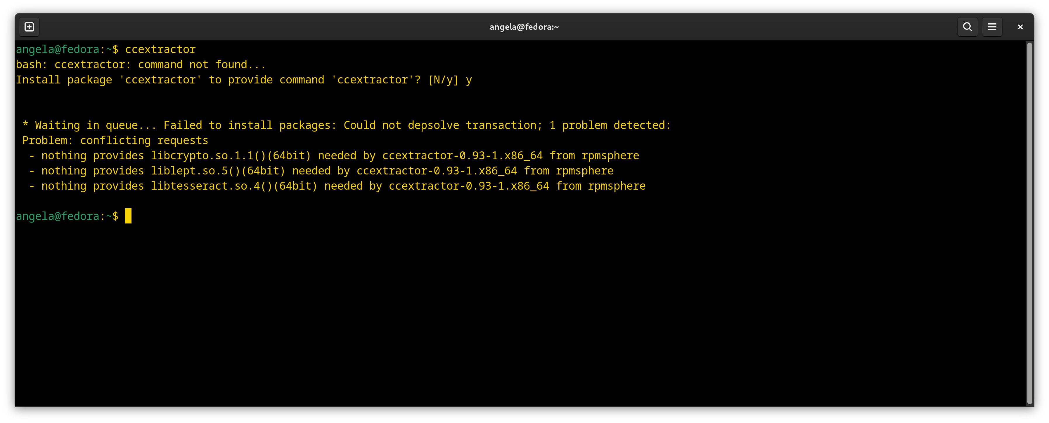

    Originally Posted by PSXman_uk View Post
    Anyone know how to get ccextractor to compile in Fedora please ive done all the rest of the required apps but cant get this to compile and cant find anything on the web about it
    Hi PSXman_uk
    Did you manage to succeed with this?
    Noob Starter Pack. Just download any Widevine media! Over 25,000 downloads for V6!.
  3. What exactly is the problem? What version of Fedora are you using? (I've succeded to compile it on MacOS, and that's usually harder to do than compiling on any Linux with quite current software.)
    Feb 2022
    Search the forum first!
    It will NOT compile on Fedora despite installing dependencies as recommended. It simply won't. My question was to PSXman_uk, primarily, to see if he needed further help;
    I no longer have Devine installed, but I did find a solution for the last Fedora release which involves adding a repository which had a pre-compiled version of ccextracror and making symbolic links to libraries.
    cc_extractor is rather poorly written to accept only a specific library version - later versions are ignored. See the problems: All those libraries are indeed installed - but later versions.

  5. libcrypto - I don't see why that is needed; if it is indeed, then yes, libcrypto-1.1 is a poor dependency nowadays. Probably because of a libcurl dependency.
    The same holds for liblept and tesseract-4 - these dependencies are definitely not bound to that version.
    Here on my Mac it uses:
