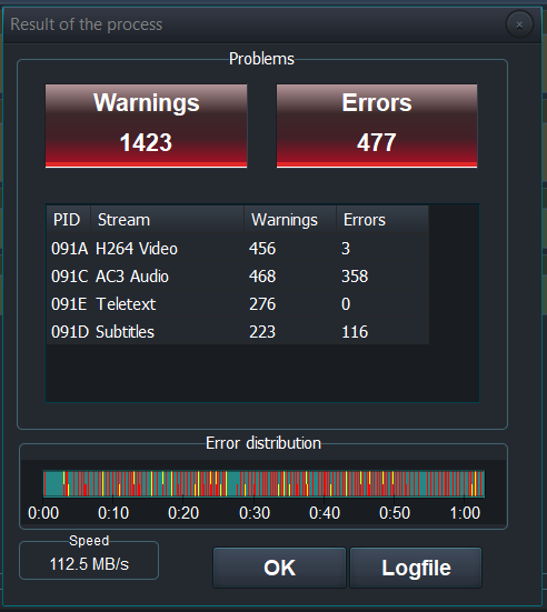

I have opened the video file with TS Doctor and attached a screenshot along with some logfiles.

I have not used TS Doctor before now and am not really sure how best to interpret these results.
Too many errors. Creating a "fixed" file will not help.
