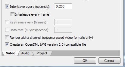

    In my Vegas I can only find Lossless Avi. But I am not sure which options I need to choose here on its panel:
    [Attachment 79748 - Click to enlarge]
