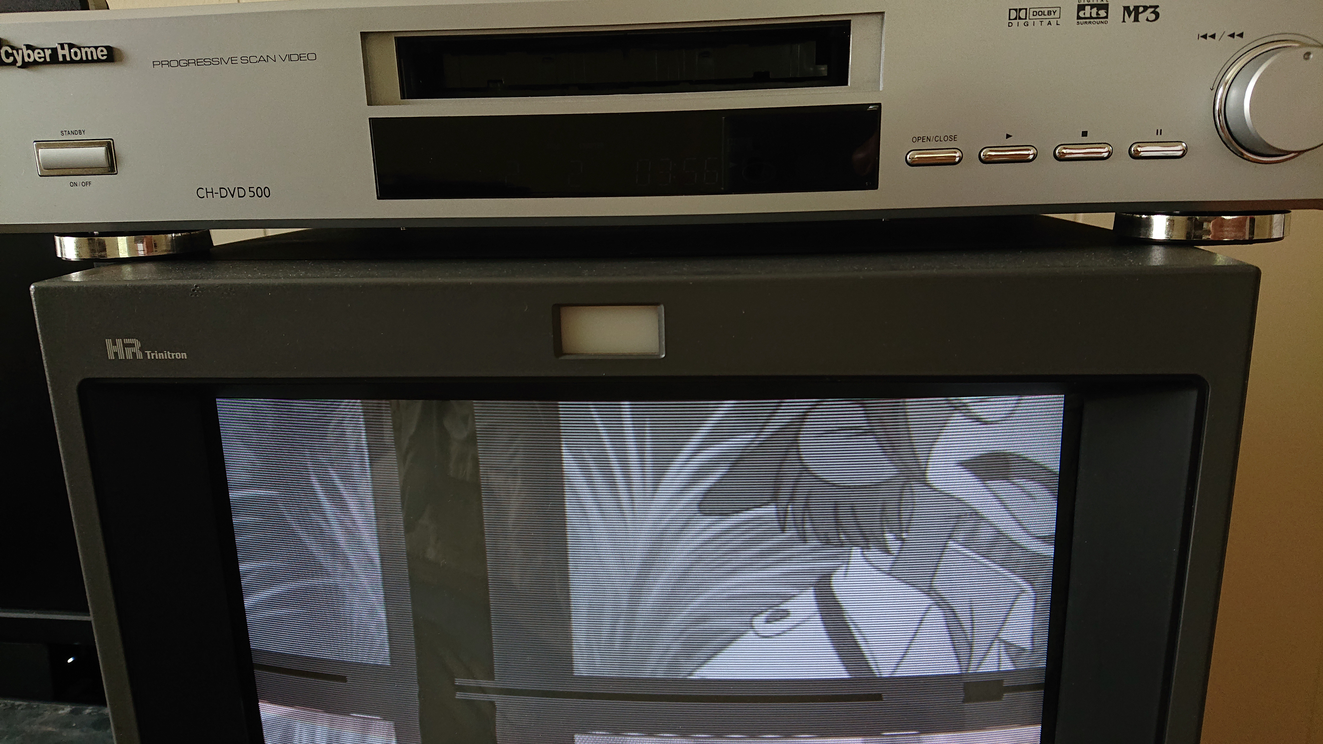

    I picked up 2 CH-DVD 500s on eBay, one for parts and the other "tested and working." It wasn't, so I got my money back and had 2 broken players for the price of a single parts machine. I did this knowing the power supplies would need repair. Got one of the power supplies going with new capacitors, then found the IDE DVD drives were both dead. Not surprising, as CyberHome was not a quality brand. I believe these were only $70 in 2002 prices when new. Fortunately being PC IDE drives, I tried a few spares I had on hand. Pioneer and HL brands work more or less perfectly.

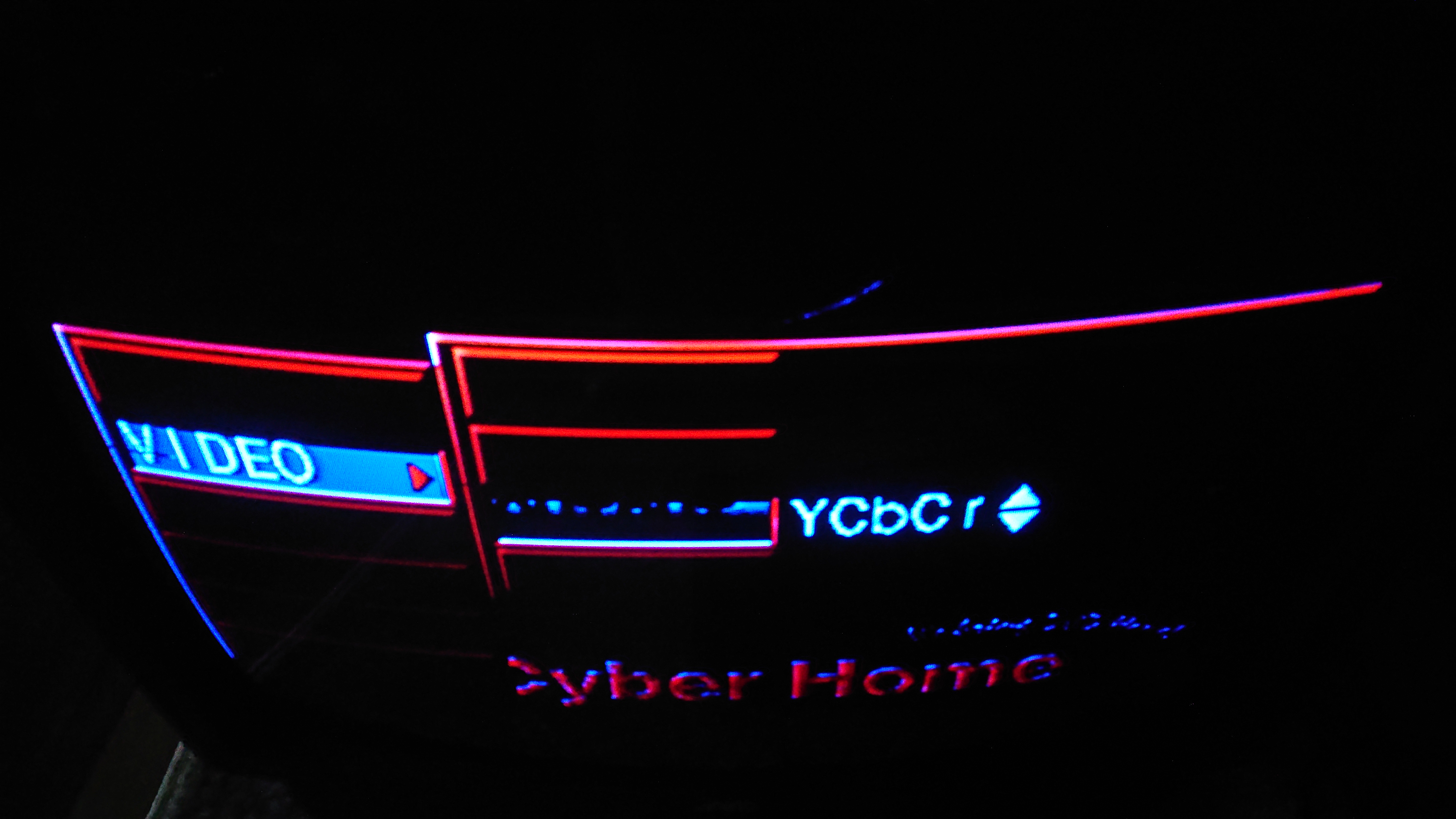

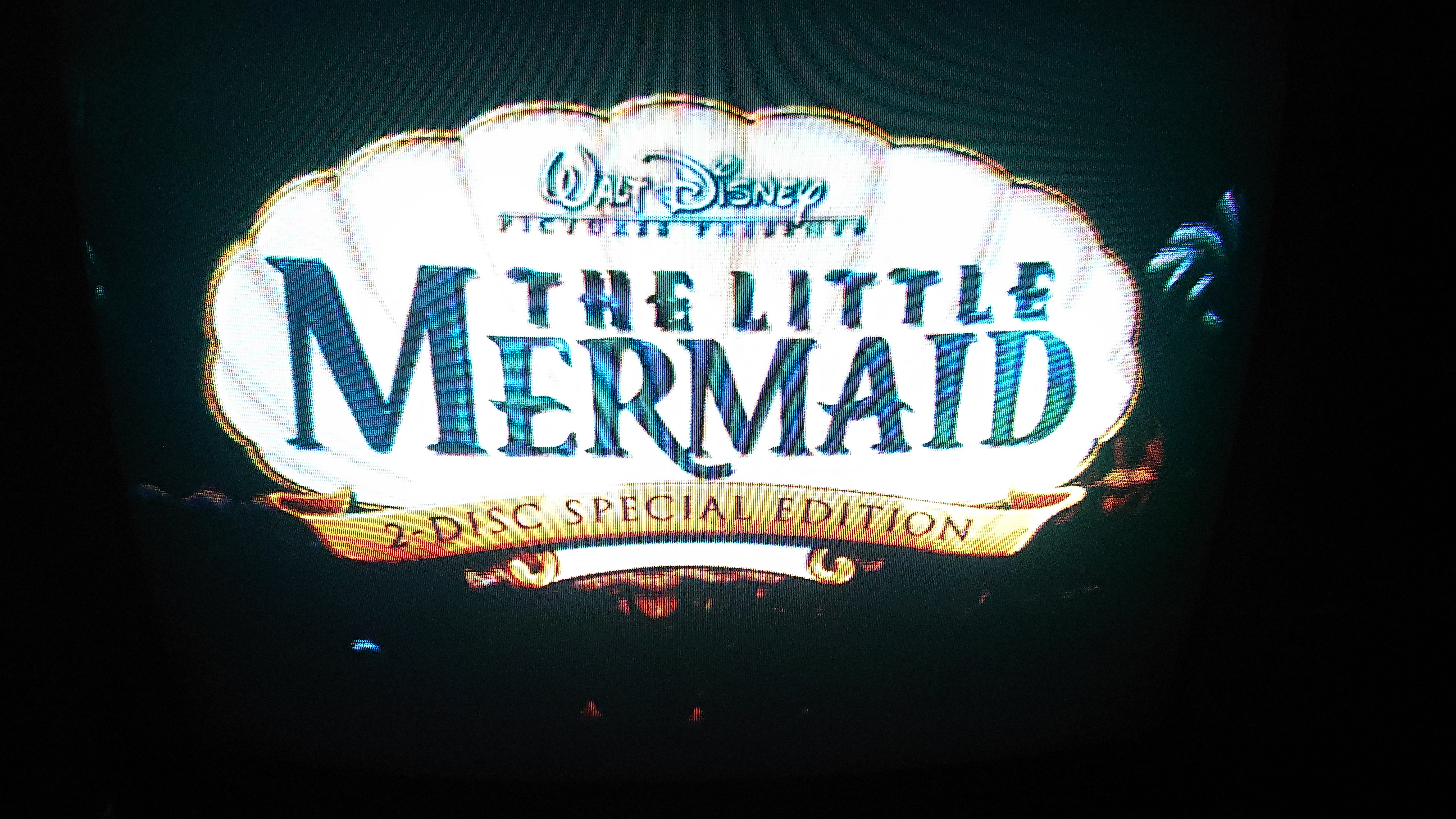

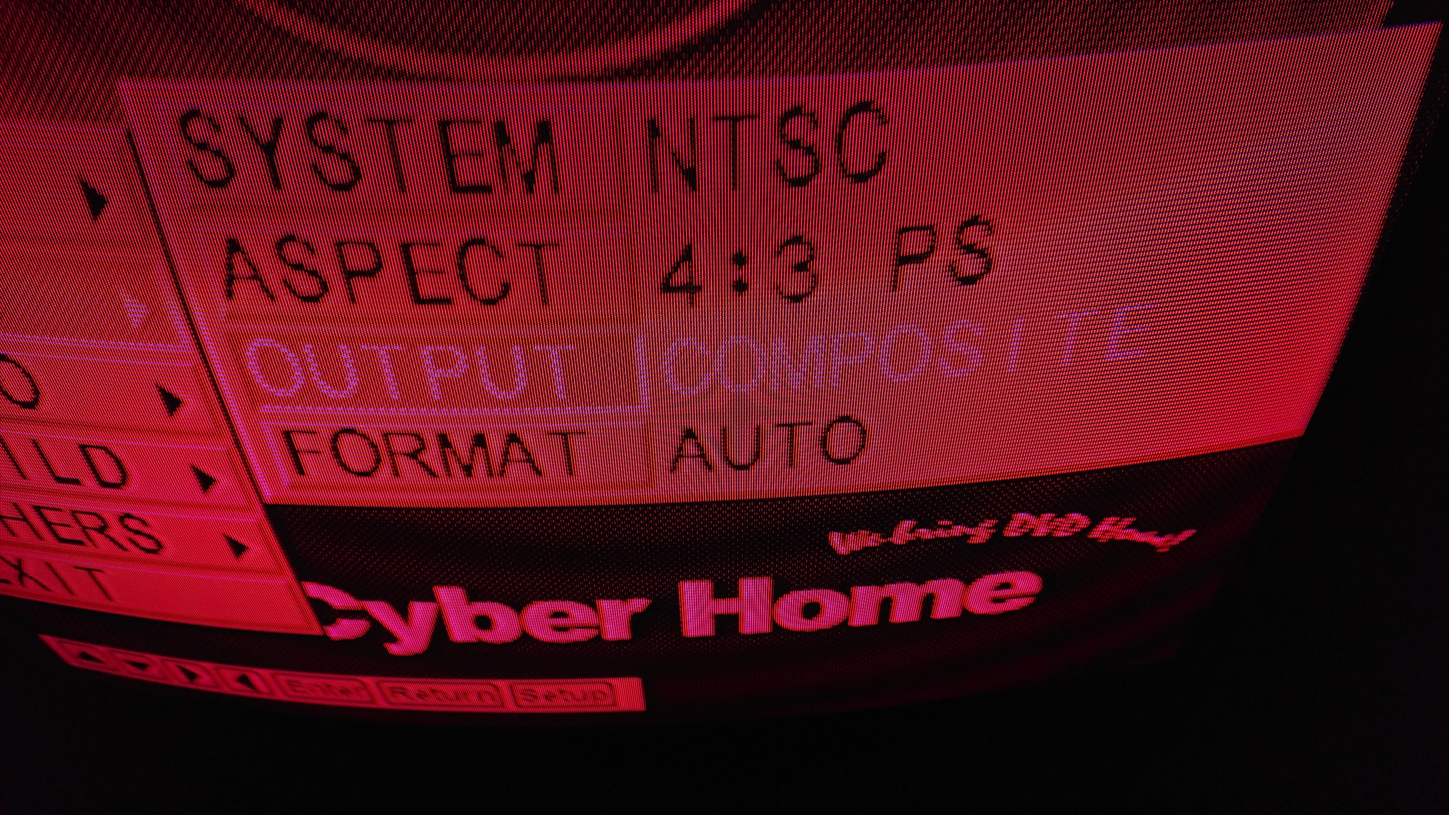

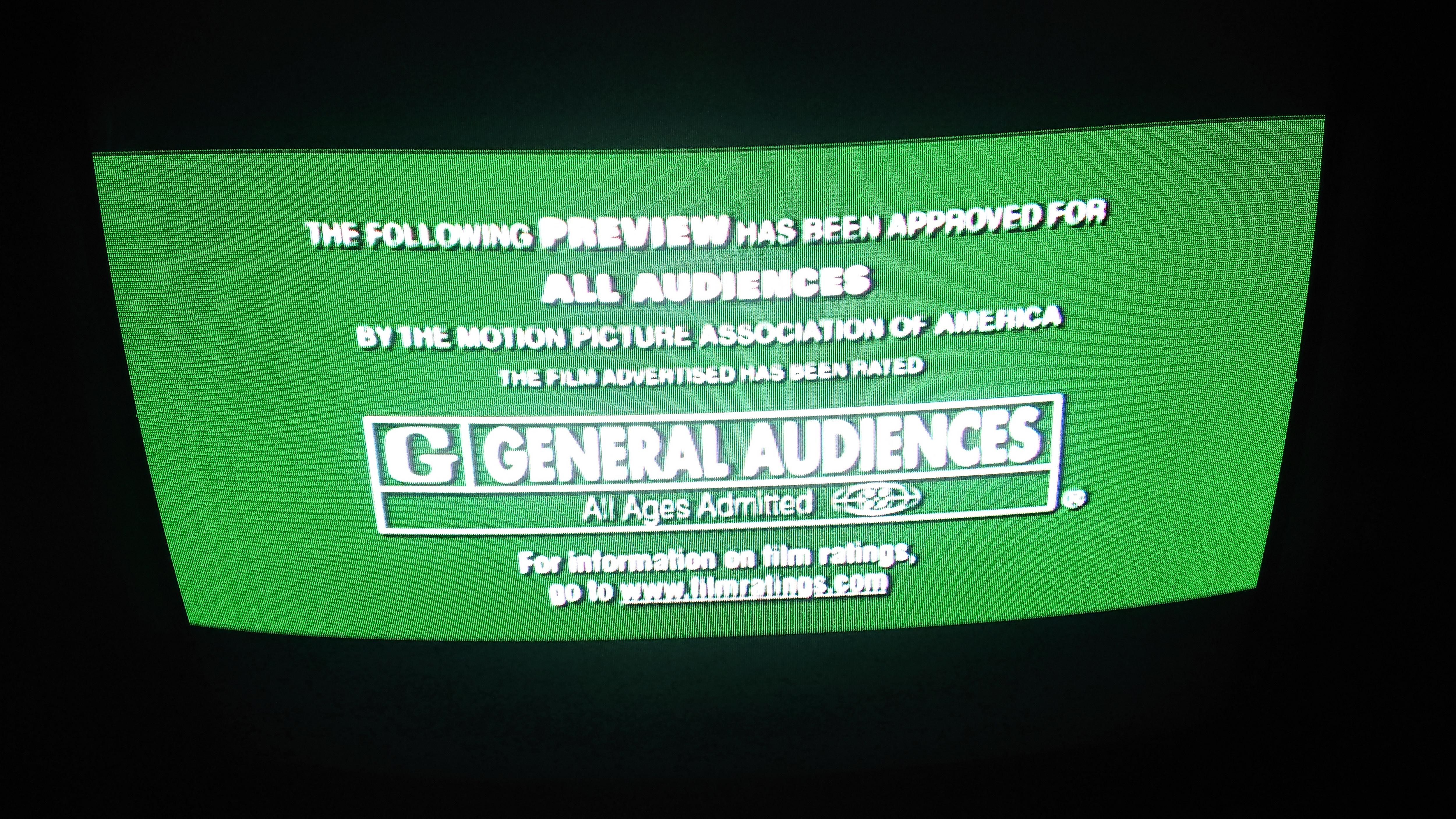

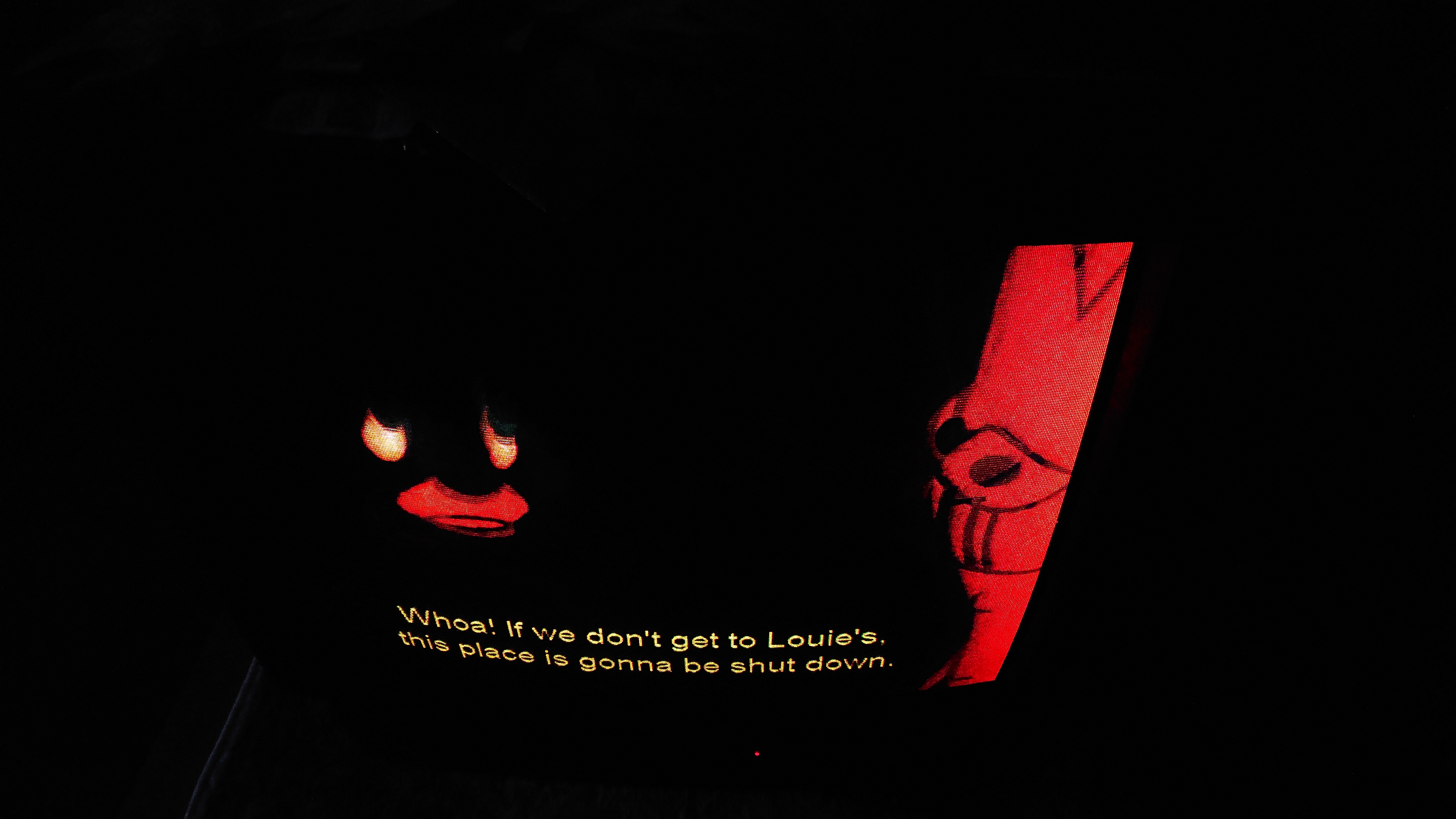

    With the replacement drive sorted I tested the Macrovision trick. The process is playing the DVD, stopping it, entering the setup menu, changing the region or video output, then changing the setting back. When you resume playing, Macrovision will be gone. Then the picture looks fine! Ignore the pink screen in the photos, that is caused by the component converter not liking the player's menu screen for some reason (probably because it's a $35 converter).
    The Macrovision killing exploit persists throughout chapters, titles, and even when going back to the menu. The player will check for Macrovision again and turn it back on if you leave it stopped for too long. I also used a Sony PVM monitor in its HV delay mode to confirm the Macrovision pulses were no longer there.
