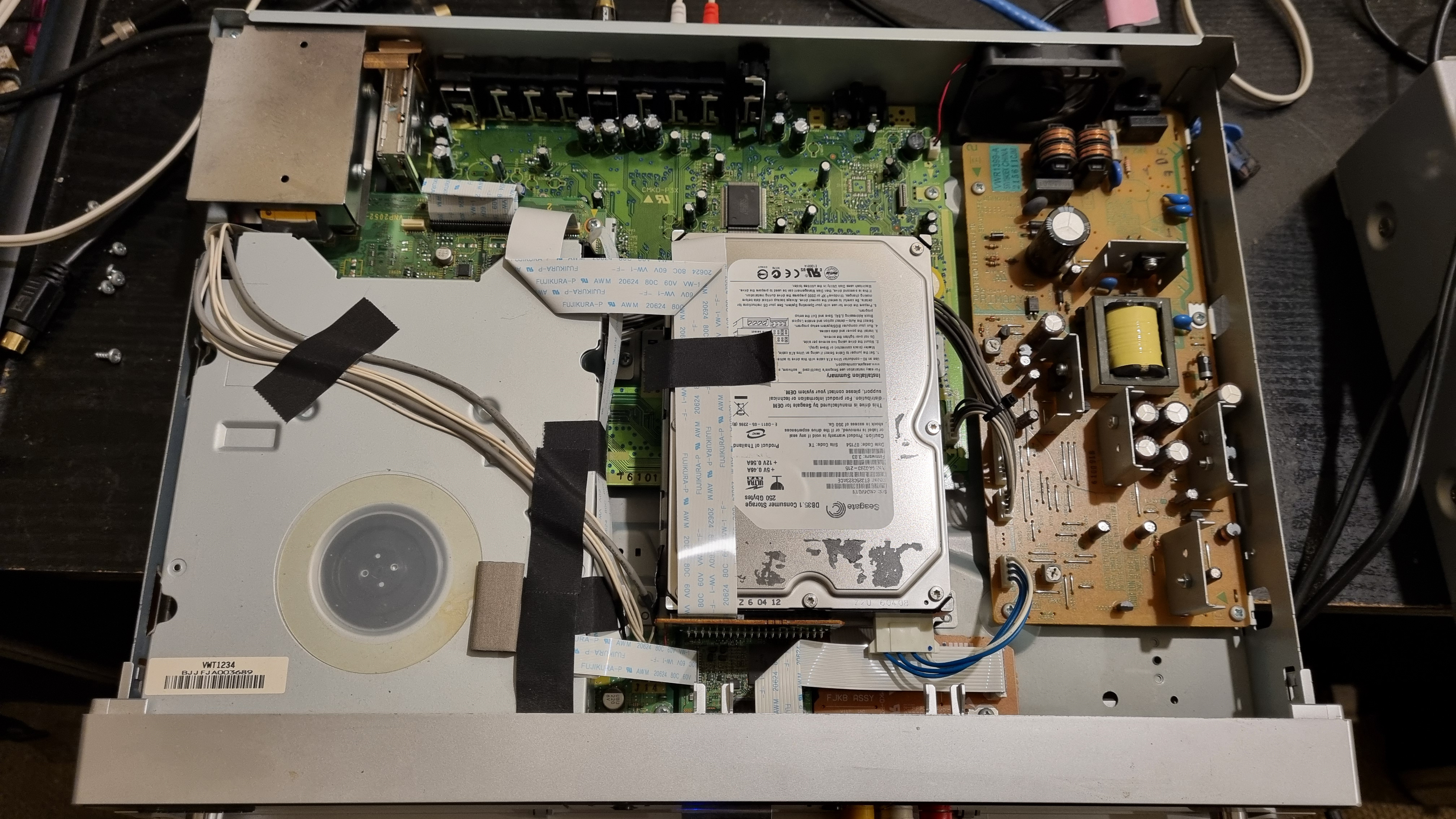

Innards pic:
[Attachment 79568 - Click to enlarge]

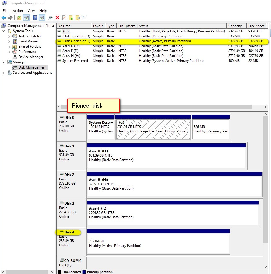

ISO Buster in action a couple of years ago on the HDD from my 645 (this would have been Windows 10, early version):
HDD in Windows Disk Management:
[Attachment 79581 - Click to enlarge]

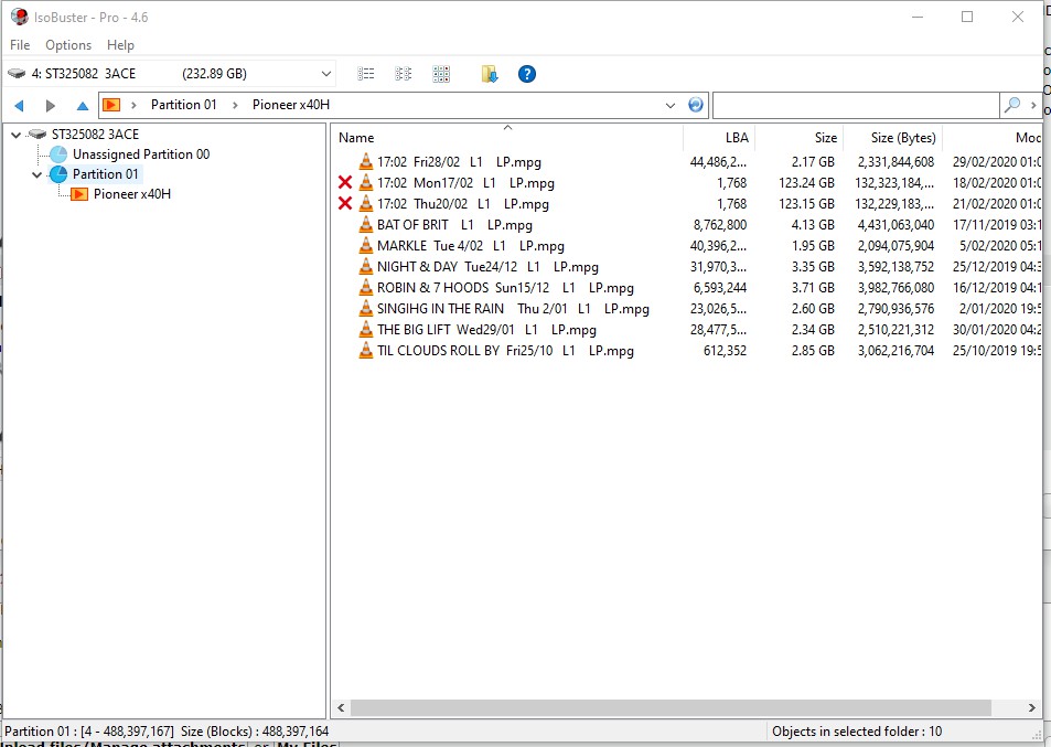

ISOBuster:
[Attachment 79582 - Click to enlarge] -
