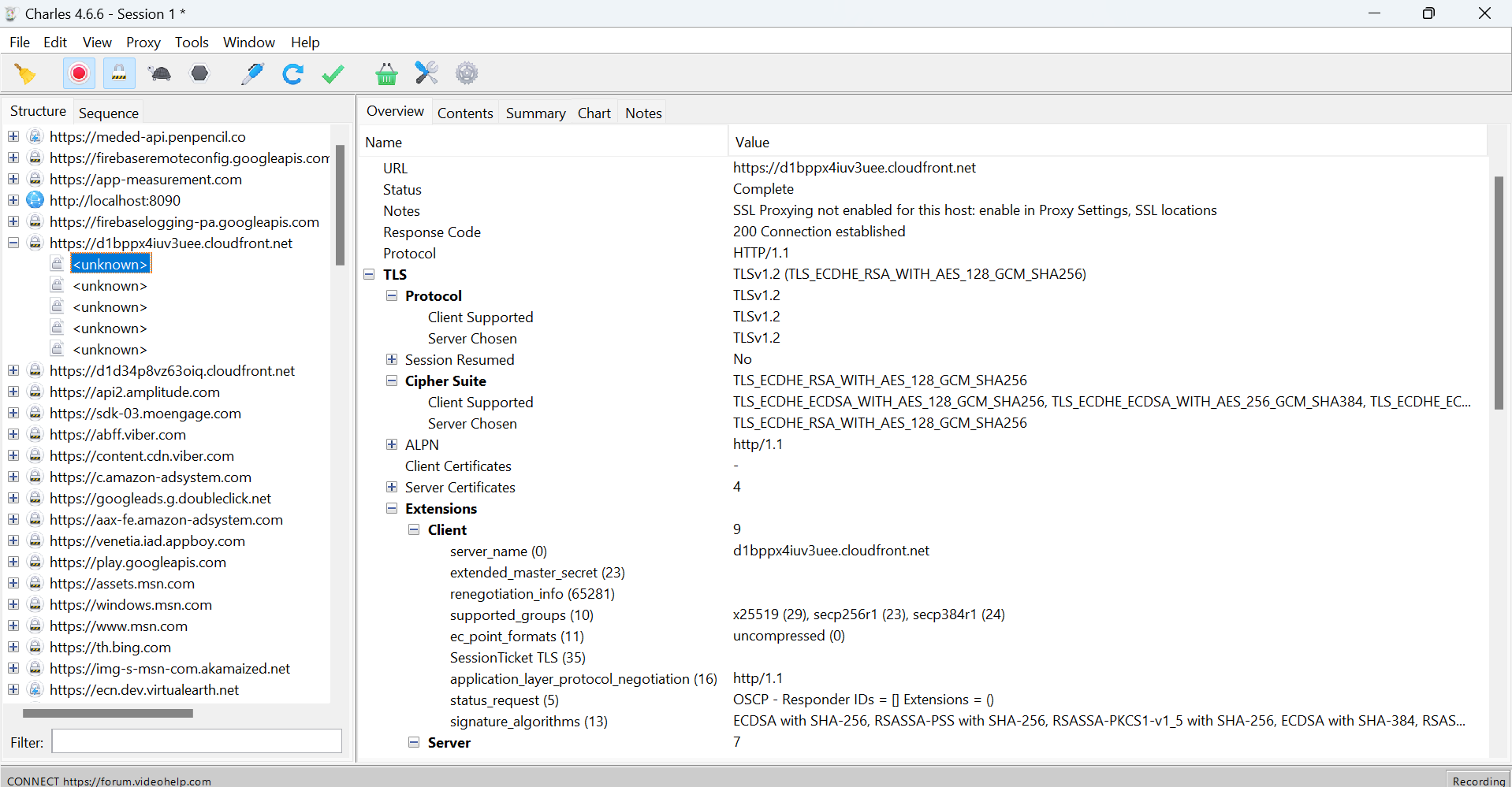

    is there any tutorial video regarding finding mpdlinks ? , I have charles proxy in my laptop and when i run the inapp video on my android, i get the cloudfront link like these ( d1bppx4iuv3uee.cloudfront.net ) but i can't find the .mpd url .PLease helpme out
    [Attachment 80037 - Click to enlarge]
    You need to activate SSL proxying, right click on the host and enable it.
