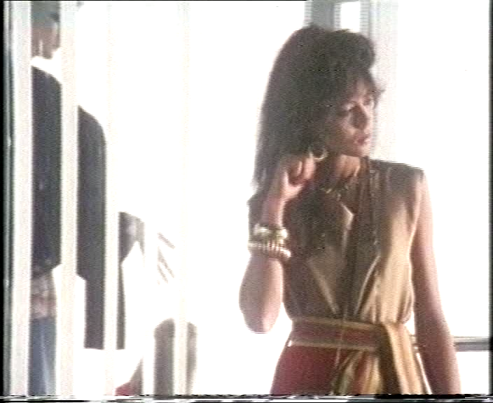

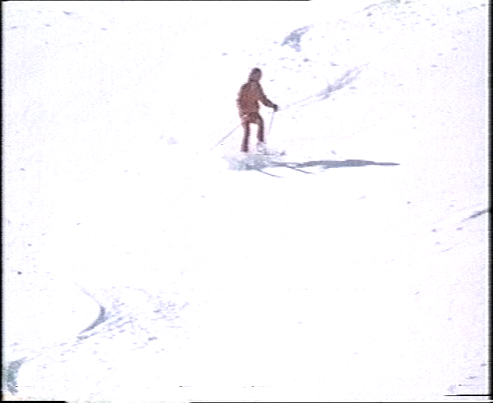

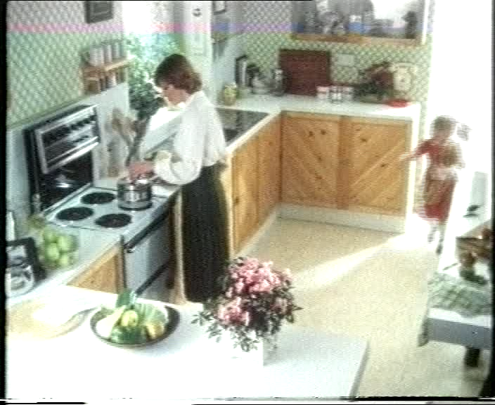

  1. I've been sent a video with badly blown highlights (not my capture, tape long gone, unfortunately), and I'm trying to fix it up the best I can, but I'm not really getting anywhere with my usual methods. I accept that a lot of detail is gone forever, but what are my best options for at the very least improving matters?
    I've attached some screenshots and a representative sample from the much longer video - what techniques would you use to get it the best it can possibly be from such an iffy source?
    [Attachment 79465 - Click to enlarge]
    [Attachment 79467 - Click to enlarge]
    [Attachment 79468 - Click to enlarge]
    Just as an added aside, what could cause the highlights to blow so badly? I'm pretty sure this is straight from a DVD recorder and hasn't been processed. The chroma looks okay, but the luma seems to have rocketed off the scale. I'm just trying to understand what went wrong in the first place.

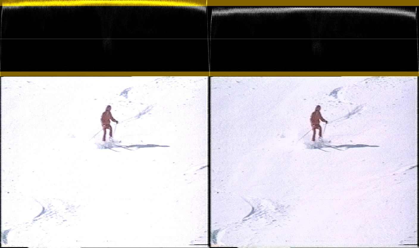

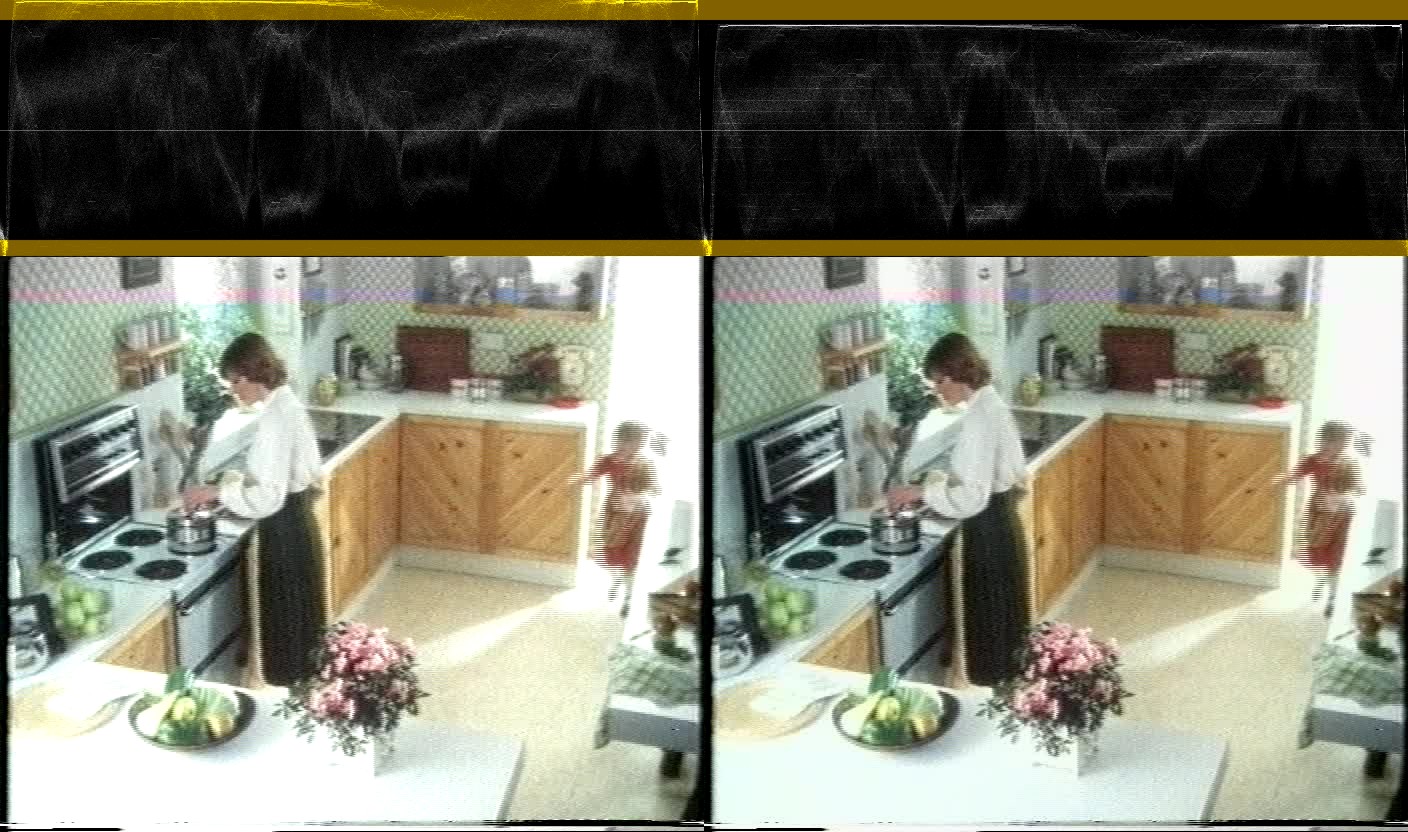

  3. You can pull a little detail out of the brights. Here I've done so with AviSynth:
    LWLibavVideoSource("sample.mpg")
    StackHorizontal(last, ColorYUV(gain_y=-20, off_y=-4))
    TurnRight().Histogram().TurnLeft()
    [Attachment 79471 - Click to enlarge]
    The snow isn't completely blown out so you get a little more detail there. But in the kitchen scene the door is completely blown out so there's still no detail there. You can see a little more detail in other bright parts of the picture. Like the plate in the lower left corner:

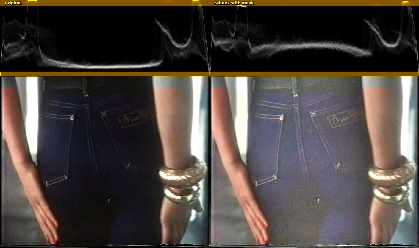

    Retinex: Can help to recover details from (underexposed) darks. From the clip in post#1:
    [Attachment 84175 - Click to enlarge]
  10. Reporting: using the 64-bit version of Retinex, along with a mask to isolate highlighted areas, I'm getting decent results. It's rendering now; I don't yet know what the very final results will be.
