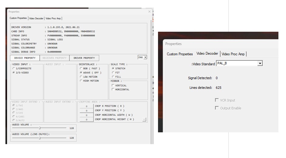

    There isnīt anything you could set up at the device directly.
    Yes there is. In OBS, right-click on the digitiser and then click on Properties. On the tabs on Properties screen, click on Configure Video. You'll have a number of tabs across the window. Check everything is set correctly: Composite/Svideo, NTSC or PAL for the input. Each digitiser is slightly different, so if you get stuck, post some screenshots. Mine looks like this:
    [Attachment 79446 - Click to enlarge]
    It sounds to me like you may not have NTSC/PAL set correctly. Try one of the PAL settings, we use PAL_B in Australia. Not sure what you Germans use.
    Don't spend money on another cheapo stick until we get this one sorted out.
