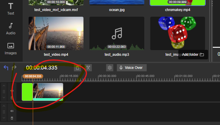

Hi there, we use it as smart rendering/smart transcoding technology in our video eiditor, that you can test online
https://freevideoeditor.online/
desktop product is here
https://www.solveigmm.com/en/products/video-editor/
So you add to a timeline your longest file, that will be copied, and the intro that well be transcode na joined to 1st file
[Attachment 79767 - Click to enlarge]Regards,
Dmitry | SolveigMM | Smart Video Editing (H624/MPEG-2/...)
