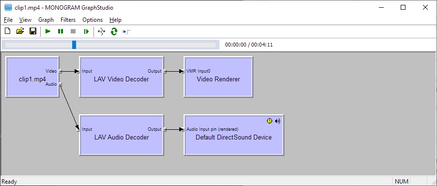

    Doesn't SE use directshow to play the audio?
    You can check you have a filter loaded, (eg. LAV filters) by using graphstudio (or similar)
    then hit the play button to make sure it plays properly
    I need some tutorial to make the LAV filters work. So far they didn't help. For now I could get Subtitle Workshop 2.52 RC to run, and from my past experience I can't trust it will run with any file.
    But Subtitle Edit still plays without audio.
