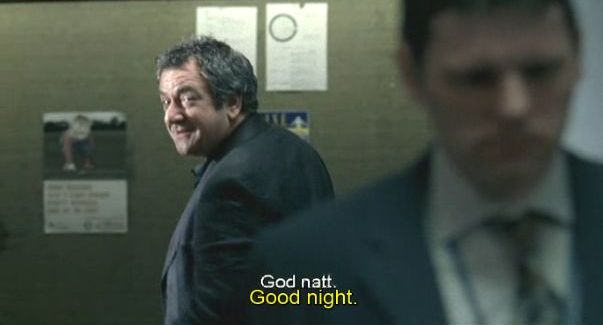

    The video has Swedish subtitles burned in (white).
    The english .srt subs (yellow).
    Been using ffmpeg delogo filter over the Swedish subs, but it is distracting.
    If I could tell the filter to use the timing from the .srt file it might be less distracting on playback - trouble I don't even know if it's possible.
    ffmpeg -i 1.avi  -vf delogo=x=199:y=295:w=269:h=54 -c:a aac -b:a 192k "%~dpn1.delogo.mkv"

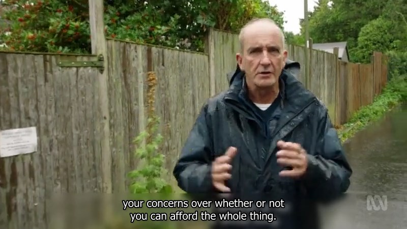

    This is for an 800x450 TV show - Hard coded subs are blurred out. An srt file is in the same folder as the final blurred video.
    Crop and overlay figures will need to be changed if the DAR of your videos differ.
    The figures in the overlay should be the same as the last 2 figures in the crop. i.e. 100:380
    ffmpeg -i "video.mp4" -filter_complex "[0:v]crop=600:80:100:380,boxblur=6[fg]; [0:v][fg]overlay=100:380[v]" -map "[v]" -map 0:1 -c:a copy -y "blurredVideo.mp4"
    Once you have the blur set how you like it then any external subtitles should be ok. boxblur=10 will blur things a lot. I find 6 is good for me as it leaves a hint of the blurred image..
    crop=600:80:100:380 = a box 600 wide, 80 high - 100 pixels in from the left, 380 pixels down from the top
    overlay=100:380 = the overlay is positioned over the box.
    It will take time to get your head around the figures.

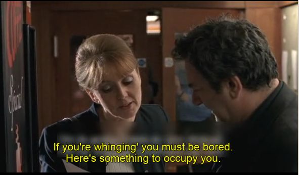

    Sorry about the late reply.
    @Ennio, the black background idea is good, except that the Swedish subs and the English subs differ in the number of characters used.So placing the English srt line over the corresponding Swedish line, doesn't cover it up.
    @pcspeak, that's a good idea too.

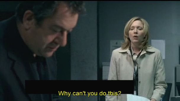

    I spent two days trying to figure out, when I used Virtualdub to place a black logo obscuring the Swedish subs, why the output audio was way out of sync.
    Turned out my source avi used packed bitstream and I used ffmpeg to fix that.
    Now the placement of the srt file over the logo is too low and I cannot figure how to move them into the black box.
    In the interim I will try your blur option.

    It's an improvement over my initial effort that's for sure.
    Now if I could move the srt file on top of the original it would be even better.
    Can't figure out how to move it.Aegisub supposedly can do it with ass files except the instructions baffle me.

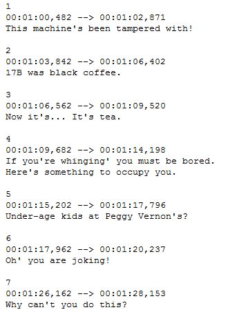

    I downloaded NoteTab Light and opened a .srt file, but I don't see those \r\n\r\n or br
    [Attachment 79418 - Click to enlarge]

    1
    00:01:00,482 --> 00:01:02,871
    This machine's been tampered with!
    2
    00:01:03,842 --> 00:01:06,402
    17B was black coffee.
    3
    00:01:06,562 --> 00:01:09,520
    Now it's... It's tea.
    4
    00:01:09,682 --> 00:01:14,198
    If you're whinging' you must be bored.
    Here's something to occupy you.

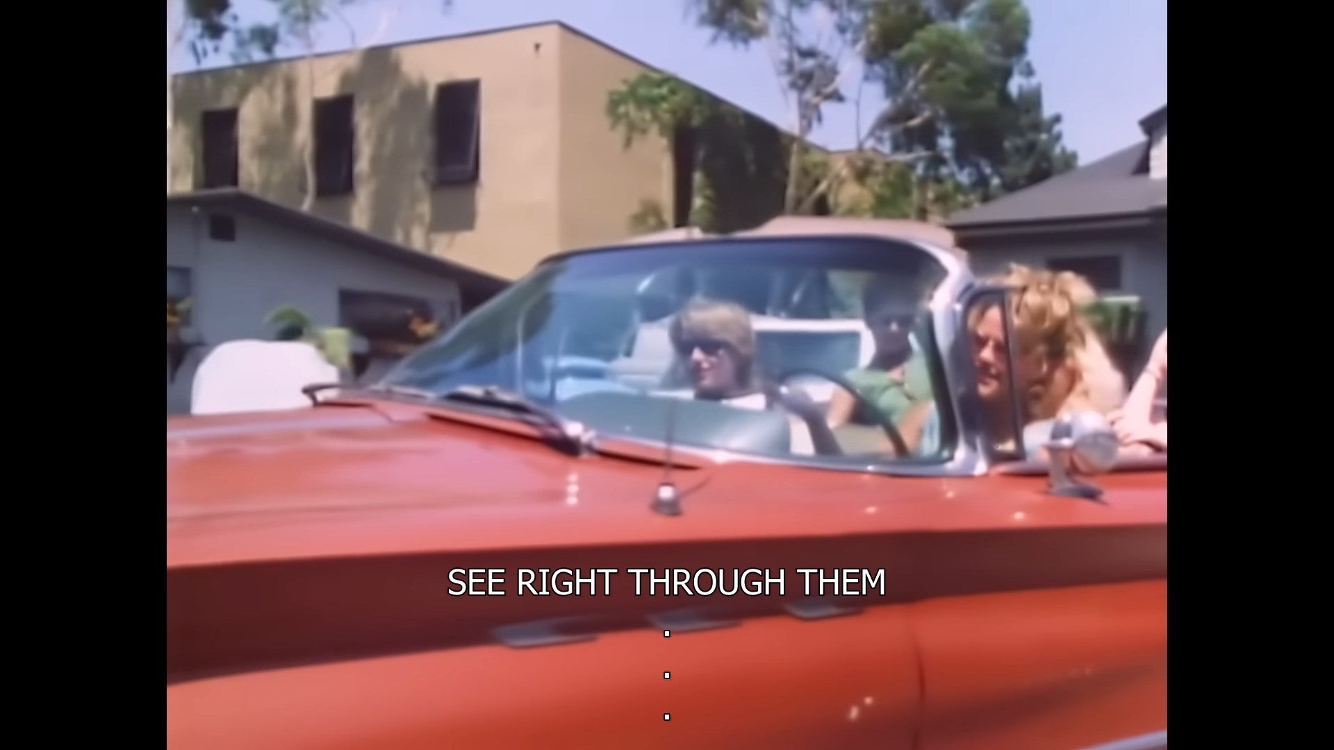

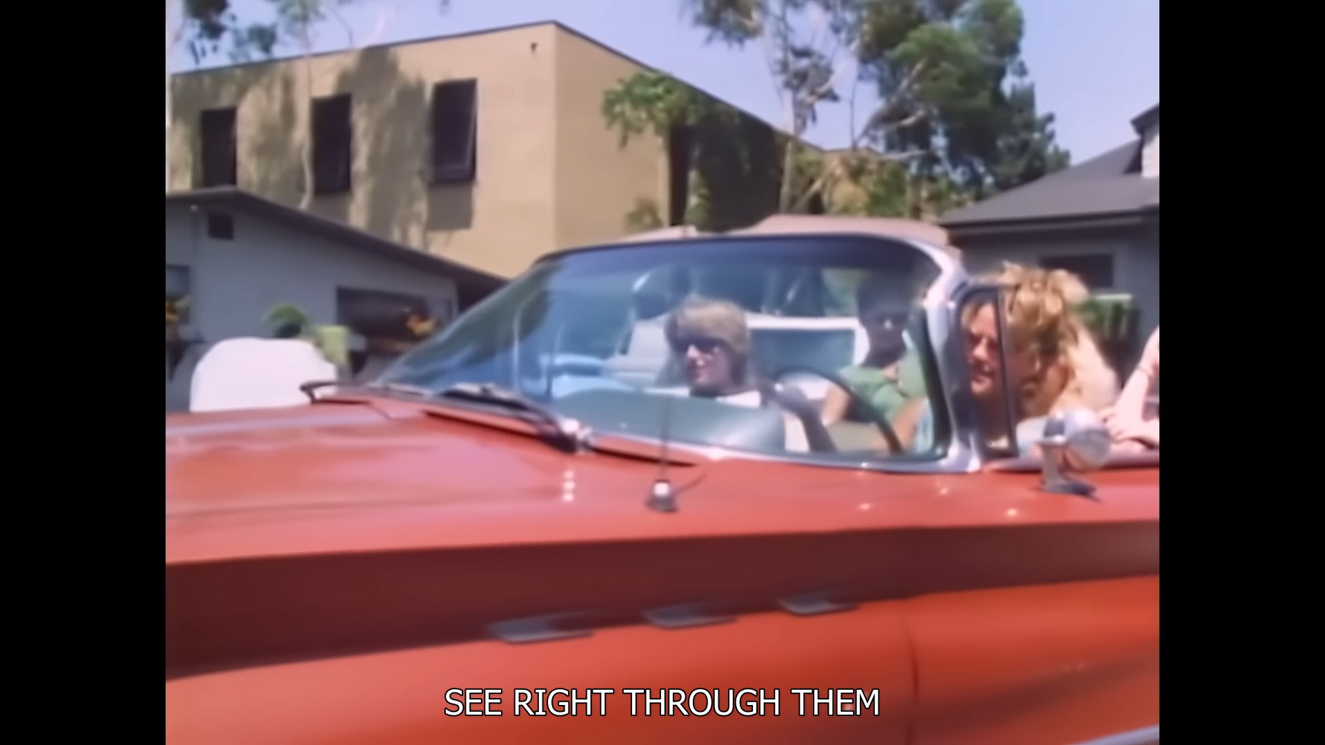

    This is the default.
    7
    00:00:27,193 --> 00:00:30,321
     SEE RIGHT THROUGH THEM
    This is my test.
    7
     SEE RIGHT THROUGH THEM<br>.<br>.<br>.<br>
    Try another player?
