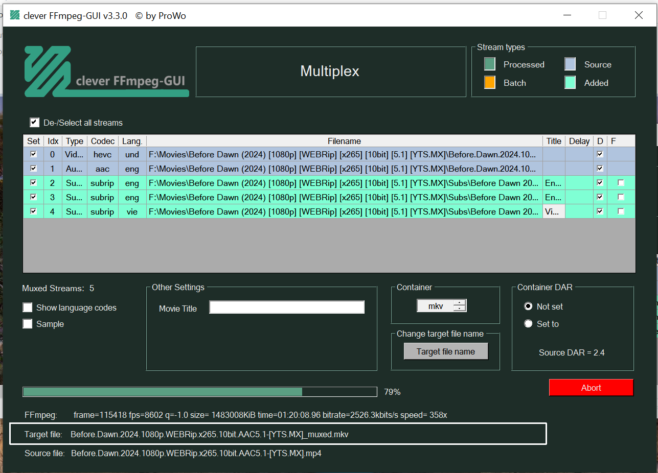

  7. Clever FFmpeg GUI version 3.3.1 & Clever FFmpeg GUI version 3.3.2 --> Target File name errors (Don't keep source file name)
    Clever FFmpeg GUI version 3.3.0 --> Target File name OK (keep source file name)
    Pls, fix it!
    Thank you!
  8. Originally Posted by onlinedragon View Post
    Pls, fix it!
    Thank you!
    You have to be a little more precise.
    Please describe the steps that lead to the problem.
  9. You can see the errors in my attached images
    1. Source file names: Before.Dawn.2024.1080p.WEBRip.x265.10bit.AAC5.1-[YTS.MX]
    Result of Target file names:
    1. version 3.3.0 [It keeps the video file name: Before.Dawn.2024.1080p.WEBRip.x265.10bit.AAC5.1-[YTS.MX]_muxed]
    2. Version 3.3.1 and version 3.3.2 [They keep the last position of added the file's name: Before Dawn 2024_Vietnamese_mux]
    Pls, fix it!
    Thank You!

  10. @ onlinedragon
    Thx for the hint.
    Will be fixed in the next beta.
