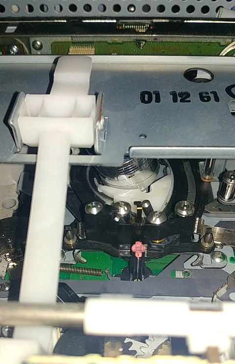

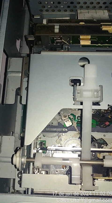

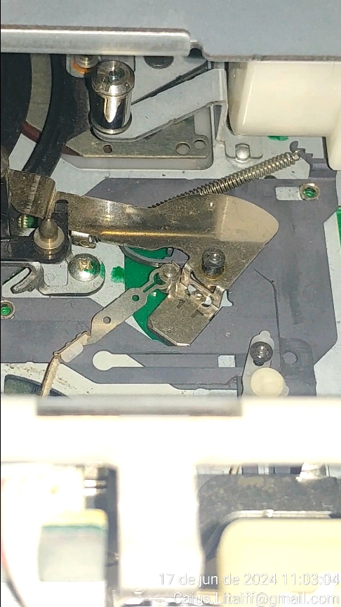

    I carried out maintenance thanks to advice from a YouTube video, the video head is now very clean, however, I tested a miniDV tape and a DVcam tape, ant it shows this error (video below).
    Dec 2022
    Brasil
    The mini dv tape got stuck inside, but after a few hours of messing around, I gave up and unplugged the device..
    Later, I turned it on again with the tape still stuck there, but something happened and a certain message appeared that it was ready to play, I pressed play and it worked without any problems.
    The same problem appeared when I tried to remove the tape, the same error message, I turned it off again, waited a while, turned it on again, and managed to eject the tape.
    It seems that the mechanism is only working like this, when everything is turned off and turned on again with the tape already inside.
    If you search that specific error C:31:70, you can find this?
    Fixya: Error codes c 31 70 of Sony DSR 45ap

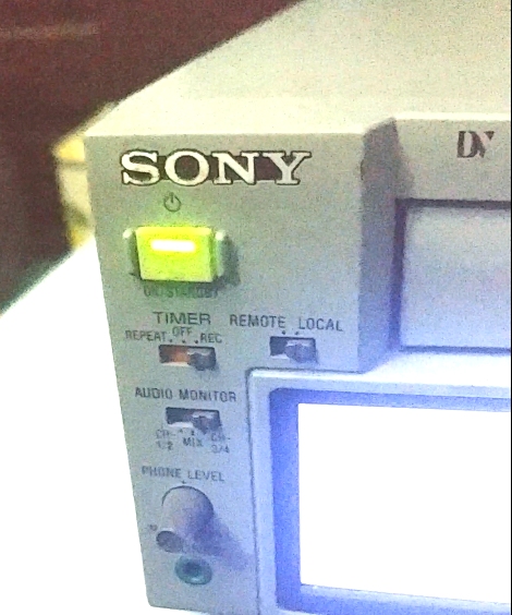

    U can do one thing check the switch at the front of DSR is in remote or not. If it is not then.
    Then press the reset switch is just below the the LCD. or Press eject button with pressing power supply .
    Oh.. I''ll do this then, later. Thanks.

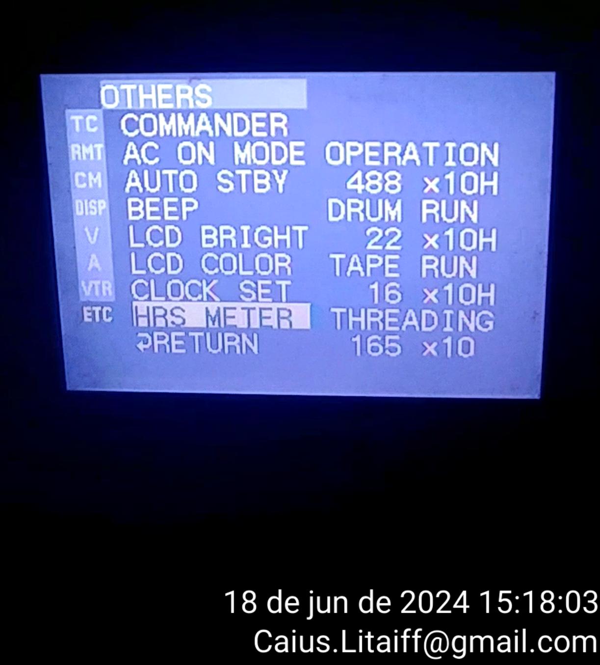

    It worked, with the reset button. I just had a little problem ejecting the DVcam tape.
    Would this information be, or would it have been informations about how long the head was used? Maybe it was erased with the reset button?
