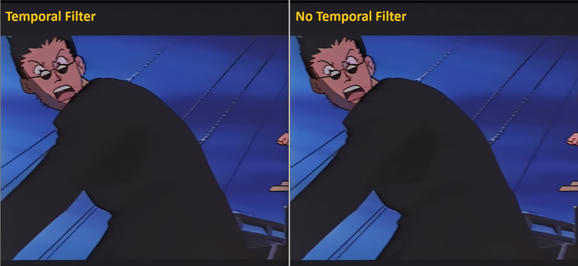

    Thank you so much! Yeah that seems to do a good job of getting rid of the flickering on the fur. I was wondering if there were any possible alternatives to temporal filtering, though? One nasty issue that I run into with any temporal filter is blurring during scenes in motion. Here's a completely unrelated scene from the same video where the temporal filtering always ends up blurring the details:
    [Attachment 79334 - Click to enlarge]
  4. Try something like
    AVISource("bear.avi")
    converttoYV16()
    MCDegrainSharp() #or tweak Temporaldegrain2(....), the flicker is mostly in the U plane
    # ... you may want to add some chroma sharpening here ...
  5. Originally Posted by Sharc View Post
    Try something like
    converttoYV16()
    This worked beautifully, thanks! I actually tried TemporalDegrain2 beforehand, and while I noticed a slight improvement, I think this does a much better job imo. It also doesn't cause as much detail loss as TD2 did (or really any detail loss, from what I can see).
