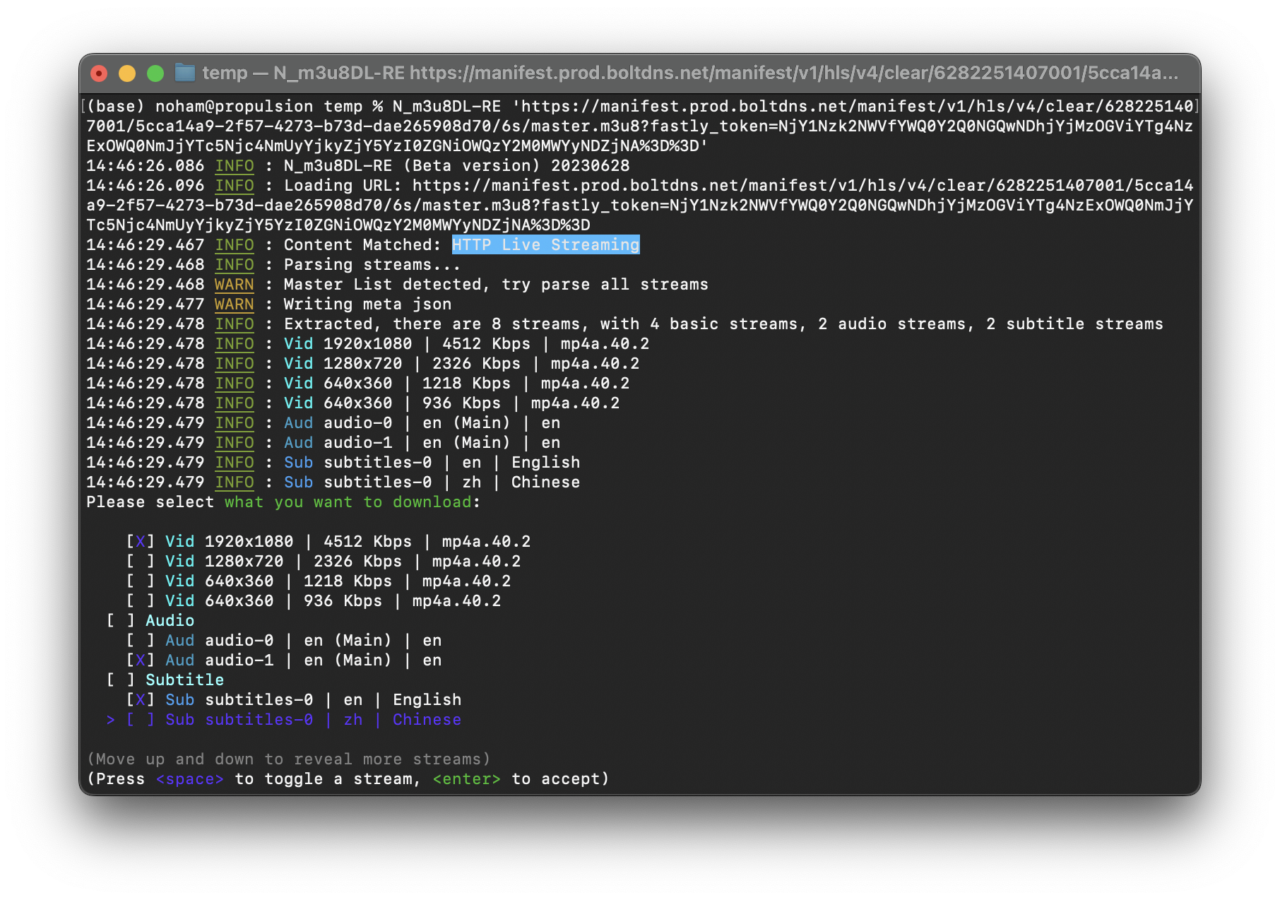

  17. Member aqzs's Avatar
    Mar 2024
    Paris
    Originally Posted by VinzOP View Post
    Hi guys, thanks for your help, I've found some .vtt in Dev Tools, and worked like a charm!
    But, I have found another problem now... I'm trying to download the following video, and successfully downloaded the video without problem.
    The thing is that the subtitles tracks are not that easy to fetch... The master.m3u8 doesn't directly contain both of the available tracks (english and chinese). So, I've found a webvtt text file in Dev Tools, but it's segmented in various parts. I'm trying to download the english version without knowing which is it using ffmpeg with some code found surfing this forum, but this has been unsuccessful so far.
    Any help for this? Thanks a lot!
    I suggest you using N_m3u8DL-RE, it handles the processing part.
    [Attachment 79436 - Click to enlarge]
    You can add parameters such as :
    --select-audio all
    Or use regular expression to download only 'en'.
    HTML Code:
    Select audio streams by regular expressions. ref --select-video
    Examples:
    # select all
    -sa all
    # select best eng audio
    -sa lang=en:for=best
    # select best 2, and language is ja or en
    -sa lang="ja|en":for=best2
    HTML Code:
    N_m3u8DL-RE "https://manifest.prod.boltdns.net/manifest/v1/hls/v4/clear/6282251407001/5cca14a9-2f57-4273-b73d-dae265908d70/6s/master.m3u8?fastly_token=TOKEN" -sv best -sa lang=en -ss lang=en

    19:14:21.601 INFO : Loading URL: https://manifest.prod.boltdns.net/manifest/v1/hls/v4/clear/6282251407001/5cca14a9-2f57-4273-b73d-dae265908d70/6s/master.m3u8?fastly_token=TOKEN
    19:14:21.667 ERROR: One or more errors occurred. (Response status code does not indicate success: 403 (Forbidden).)

    Sorry, I didn't know if the install was successful, but I figured it out now. I had to copy the original url from the master.m3u8.
    If it's interesting for someone, I've found this info that visits this challenging steps for a non expert, concerning N_m3u8DL-RE with Mac OS:
    https://github.com/nilaoda/N_m3u8DL-RE/issues/324
    Cheers.
