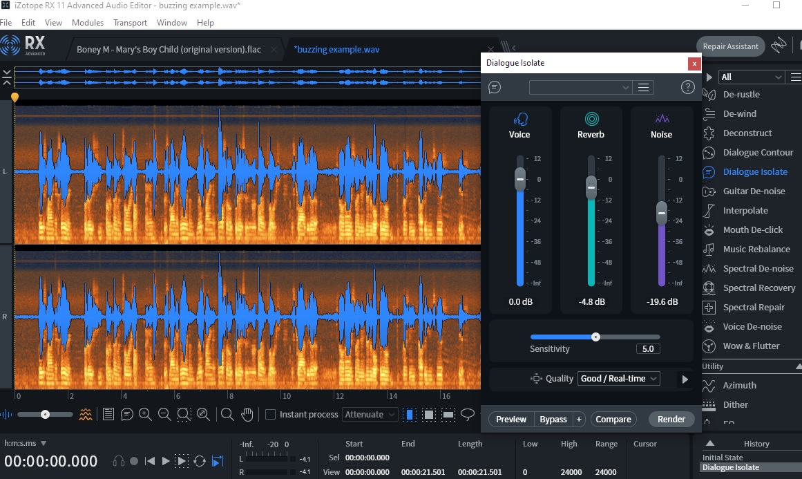

    Updated Rx 11 to a revision put out by Izotope, just two days after the initial release.
    Here's another go using the updated Dialog Isolate. Seems to be increased sound quality compared to RX10.
