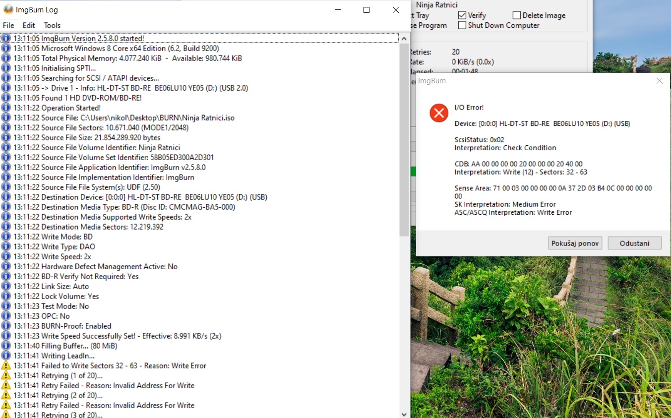

I got external burner LG BE06LU10 and I tried burning Verbatim BD-R 25 GB 6x in imgburn but I get this error:
[Attachment 79155 - Click to enlarge]
This is the first time I burn blu-rays. I got latest driver installed and i set burn speed at 2x. I tried other blank bd-rs (same Verbatim BD-R 25GB 6x) but same error. Drive reads blu-rays fine. What could be the problem?

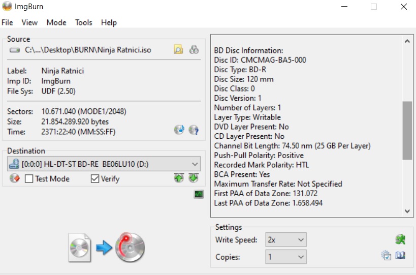

your blanks are cmcmag-ba5-000. they use cheap outdated and mostly no longer used lth dye. try some other bdr.

I look for BD Disc Information in imgburn, it says htl:
