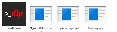

    There are a few sites where I can find .m3u8 1080p links using stream detector on Chrome and I want to download it as a video.
    STREAM SITE = https://wlext.is/series/la-dona-season-2/?server=romanticatop&episode=016 - 1080P catch steam dedector link.
    I have the ones pictured below. Is it possible to download using these?
    [Attachment 79150 - Click to enlarge]
    So, is it possible to download every .m3u8 I find with these? Or even if I find it, might it not be possible to download it with the programs I have?
    Which programs in the picture should I try to download with?
    And which code should I write for which one? I would be happy if you share it while downloading.
    Thanks.

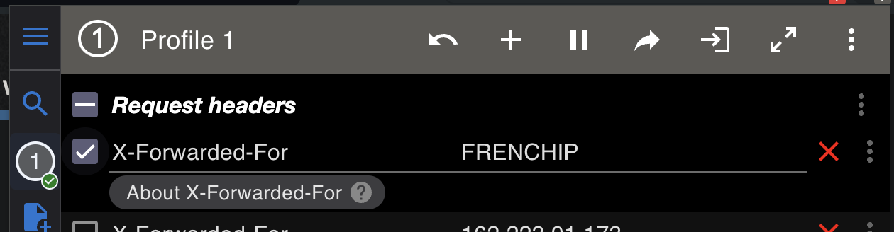

    Originally Posted by mjking View Post
    2 ) And I guess the biggest challenge? VPN? geoblock bypass? I don't have a good paid VPN and I think it probably won't download it. I installed an extension from 1clickvpn.com on Chrome, it was working on some sites, at least now I can't watch it online, unfortunately.
    Try bypassing geoblock with https://modheader.com/.
    [Attachment 79153 - Click to enlarge]
    (X-Forwarded-For)

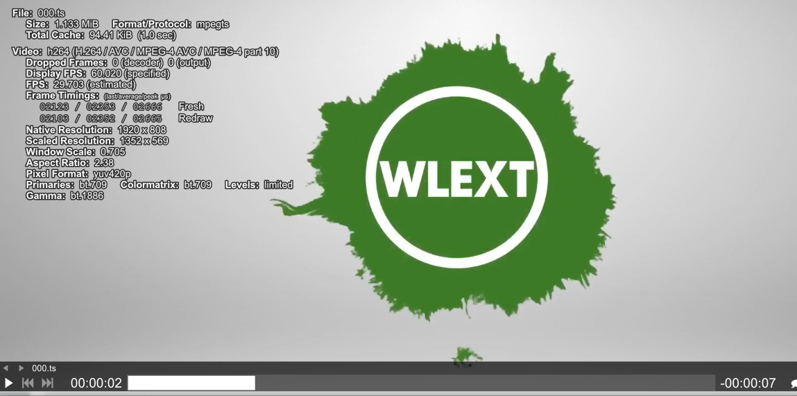

  7. use N_m3u8DL-RE and add refer only
    work with m3u8 link 1080p
    N_m3u8DL-RE "https://hls31-eu.zcdn.stream/f6205a3a636d7526c22824f8387551f0/2023-08-10/video.m3u8?auth=(cut)....." --header "Referer: https://player.romantica.top/"

  8. Originally Posted by lomero View Post
    [Attachment 79157 - Click to enlarge]
    What is the real cause of the error?
    [Attachment 79158 - Click to enlarge]
  9. my m3u8 link is cutted (due to auth for my IP)
    so, search full m3u8 link yourself, add referer like my post above and use N_m3u8DL-RE
