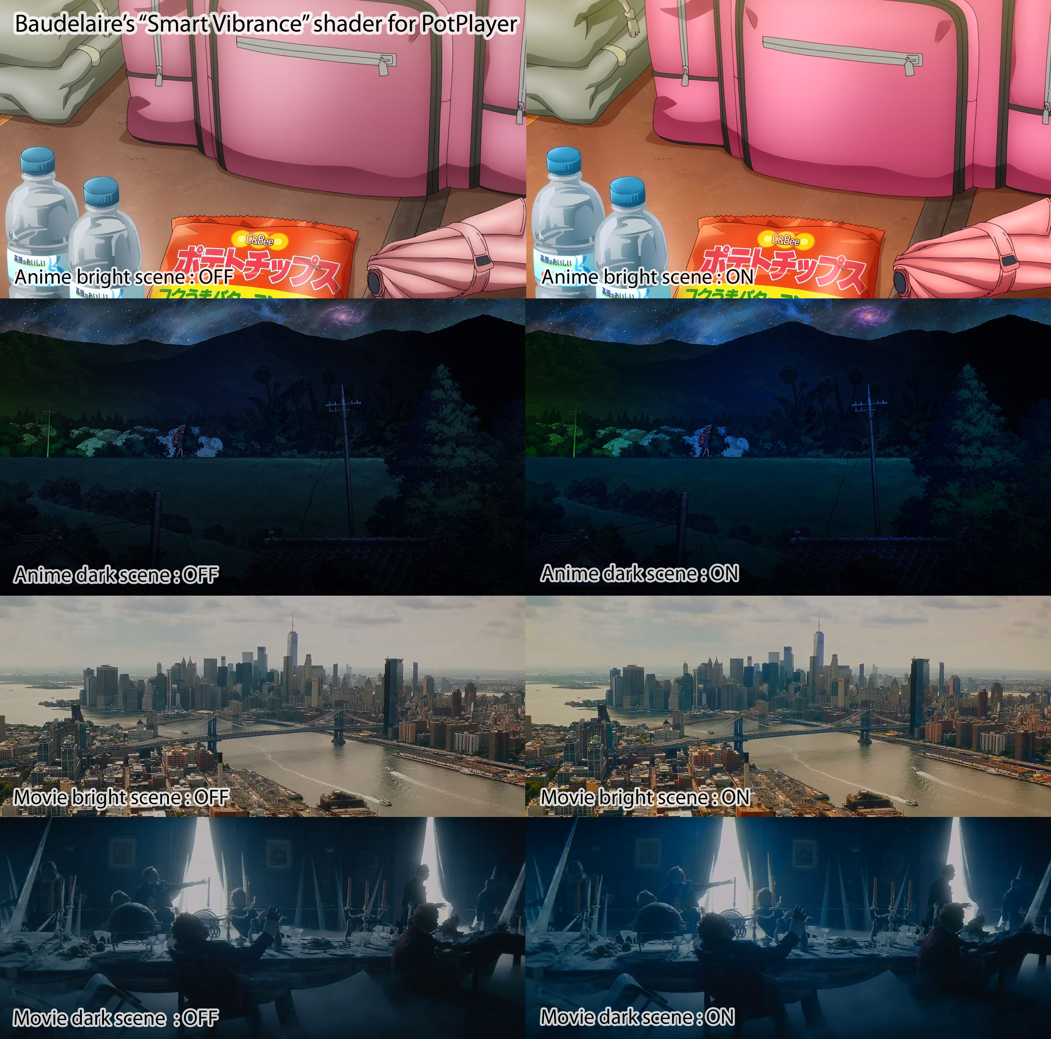

Preview :
[Attachment 79145 - Click to enlarge]

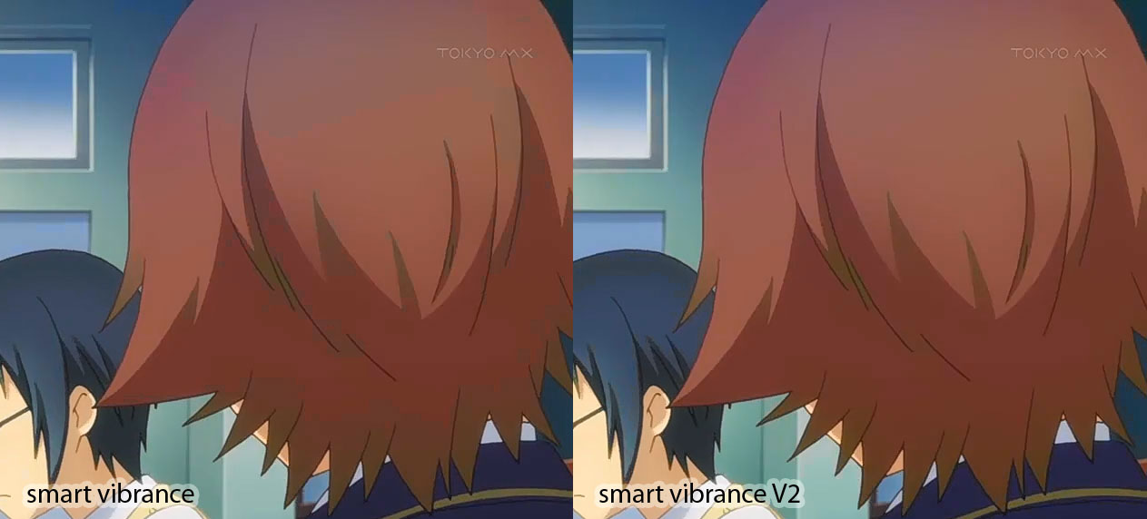

UPDATE V2 : Updated the shader, which in some circumstances generated artifacts due to the way it arbitrarily decided whether a color was a grayscale, now applies a gradual alteration of saturation for a better transition between grayscales and colors while maintaining the same amount of saturation, the shader was created and modeled targeting FullHD material but is now fully compatible even with old anime encoded in HD/SD especially if with old codecs
[Attachment 79175 - Click to enlarge]
(notice the artifacts on the left hairs)

You're welcome, i have added now a preview to comprehend better the result, but remember that if you look at that image from a smartphone, it will be probably already "pumped up" in his vividness by the default behaviour of rom/soc configurations (expecially on snapdragon)
V2 released, solved an issue wich would generate artifacts in some circumstances (hd/sd & old codecs)
