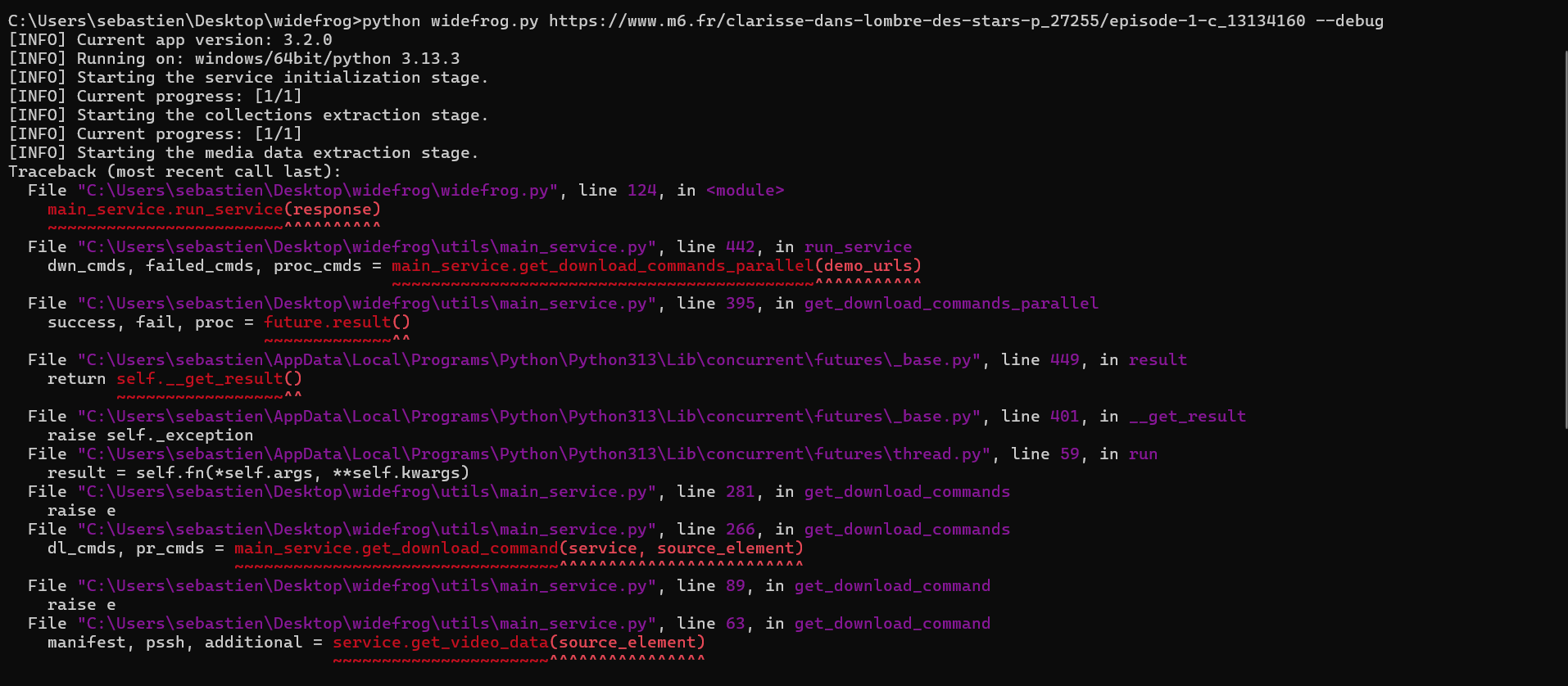

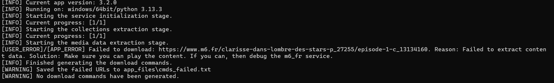

  23. I'm French, so I have a French IP address. @DarkSmile I have the correct credentials. The M6 script has been buggy for me for a long time.
    Here are the screenshots.
Name:	Capture d'écran 2025-07-25 122337.png
Name:	Capture d'écran 2025-07-25 122150.png
Name:	Capture d'écran 2025-07-25 122316.png

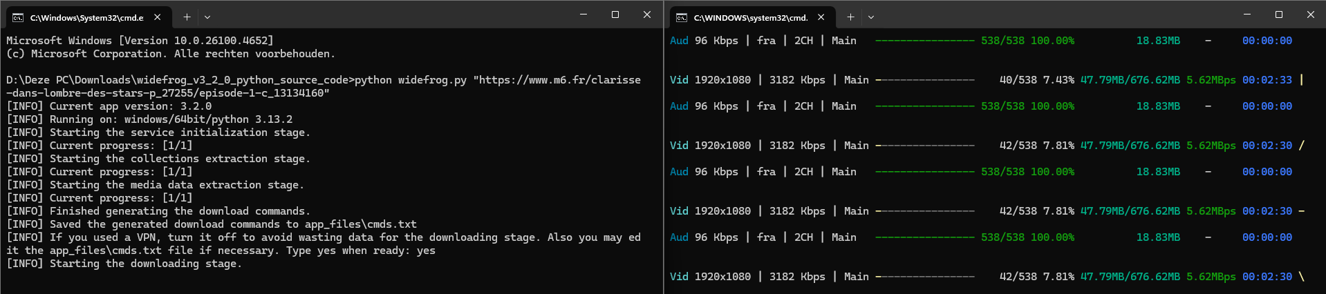

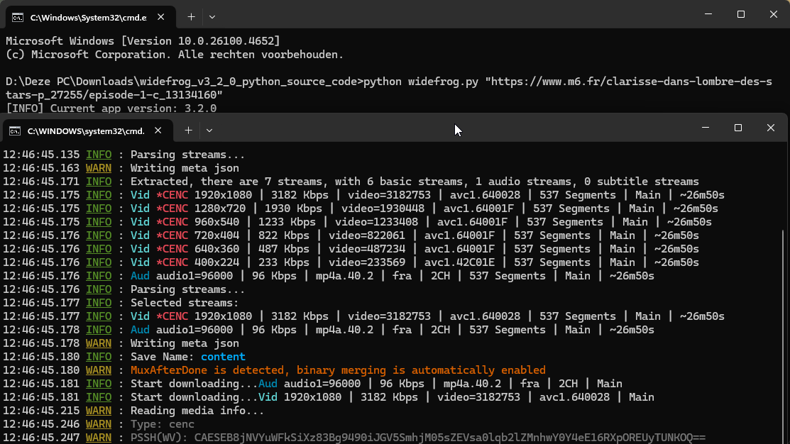

  24. I have no issues with that link. Works fine here (with vpn). Can you try
    python widefrog.py "https://www.m6.fr/clarisse-dans-lombre-des-stars-p_27255/episode-1-c_13134160" --debug
    Also are you able to play it in the browser?
    edit:
    also try:
    pip install --upgrade urllib3
    pip install --upgrade requests
    [Attachment 87950 - Click to enlarge]

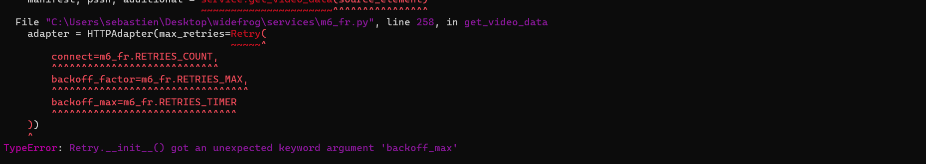

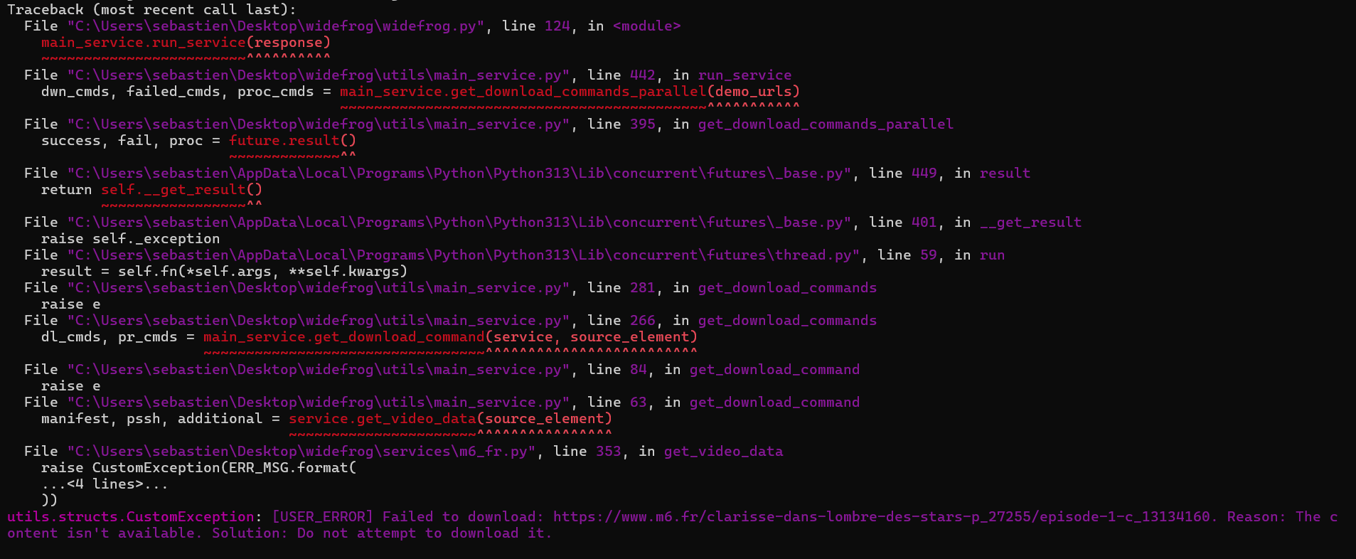

  25. Nothing works for me @DarkSmile , even though I'm French...
    I updated the two libraries mentioned.
    Debug result
    [Attachment 87995 - Click to enlarge]
